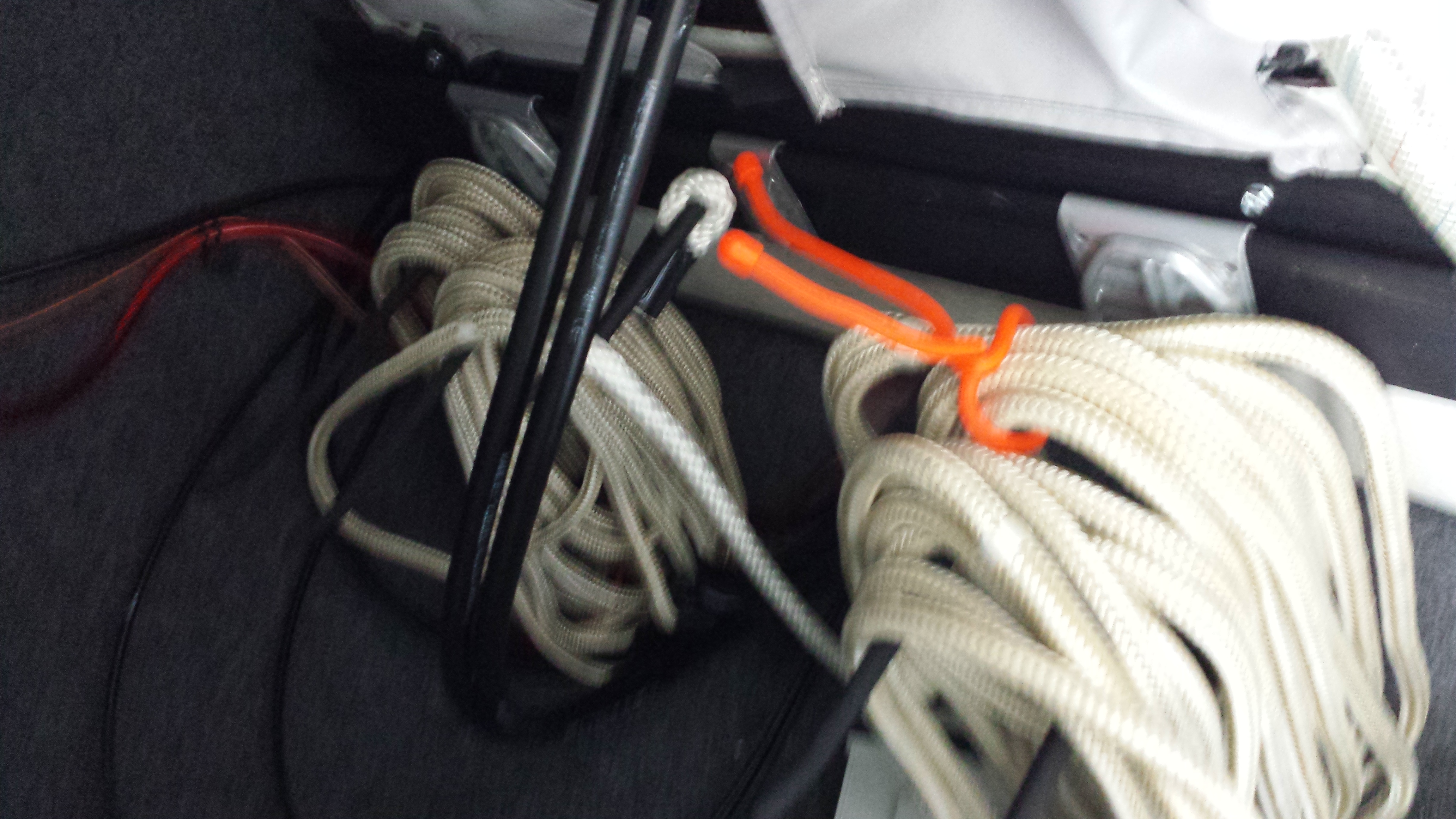

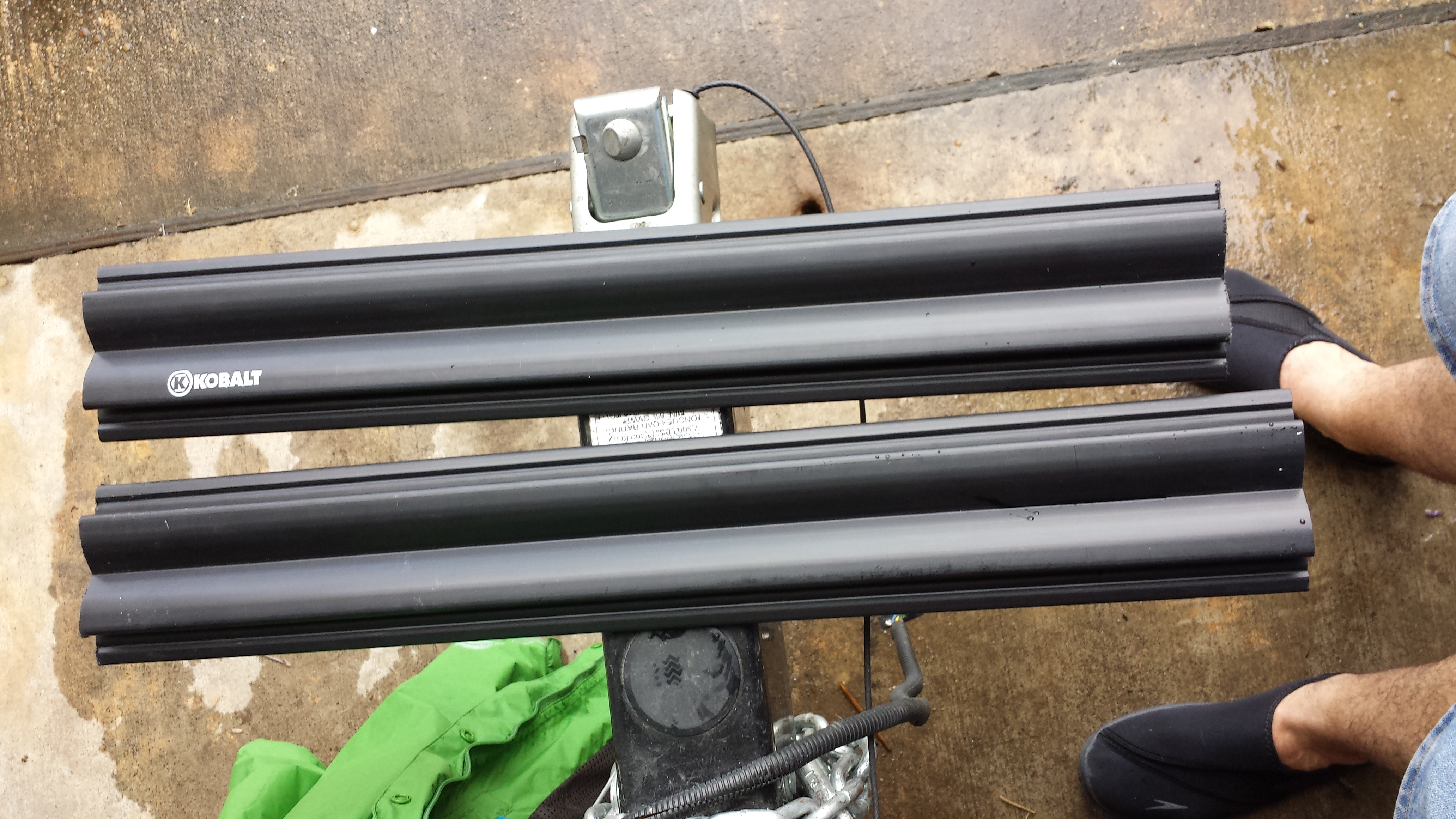

I installed my new dock line stowage today. I used the Home Depot Kobalt rail system (like you would use to organize the garage). I cut the rail in half with a hack saw.

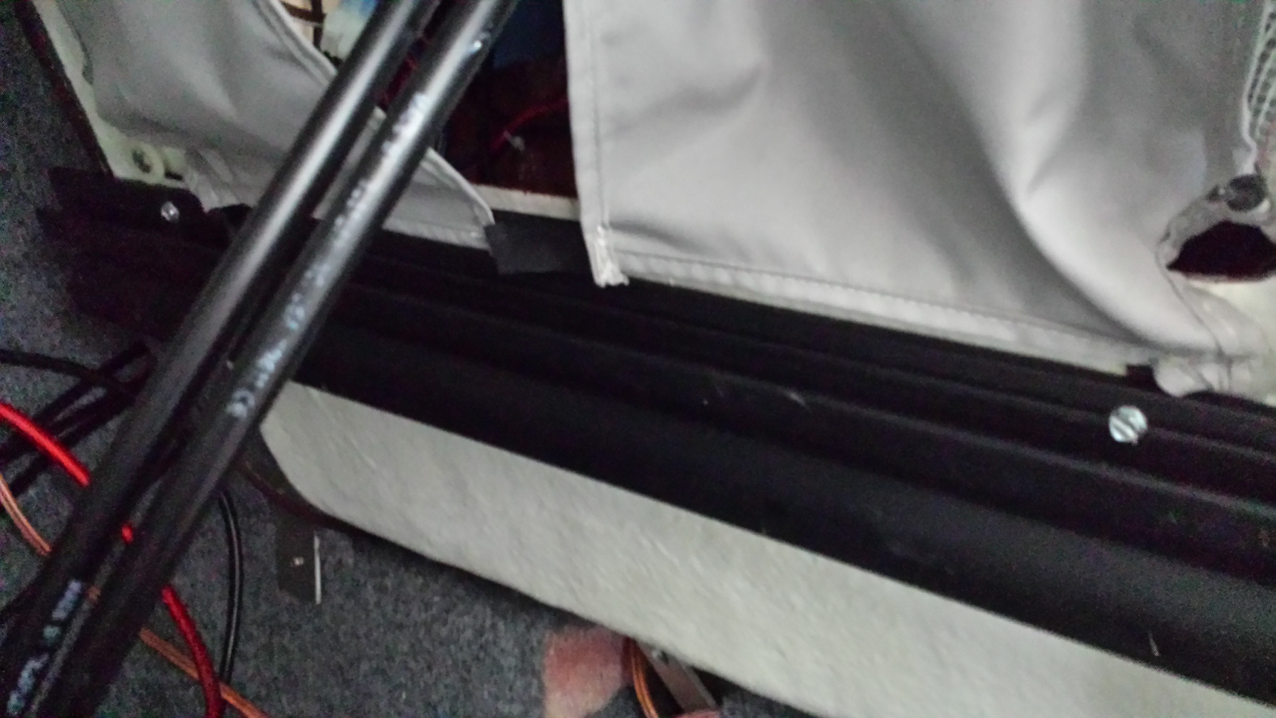

I drilled and screwed the half bar in place behind the helm. I positioned it so it does not block the access or the little circles that hold the fabric screen.
Then I installed a few hooks. The hooks can slide on the bar if you push from the bar side of the hook, but don't move if you push farther out on the hook (e.g. If the load pulls to the side). This way I can configure and reconfigure at will. Also, the hooks can be set with a screw, but I elected not to do that just now.
I took photos, so it did happen.

Really? Hmmm. I did the media thing this time as I had multiple devices involved. Guess that didn't work.
Try this:

Those pictures work. Thanks for a nice write up!
