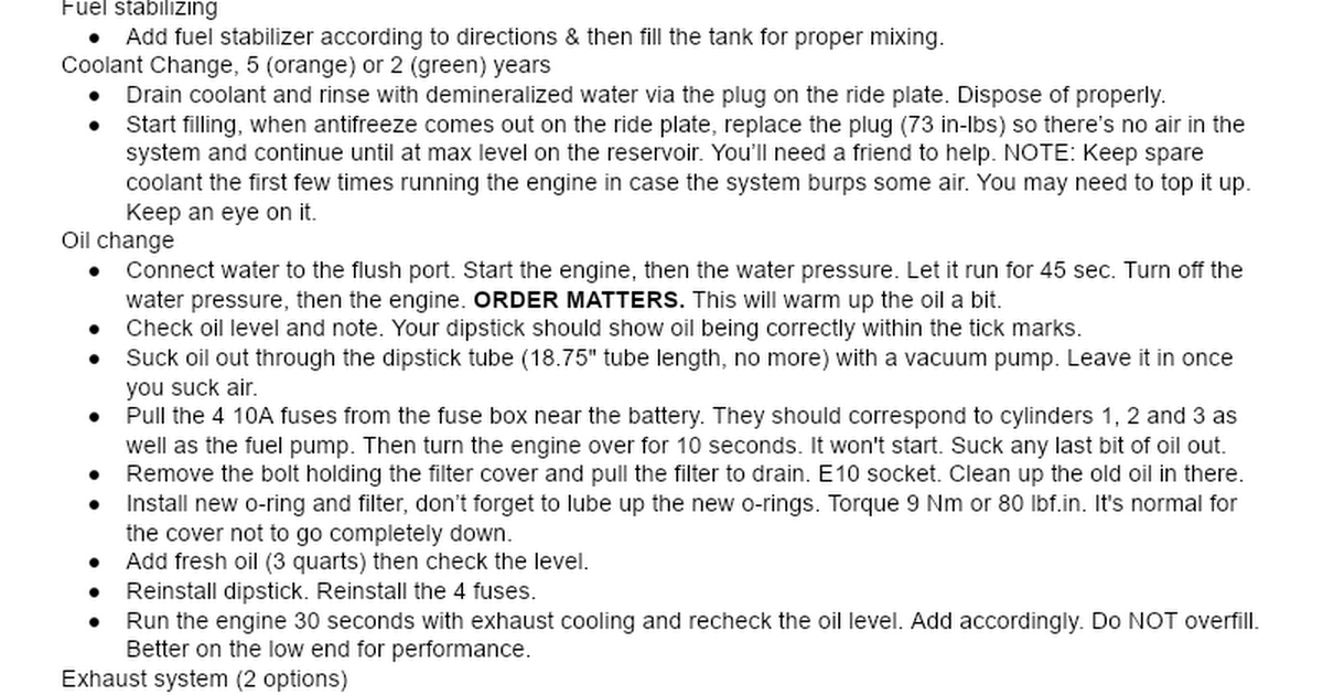

The rest should definitely be done though. I have a little winterizing procedure list I follow (made myself) every fall. Covers all the winterizing and maintenance. Nothing too hard. The only important part is the water in exhaust thing. Maybe the stabilizer in the fuel too. Otherwise, it's maintenance that you can do whenever you please.

Keep in mind this is my personal checklist of what I do each fall and MY sources where to get them. By doing this each fall, all my boat maintenance is done and the boat is ready to go in the spring.
