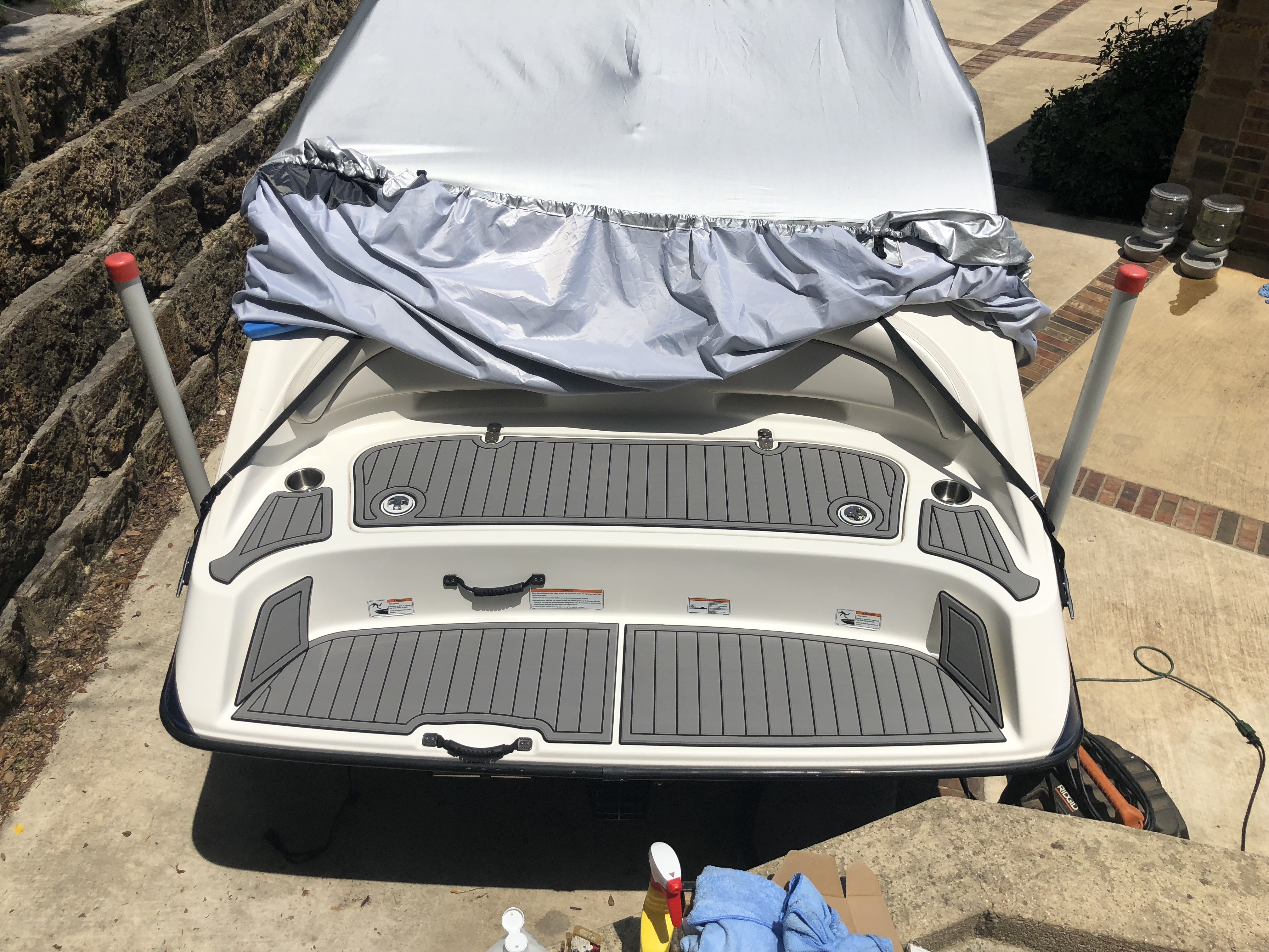

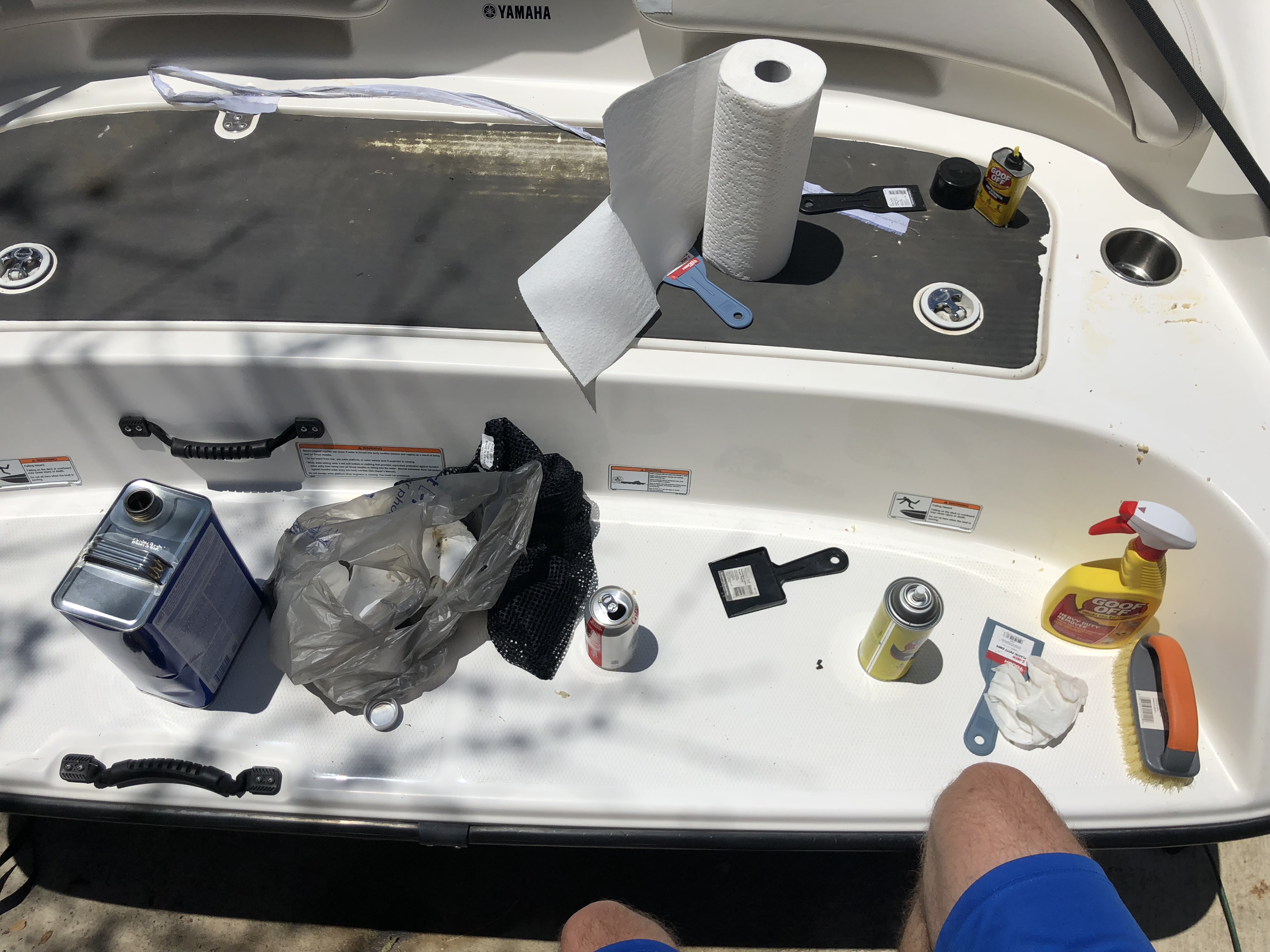

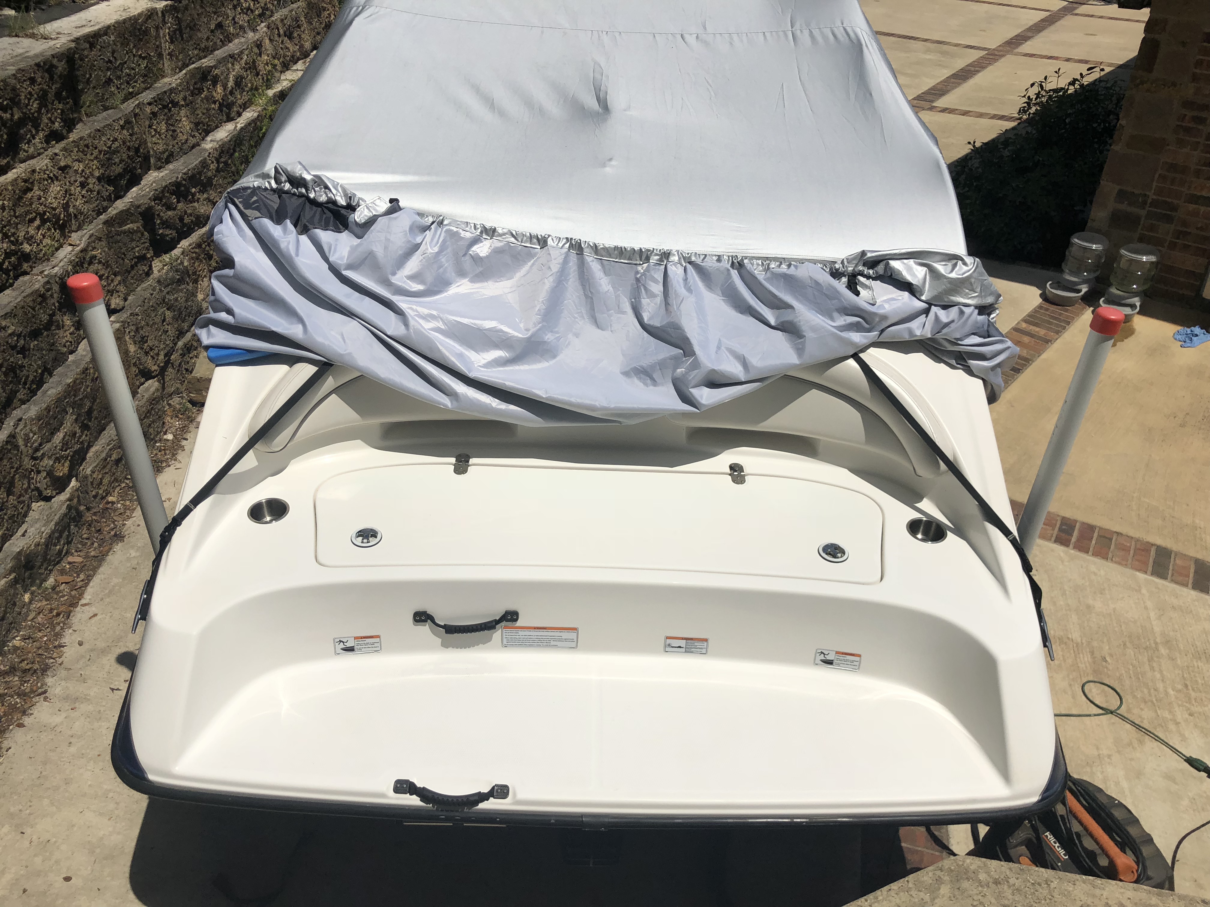

So our new to us 2013 AR 190's Hydroturf was getting thread bare and was shedding black debris all over the place. Did a bunch of research looking at JBP vs SBT Blacktip Elite mat kits, but didn't want to wait til September for the JBP group buy because our transom was in sad shape for the season. Ultimately found the best deal through Yamaha Parts House (Babbit’s). A full set of 2018 pads was about $240 (https://www.yamahapartshouse.com/oemparts/a/yam/59b6a54687a8661154940443/graphics-mats Item 13). Given how much discussion I have seen on Sea Dek vs Hydroturf vs SBT product I had not found a post on putting OEM 192/195 mats on a 190. These are Marine Mat pads comparable to Sea Dek. Removing the old Hydroturf was a bear and took the bulk of the time. instal for the mats was just as you would expect peel and stick. Check out the pics below, and I hope this helps some of you going through this decision.

I like the one-piece upper transom mat versus the two-piece seadek transom mats (which JBP told me they cannot combine).
Does anyone know how well the color on this kit matches the seadek kit? Is it basically the same material or is it more rugged to protect against ski/wakeboard fins?

Since it’s the OEM kit it will match JBP kits. Per the JBP website, “Smoke Gray Over Black is OEM Color Match for 2017 & Newer 195 Models. Storm Gray Over Black is OEM Color Match for 2015-2016 192/195 Models.” since I got the 2018 set, the smoke gray set should match. I plan on doing the JBP group buy this fall. Feels just like the Sea Dek samples I felt in the dealership. Hopefully I can keep our 70lb Shepherd mix from tearing it Up.

The kit from JBP is an exact match to the color and finish of the OEM kit.

Coffeecan, how well does it stick to the lower step? It looks like it would have issues sticking with the rough surface.

Sticks just fine. The 192/5’s have the same non skid underneath.
