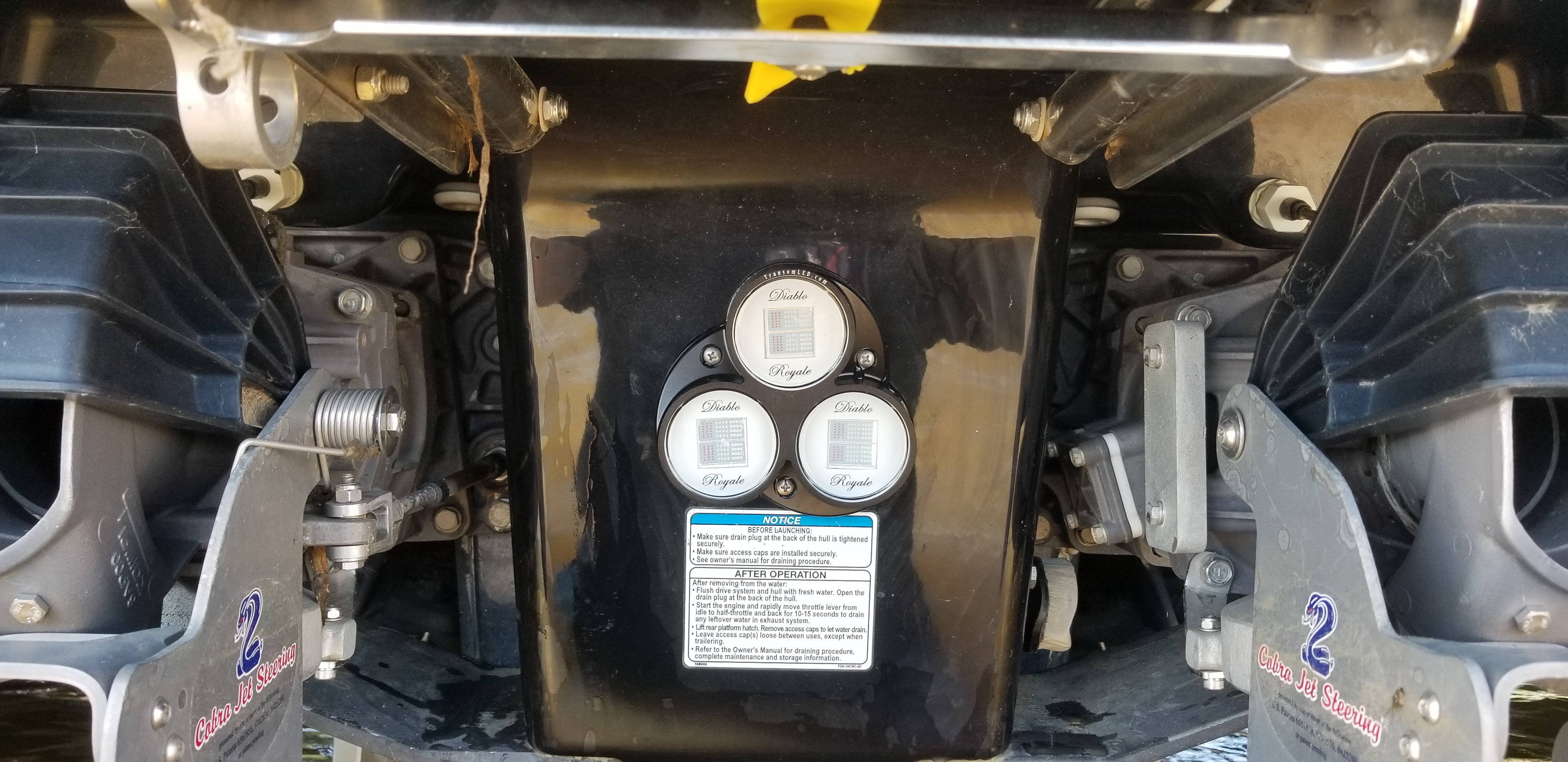

Any concerns with installing trinity light here?

This has me considering going with a transom light.
Initial thoughts were going with 2 on the outside of each jet. (green) in pic. My concern is there may be a slight curve in hull. After searching around on here it seems that the trinity may be sufficient. Though I have a 2006 I seem most folks mount in the red area in the pic. Has anyone with similar model mounted a transom light here? Any notable concerns?

I think you should be fine there. I have a 2013 212x, and I added additional ballast intakes, so I had to dodge intake hoses in that area, but you shouldn't have anything to worry about. I made a template out of cardboard, so I could locate and drill one small hole for each wire, no bigger than it had to be. I coated the back of the light with 4200, fed the wires through, and once it was flush, added the three mounting screws, coated with 4200. Mine has not leaked at all, and the light is very bright. I've been pleased.

I have transom lights in the green locations. There is a very slight curve, but its a non-issue. You should be betting those lights in 4200 anyway, which will take up any of the slight contour. I had gone down the route of
'machining' starboard backers that would be shaped to the hull, but it ended up being a non-issue. If you go outboard from those locations the curve is a bit more significant.

I will be installing my trinity light in location indicated by red marker today... Seems like the most logical location. How is yours making out?

Just remember that most of these lights are not to be used while on plane as they get hot and need the water to cool them.
