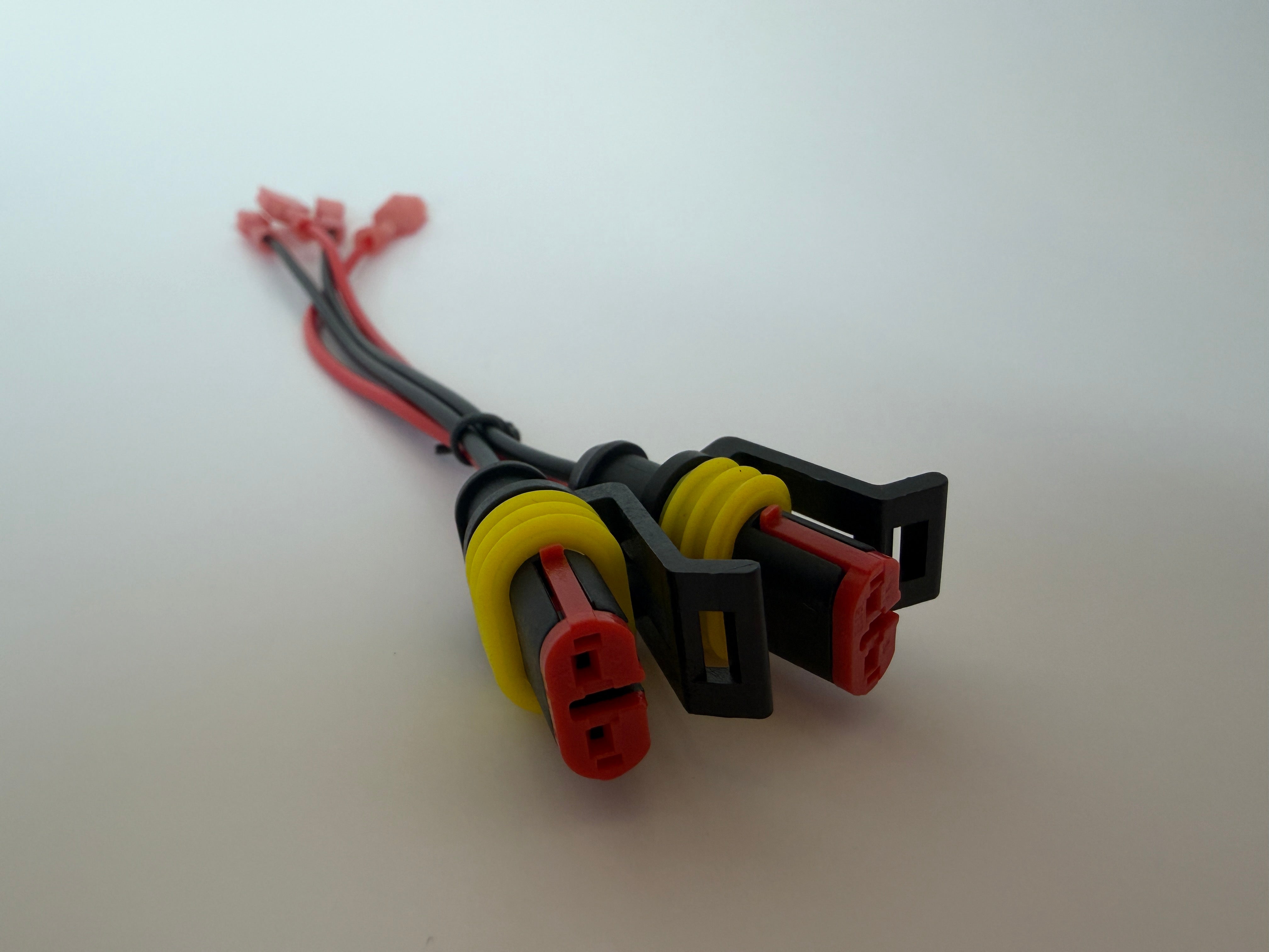

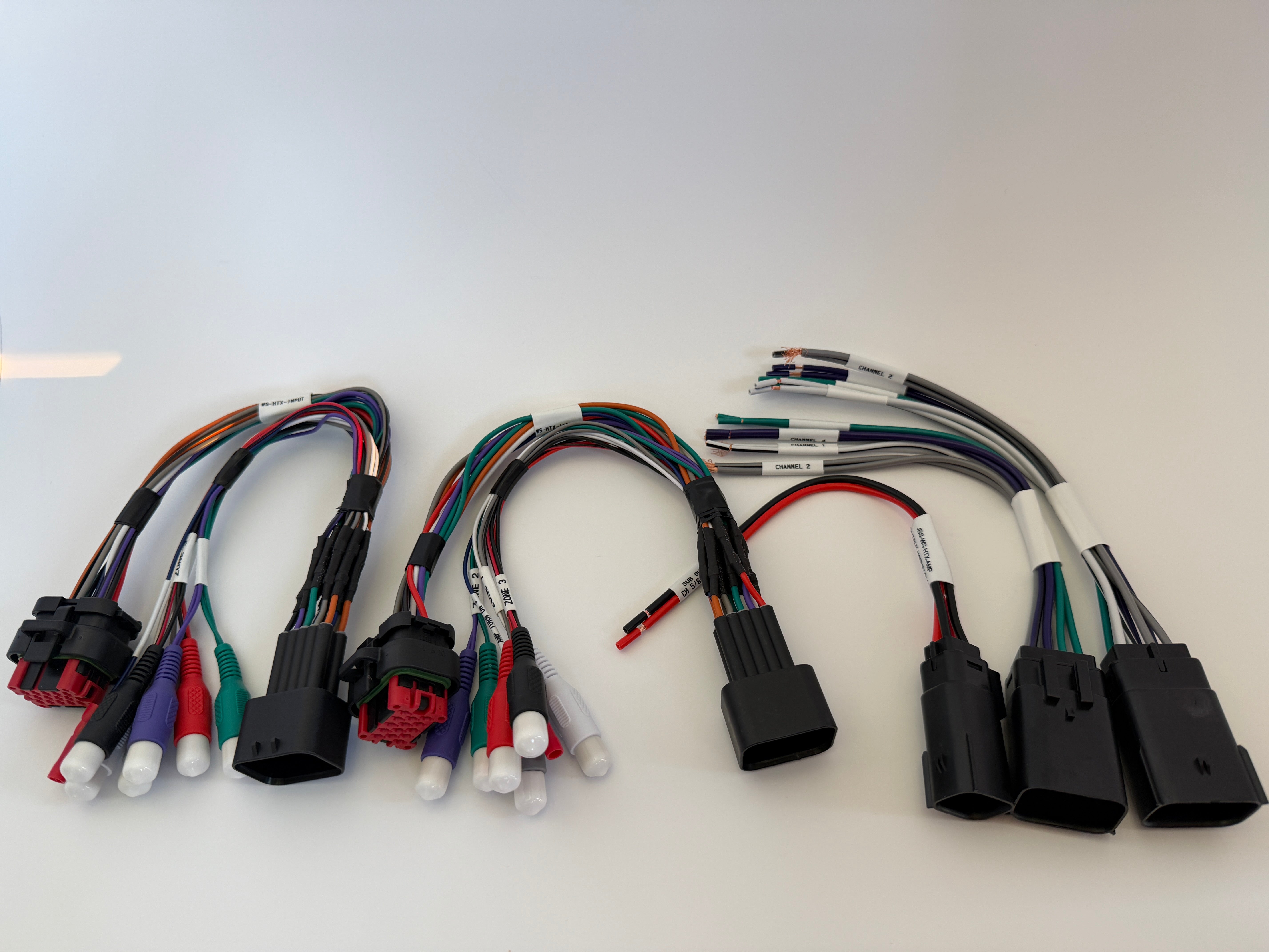

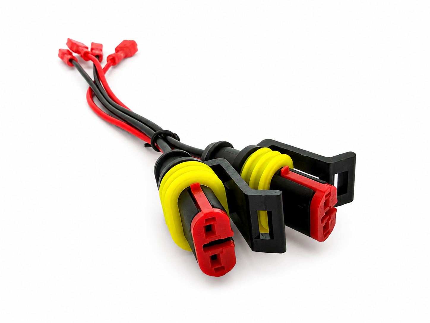

You will get varying opinions on this, but personally I would not run new wiring unless running wiring already for LED speakers. Even then 12 gauge is significant overkill. If you go this route I’d use something like this.
https://www.crutchfield.com/p_007MRGBS50/Crutchfield-CMRGBS50.html
Two things to keep in mind - Wetsounds rates their amps at 14.4v so realistically you will be running them most of the time with engine off and at 12.4ish volts, which is a significant decrease in the rated power. The second is music being dynamic, and unless being on max volume on a sine wave, you rarely ever running the full wattage thru the wire.
We have a few customers running the SDX with our full amp kit and speaker harnesses, utilizing all factory wiring and plugs and we have not heard of any issues.

@Adrian @ JB Solutions Thank you very much for the help, I really appreciate it. I purchased the harnesses from your site a few months back but am just now getting around to the install.
Originally, I was planning to run RGB to all of the speakers since I was already considering replacing the speaker wire, but with your advice I'm not sure I'll bother.
Apologies for another question, I’ve seen AI recommendations stating that ½-inch Starboard should be used to mount the amps rather than mounting them directly to the helm. I started buying the supplies......However, I noticed in your photos that the amps appear to be mounted directly.
Am I correct in assuming that mounting Starboard/Amp Rack first is overkill in this application?
Thanks again for all the guidance, this is my first boat install.
Thank you for the purchase!
That OEM area can go with out the starboard if using the OEM mounting points or if using spacers to account for the unlevelness of the area.
If you have it already, I personally would use it and run the wires behind the starboard for a nice clean looking install, of course this will add a bit of time to your install.
