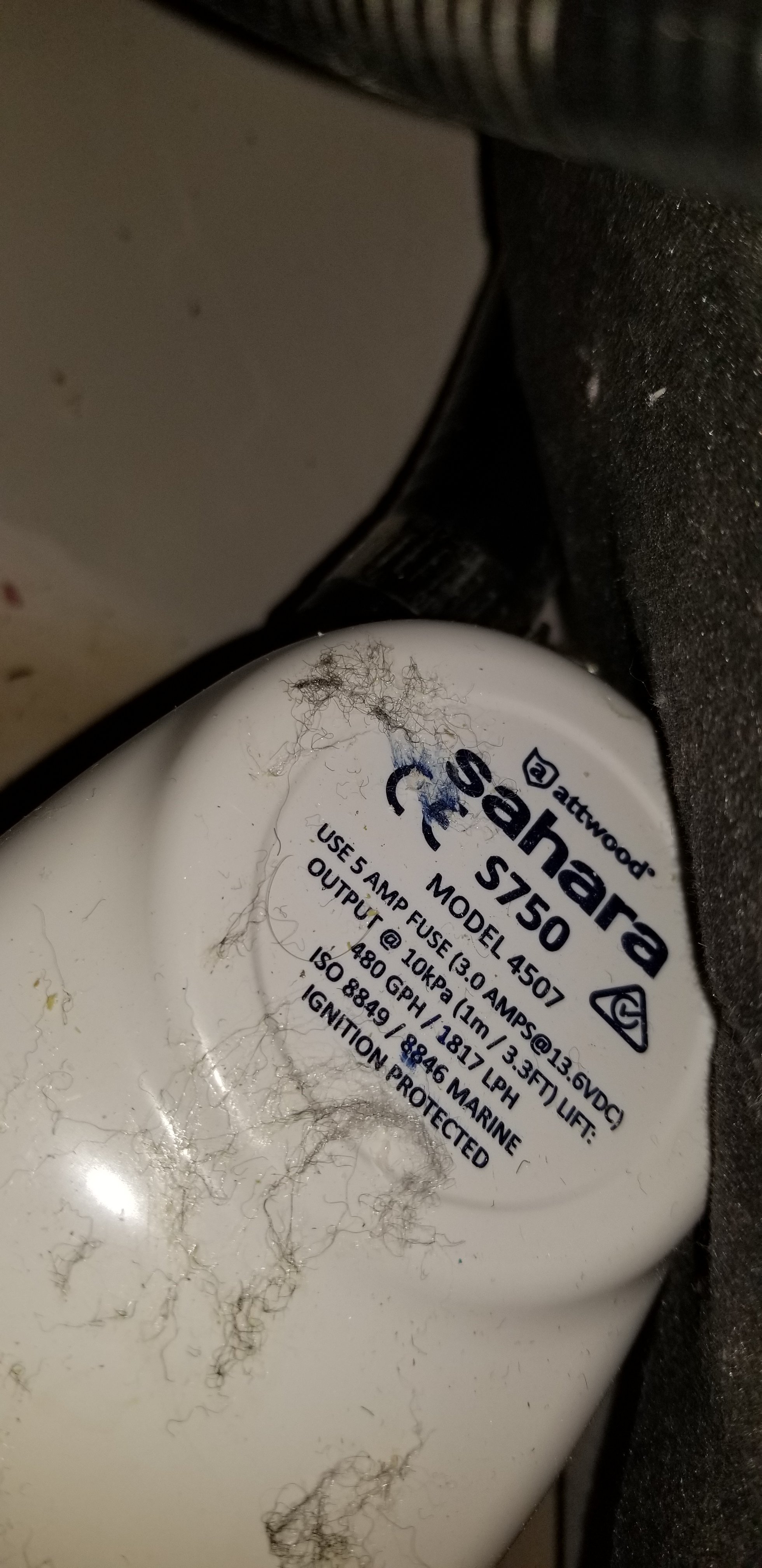

Had the same issue this year. Mine turned out to be the gasket on the float switch failed and filled the contact with water.

@DuaneP what type of pump do you have? You have a contact float? Not this pump? 1601078229624.png

Although, I see that the 2017 could also have one frome Rule with a float switch:
