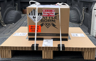

One of my four bb batteries internal heating stopped working so it is heading back for a warranty repair. The battery still functioned normally, it just would not let me charge it when it was 23*. I warmed it up with an electric battery blanket and it charged up fine and still worked normally as far as discharging went.
The shipping cost was $331, which I paid upfront, bb sent me all of the shipping stuff with explicit instructions on how to apply the stickers, how to tie it down with the included straps, bill of laiden sheets, contact information of the local shipping outfit. The shipping outfit contacted me before the shipping materiel even got to me door, I arranged to go and drop it off at their location as it was easier for me and them.
Those stickers and shipping labels are on all sides of the mini pallet as well as on top of the battery box itself. That is how these have to be shipped by an individual.
If the battery is deemed to be a warranty issue then the $331 will be refunded to me, the battery either repaired or a new one sent to me with no further charges.
If the battery is deemed to not be a warranty issue then it will cost me $150 to have it repaired, which will suck but I will let everyone know either way. Then it will be shipped back to me with no further charges.

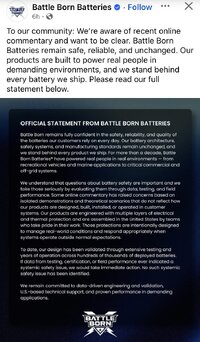

It's about time BB addressed this to the public but they should have released something sooner.
The following info is my opinion. As we all know, opinions are like @ssholes - we all have one and this is mine.
I think the video that shows the loose lug in reply #130 and the the follow-up video by the dopes in reply #136 and #143 are hit pieces.
The battery that's shown in the video in reply #130 was sent to him by some random channel follower with no context on how the battery was used or abused. The guy had previously visited BB, got a tour of their facility, and gave a favorable review. In the comments below the video someone asked if he had reached out to BB and he said no, he was too busy. I would think that you'd want to give the company whom you had previously visited a chance to respond before publishing a video attacking their product - especially when you have no idea what the random channel follower that sent you battery did to it?
The video in reply #136 is regurgitated info with the only purpose being to sell some other manufacturers battery - it's blatant and a complete waste of time.
The video in reply #143 is just plain stupid. "I bought six BB batteries at $800 a pop and had problems with four of them. Paying to ship them back (they're considered hazardous materials, doofus!!) to be examined was deemed excessive so I just threw them away and bought these other cheap Chinese batteries". If those were my batteries, and I didn't abuse them, I'd feel very confident that if I sent it back the shipping and any repair costs would be covered under warranty. IF I abused the batteries (usage/setup) I wouldn't return the batteries because I know I'd be out of the shipping costs so I'd take that money and spend it on some cheap Chinese battery to replace them with.
In full disclosure, I have a BB 100Ah battery that was purchased 2024 and have used it for two seasons - no problems so far. I called BB twice - once before I purchased and once with a complaint and the calls were answered right away by professional English speaking people that provided all the info that I asked for. The complaint was minor - the battery does not come with a handle which is optional - pretty silly for an $800 battery and they offered to send one at no charge.
I think it's a shame that the reputation of an American company with a quality product is being dragged through the mud by people just trying to increase their YouTube views to make money.

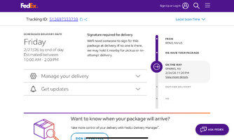

I’ve also received the initial shipping information from FedEx.

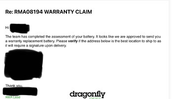

"It looks like we are approved" seems like a silly way to reply to a customer about a warranty claim?
It is an interesting turn of phrase…but I can see the intent.
