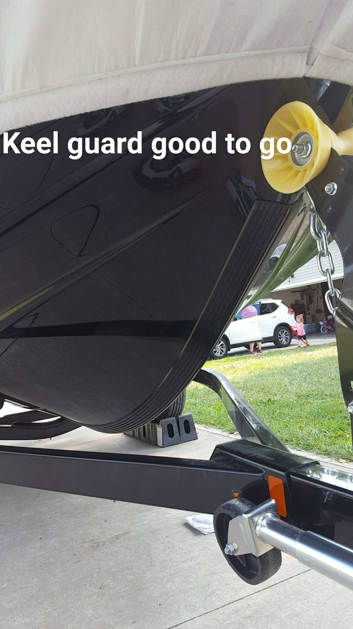

I just installed the keelshield this weekend on my AR195. I got a special amazon warehouse deal on a 12foot model and though its way longer than needed, it was only $135 on sale. There not kidding, once it sticks - THATS IT, its on (assuming you did correct prep). Took about 2hours, just me. I used lots of tape to temp hold while I used a white crayon to mark it where I would scuff.
Mine starts at the bow eyelet, ends about 3 ft from the intake grate.
Pic
