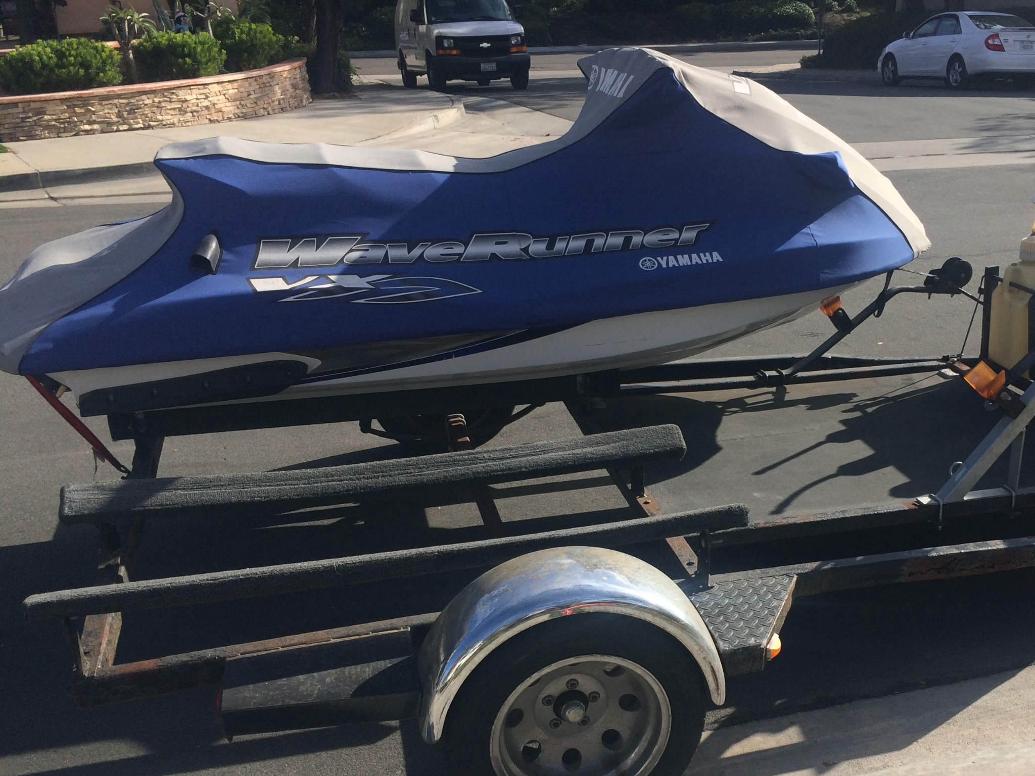

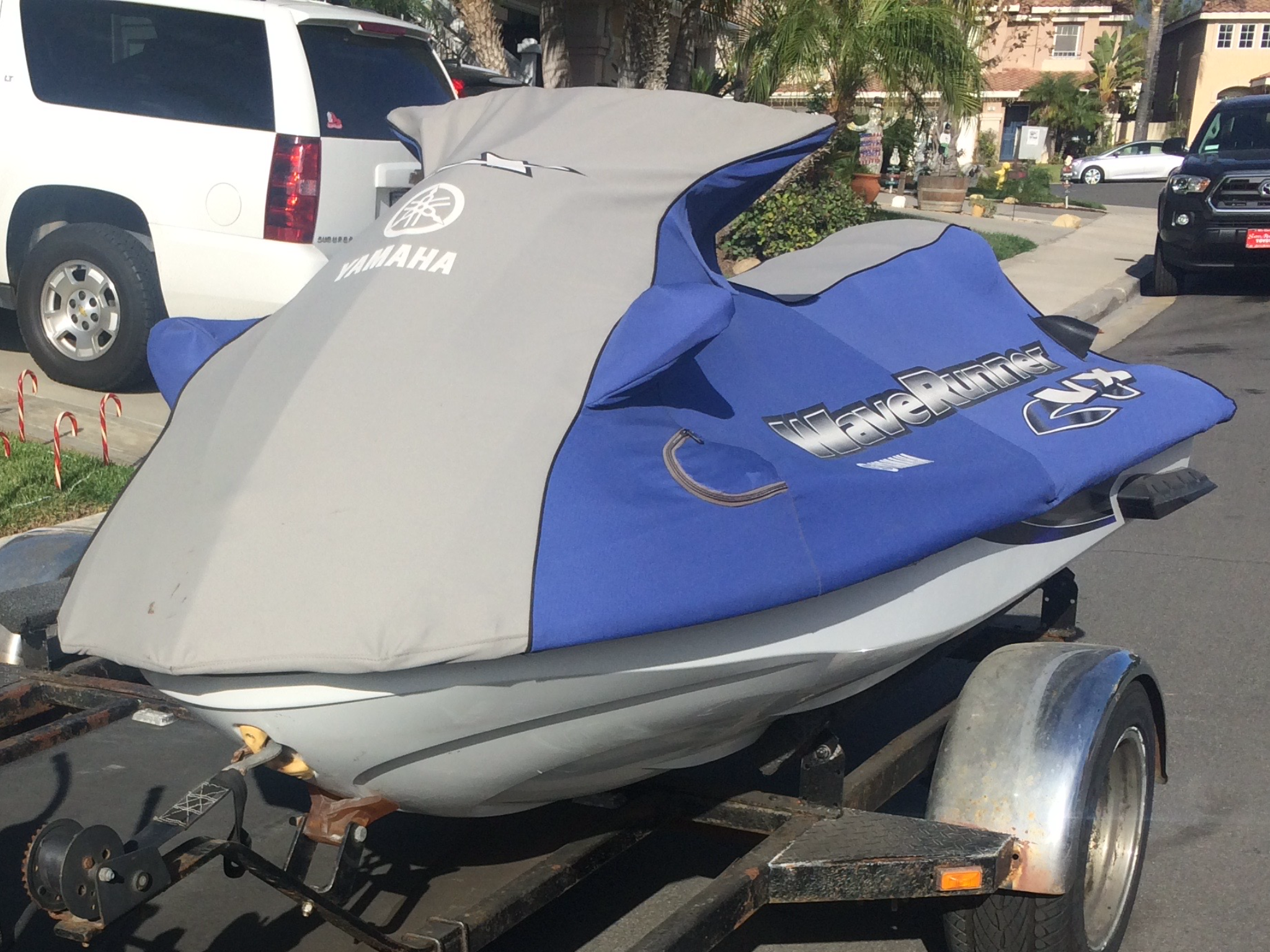

So far, here's what I know about the ski:
1. Hull is in great shape. It has a few scrapes here and there, but appears to be fine.
2. Battery is dead.
3. Steering cable needs to be replaced.
4. Seat needs to be recovered
5. The owner said that he rarely used this ski. He told me that it ran fine the last time it was used. It simply wouldn't crank last time he went to start it. He took it to a mechanic who said he could start tearing into it. But he didn't feel it was worth doing. So even his add even alluded to the fact that it might need serious engine work.

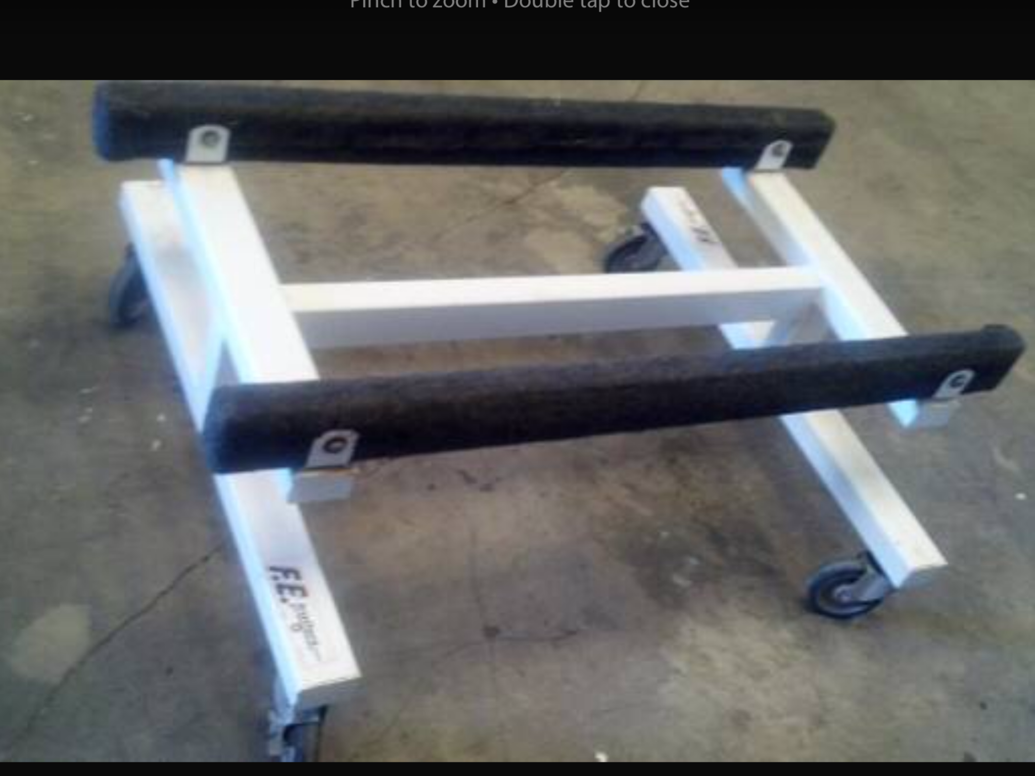

Well the first order of business was to get the WaveRunner off of the trailer and into the garage. So I found a stand on Craigslist that was perfect for that.

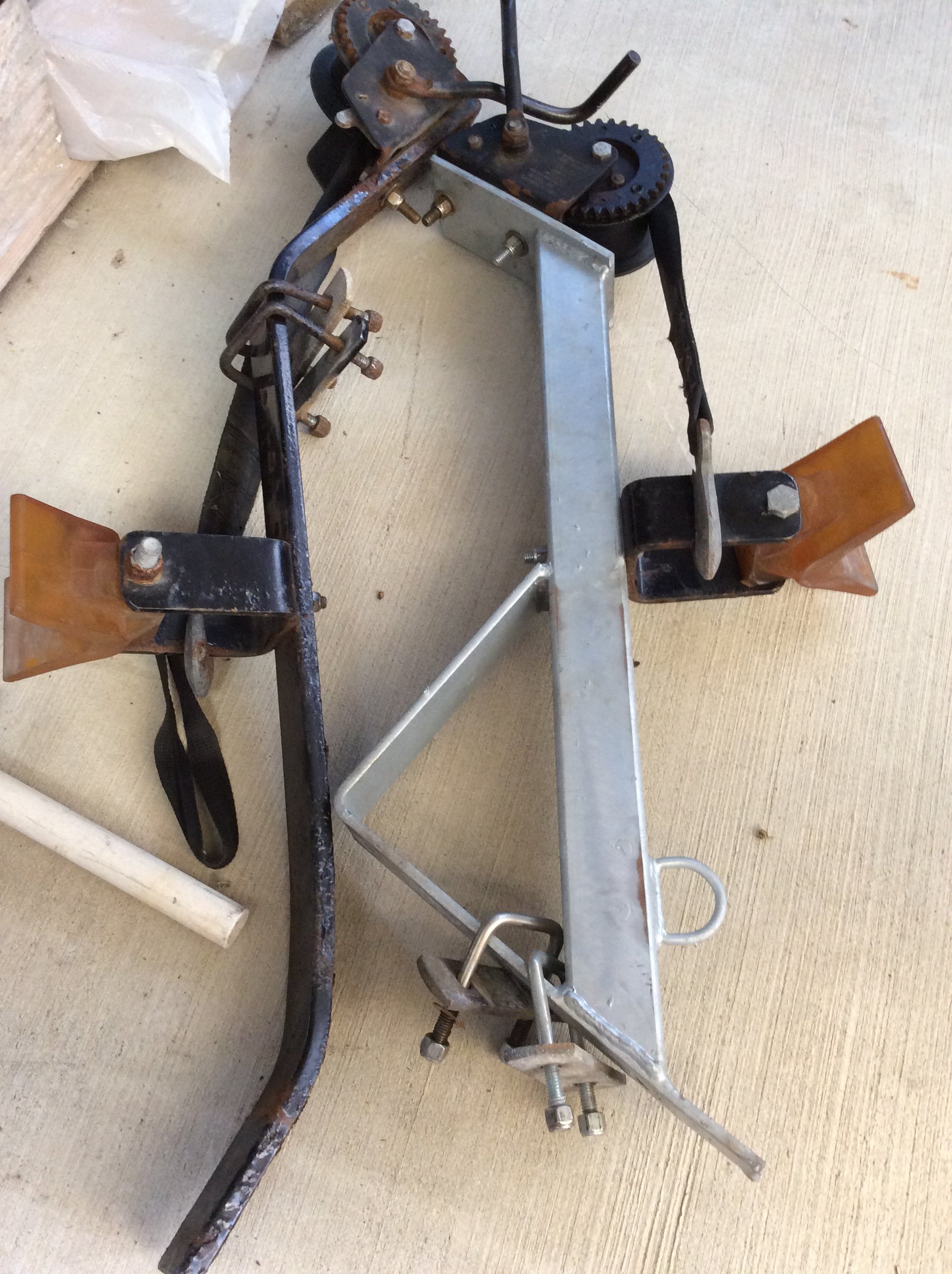

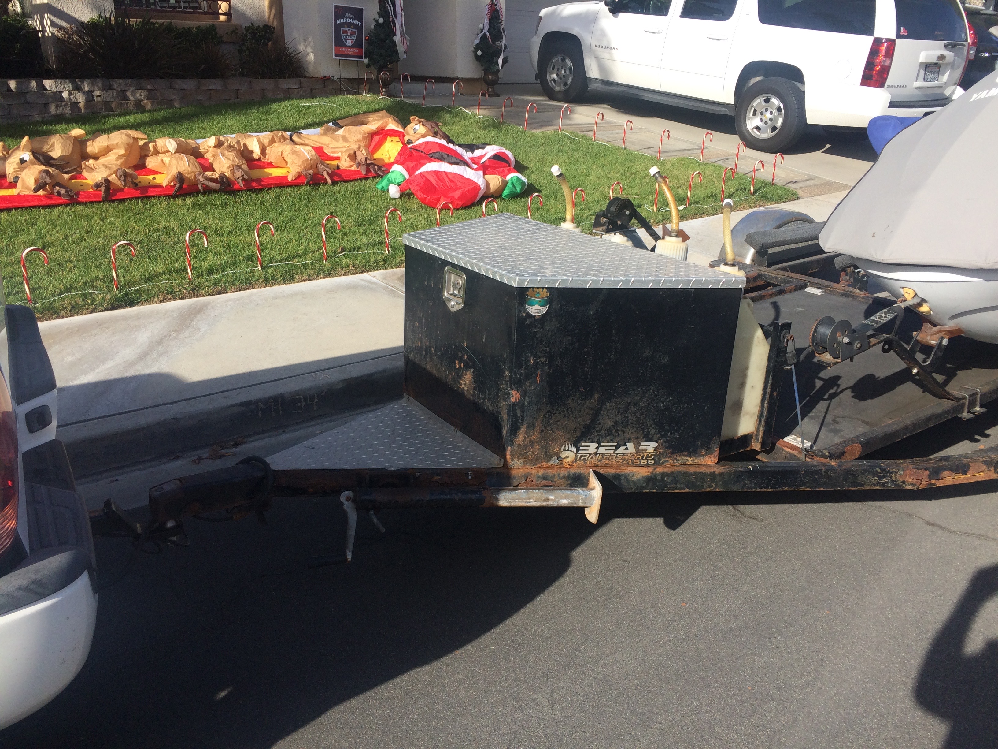

Also, I don't have room to store a double trailer so that needed to go. The original owner stated that he'd throw in the trailer for the agreed price. Before I saw the ski and trailer my plan was to simply sell the trailer and recover some money. After I saw the trailer, I was wondering if it would make it home the 60 or so miles that I had to tow it and I really figured that I'd have to chop it up and put it in the dumpster at work. I have never seen a trailer this rusted out. The axle, rims, tires, springs and fenders seemed ok. But the frame of the trailer was actually folding in half at each bend where it had rusted through. There wasn't a square inch of paint that hadn't blistered from rust underneath. In fact, I found the ID tag at the bottom of the toolbox. It had the paint stuck to the back side of the tag. The paint had literally separated from the trailer because of the rust. So really I don't think there was enough solid metal to weld over all the holes on this thing. Trust me, the pictures don't do it justice. Anyway, I had a few buyers lined up in the $150 range but a friend of mine really wanted it for the axle, springs, wheels, fenders, coupler and toolbox. So, we removed the bunks and bow stops (just in case I need them on my next trailer) and I handed him the paperwork and he was kind enough to tow that eyesore away from my house. ;)
So by the third or fourth day of ownership I had the ski in the garage and the trailer gone. I'll be looking for a good galvanized single trailer. I'm pretty sure this ski is going in the ocean.
