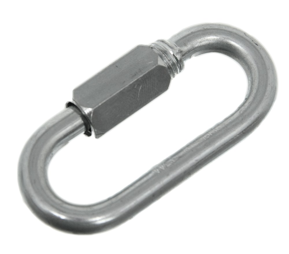

Kind of looked like this:
More piece of mind:
Thanks, all for the information. It's been a great help. Looking on you tube on how to tie a bowline knot.

You also need to worry about chafing, line on line or line on steel/metal will eventually chafe through. The carabineer's are good to prevent this. A bowline is a great knot but if you know how to splice line, do it. I like the picture of the carabineer's opposing gates, one is none; two is one.
I hold my anchors with the opposing caribiners and it works great.
I use a screw gate carabiner on my anchors, any ropes I take on and off on a regular basis that I like to have secure - same convenience as a carabiner with added security of a locked gate. I prefer to use a climbing grade carabiner on my marine equipment.
