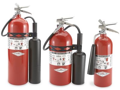

Originally I ordered an Amerex from the Fire extinguisher warehouse, but they were on backorder. So I got mine from U-Line. You need the bracket above to meet USCG requirements. It's a beast but helps keep the extinguisher in place.
