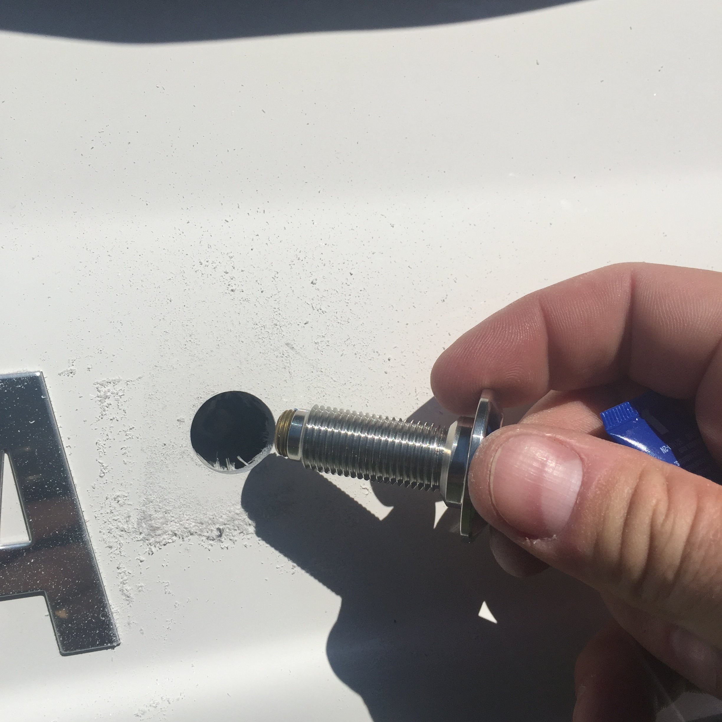

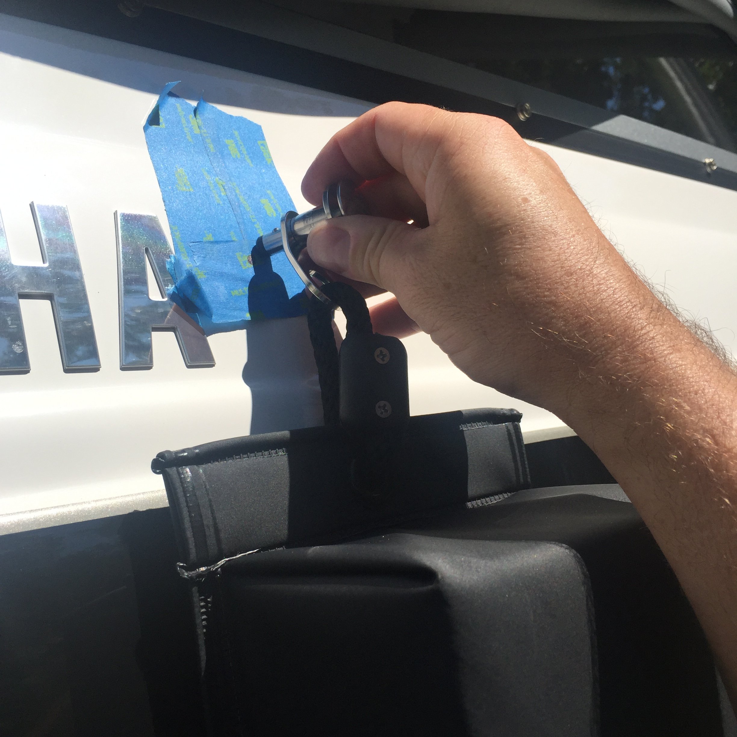

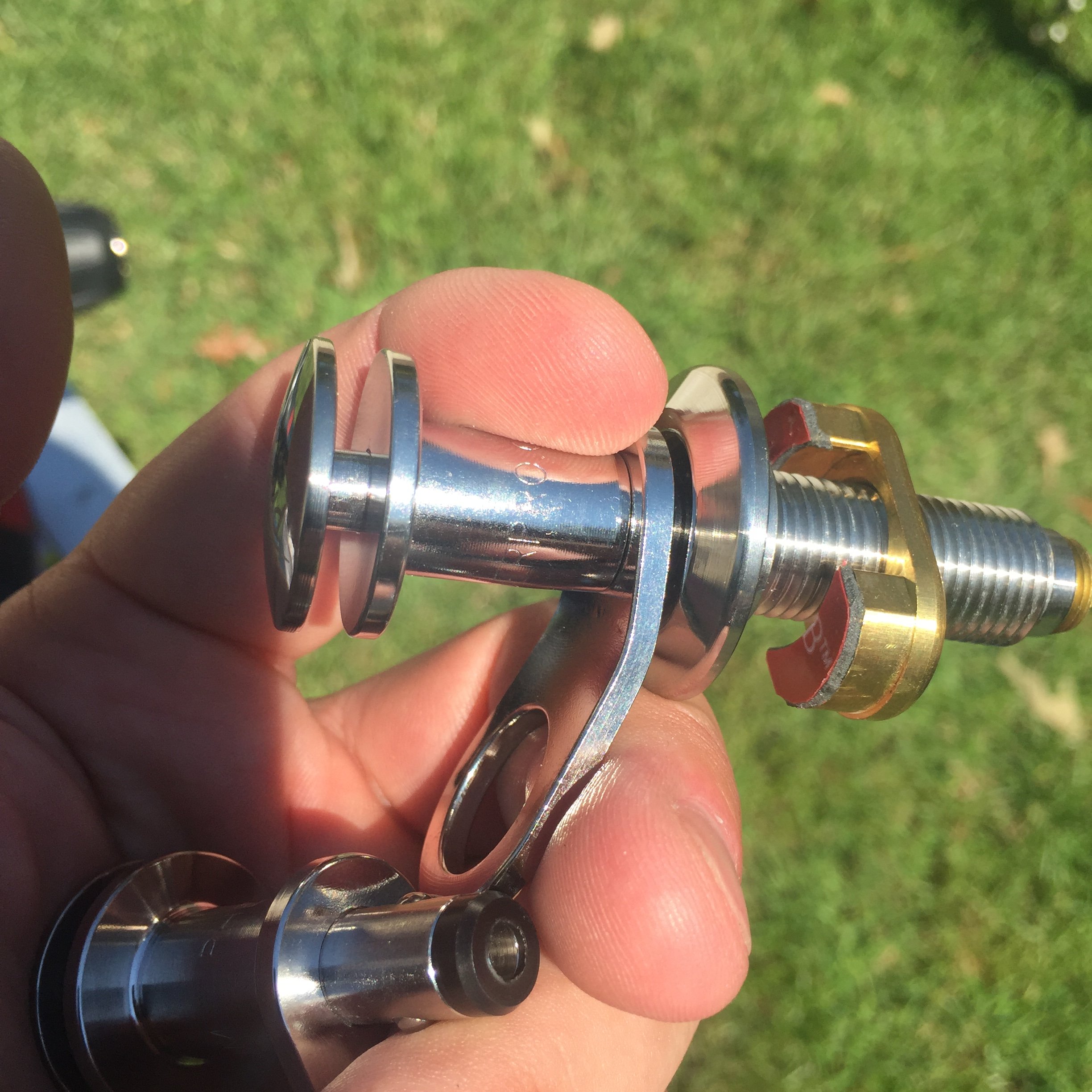

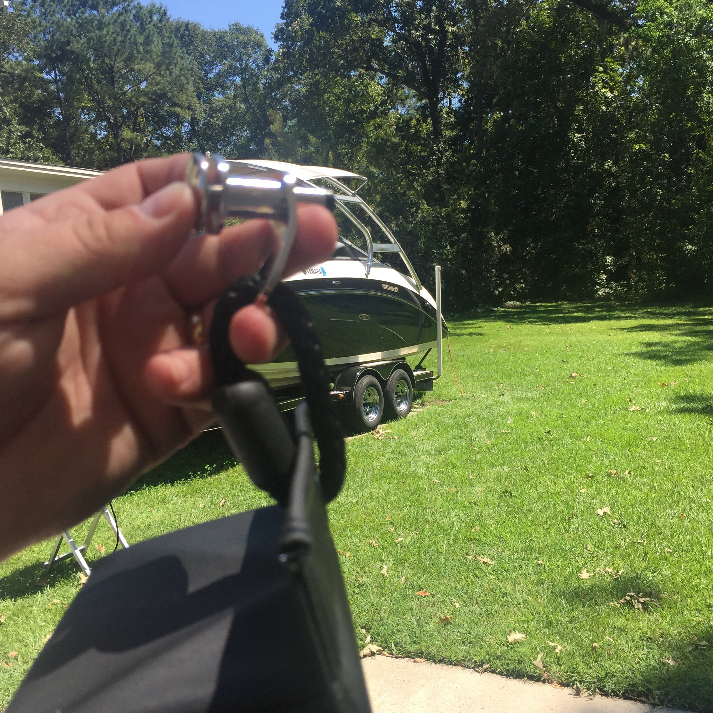

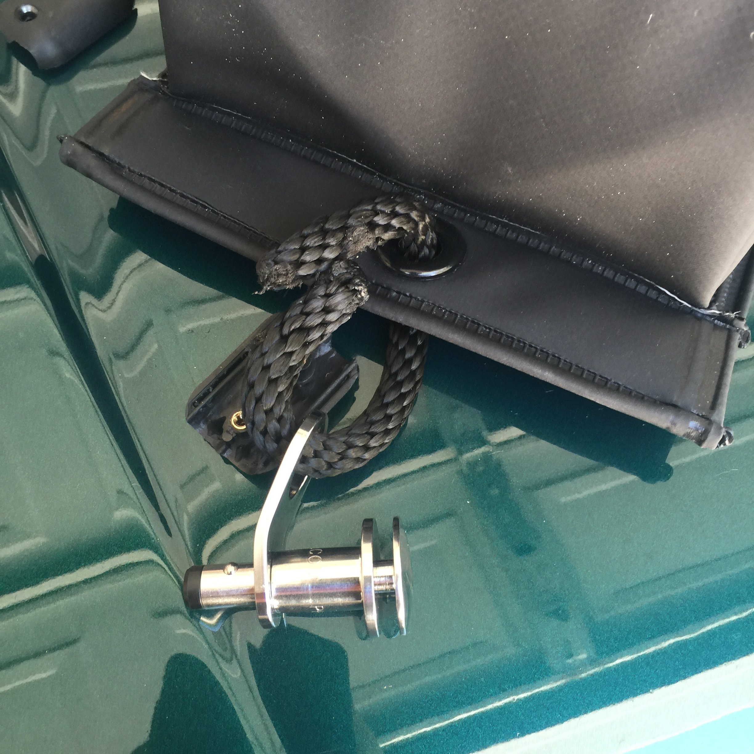

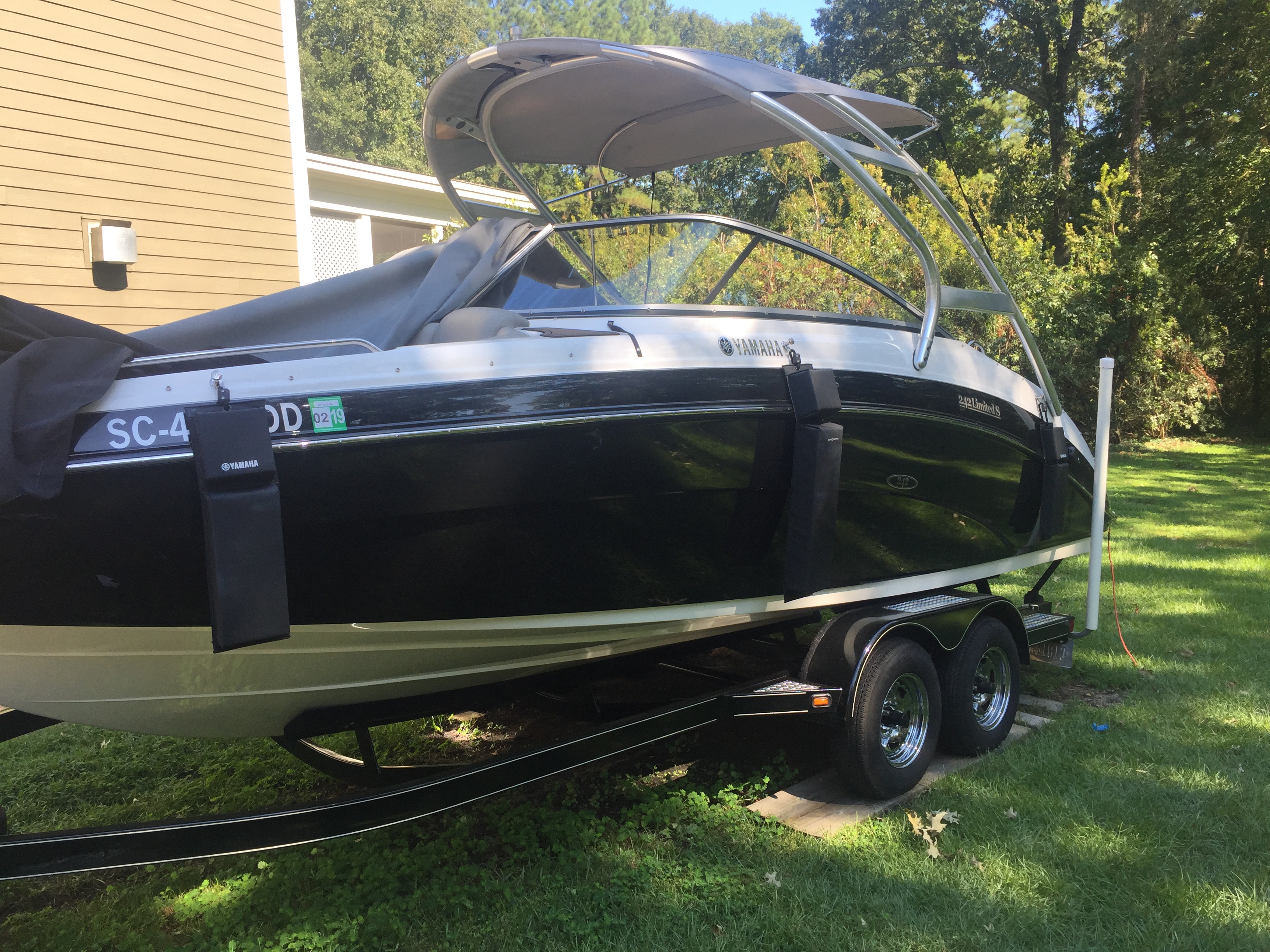

My wife is not the best first mate in the world so I finally had to bite the bullet and get some quick connect holders.
These are solid brass and then chromed, there is receiver piece that hard mounts to the hull and then you have these pieces that attach to the fender. When I bought the boat, I bought the curved Yamaha fenders and the line for them from the Yamaha website. Those ropes were worthless, utterly worthless. The factory cleats are not ideal given the skill sets of my family so these are perfect.
Got these from Overtons, there are other brands but only the Big Sky ones have the rear fastener rig they do. It works great. Not cheap but they work great.

Thanks - No need to drill those? I'll admin the drilling was a bit unnerving but it was a easy once I started. I used one of those countersinking type bits that open up from small to large. It worked like a charm and no chips.
I knew they weren't cheap but I wanted the brass ones and to only have to ever worry about them once.

For where I boat at, tidal with current, three is a must. Went with longer one in the middle and the shorter on the front and back.
