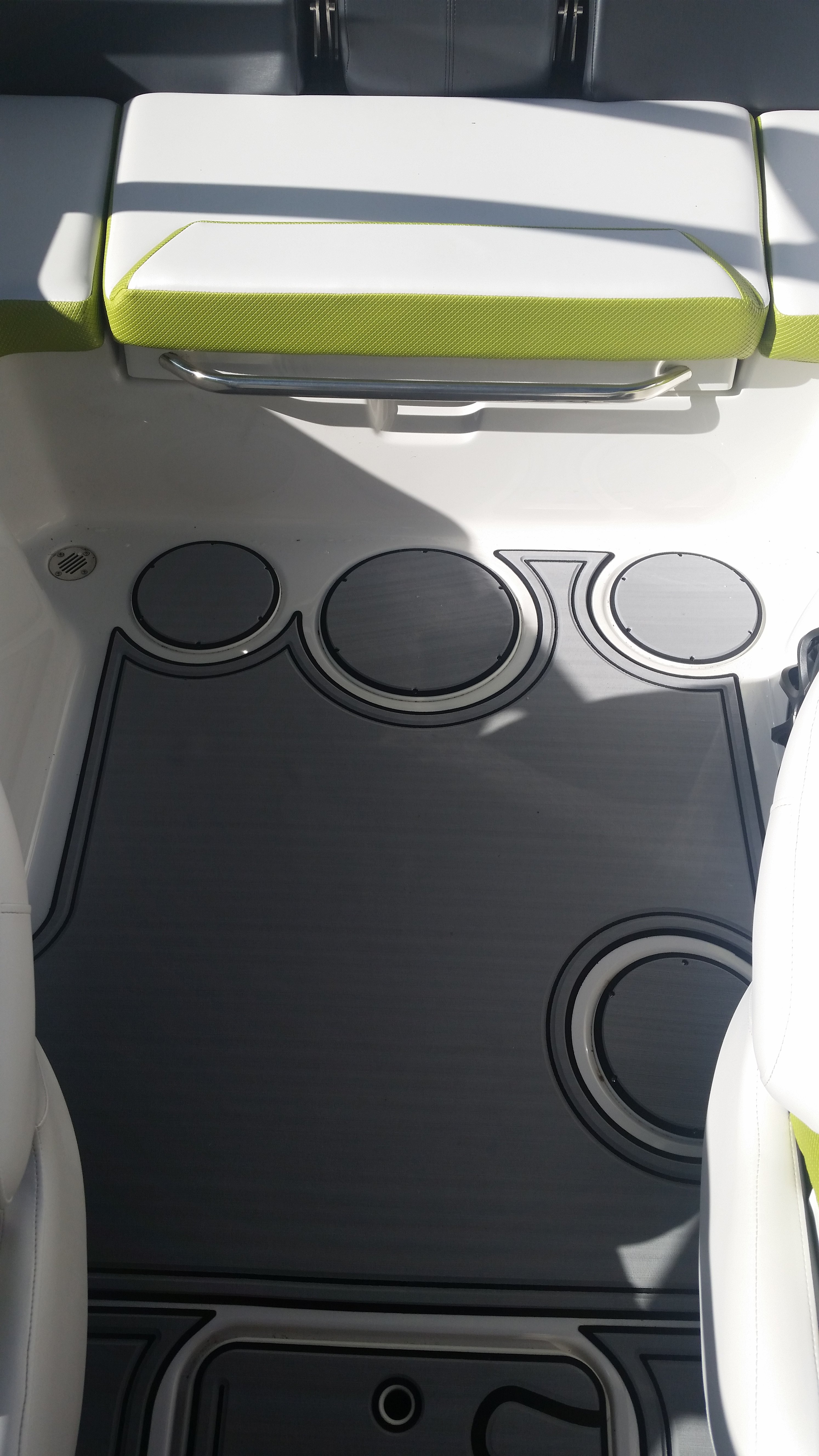

This was just posted to me today by Scarab. It is on our Facebook page as well. I do agree that the Glastron mats are the worst and 1st Gen Scarab's mats. I have been adding (Installing) these SeaMats brand to various boats and I can tell you that they are of high quality and easy to clean with just soap and water. In our deal jackets, there is a brochure from the company for any issues and care responsibility for the customer.
