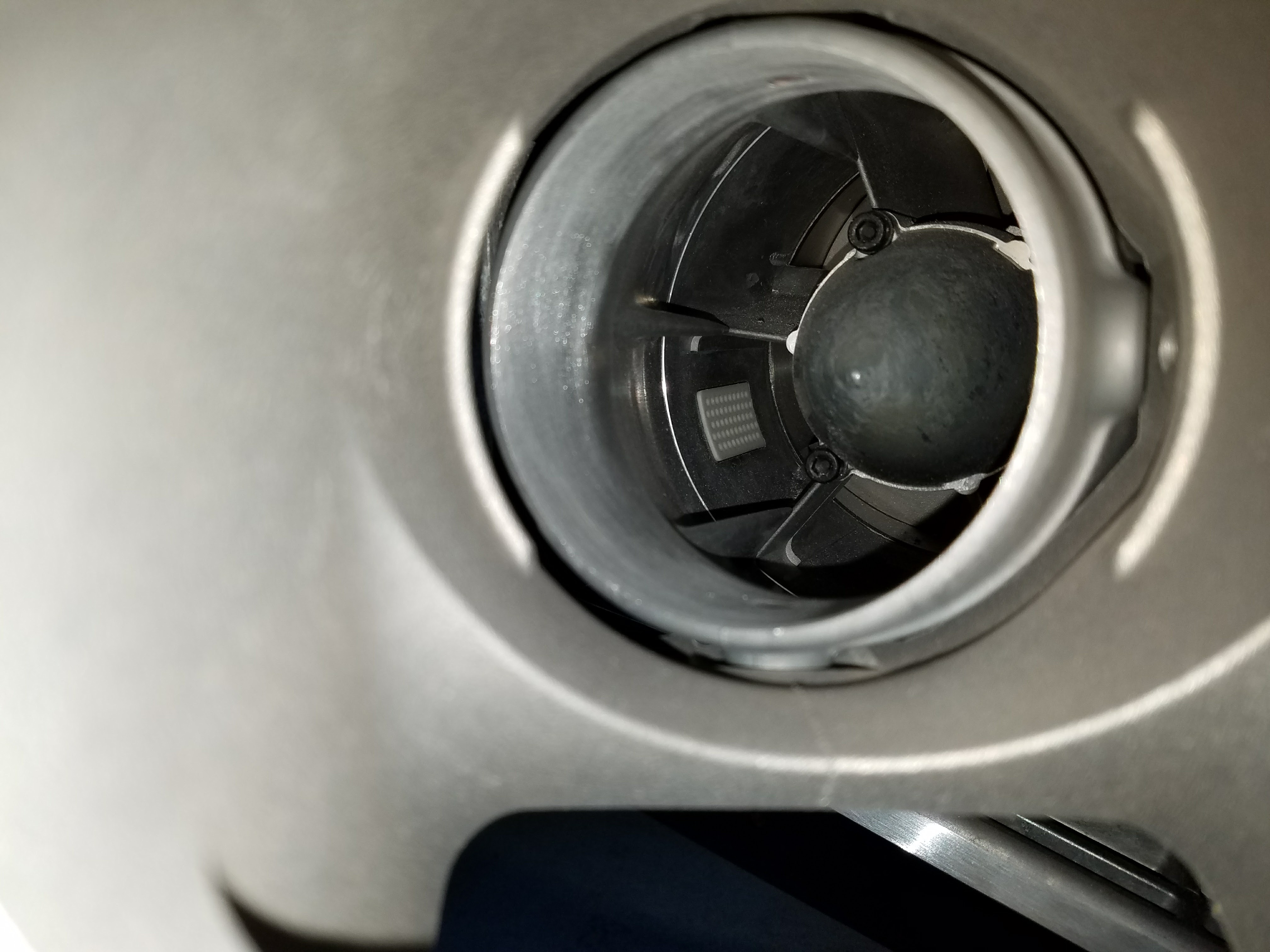

Here's the other mod I did to the jet/nozzle area that I think was another positive change. If you look in the turning part of your jet nozzles, you'll see a couple of vertical bumps or ridges on the sides. If you turn the wheel, you can see that the jet stream will hit those bumps and get diverted/obstructed somewhat. I believe what the engineers were trying to do there was to bend the jet stream towards the side more, presumably helping with steering control. The watercrafts don't have those, which also tells me it must have been to aid steering on the boats. My thought was this... Why would you want something that obstructs the jet stream to aid steering after you put the Cobra Jet fins on to drastically improve steering? With the Cobra Jet fins, steering is NOT a problem, so if removing those bumps or ridges lessens steering, so what.
So I removed them! lol. And guess what? The boat loses less speed when turning and corners F'ing hard!!! This 212 now turns so d@mn hard that even after telling us what he was going to do, my son cranked the wheel full lock when going 50mph and my wife ended up in my lap when she slid across the back seat! And she was trying to hold on! I was holding onto the grab handle as hard as I could when he whipped back the other way and I thought I was gonna rip the handle out of the fiberglass! Crazy. Oh and with the intake grate mods I did, this boat HAS NEVER CAVITATED ONCE. You can leave the throttles wide open and do whatever manuevers you want, it will never cavitate or over-rev. Ever.

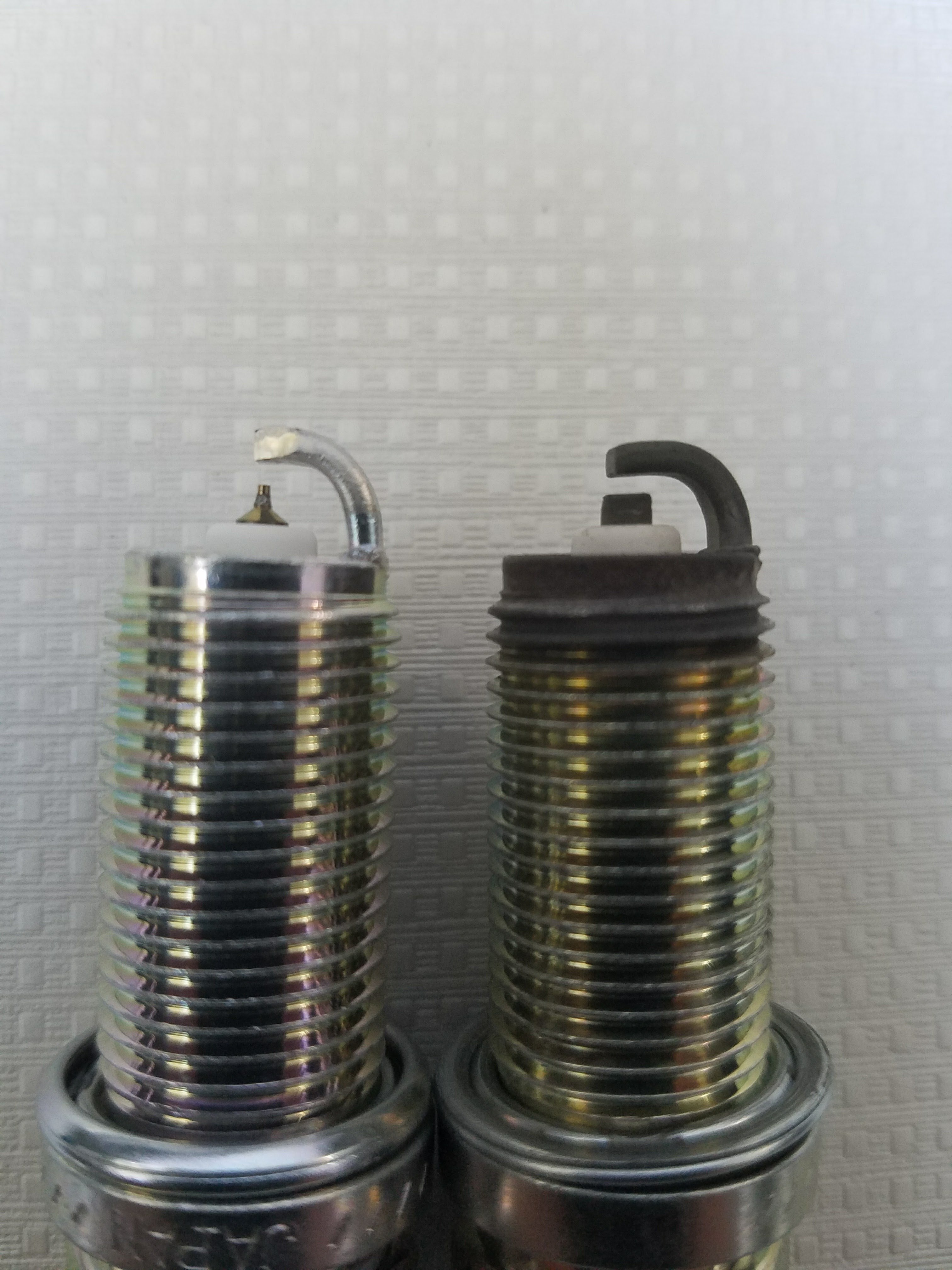

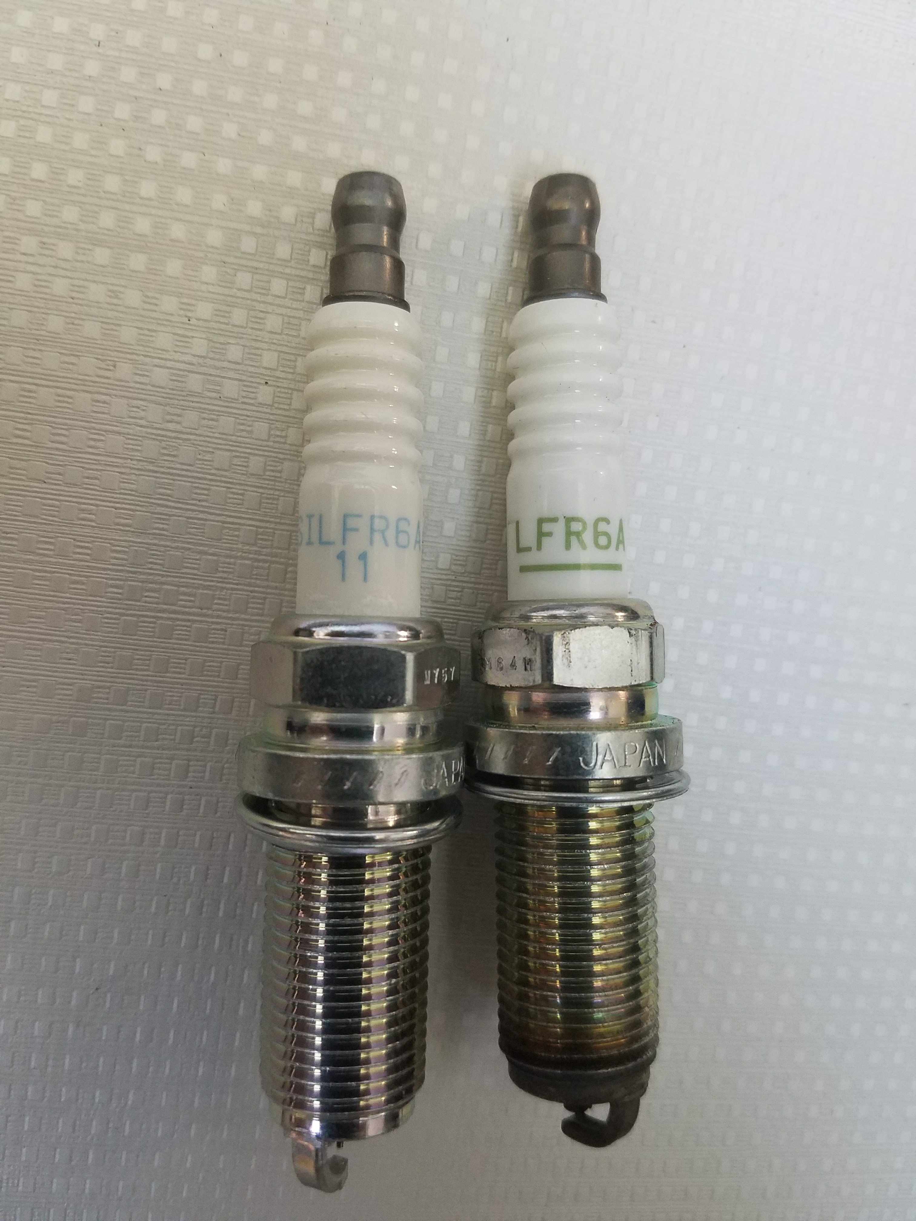

The other "mod" I did was to swap out the plugs with Iridium's. The stock plugs in the '17 1.8's are NGK 6668 LFR6A's. They're V groove standard nickel plugs, 5k resistors, heat range 6 and a stock gap of .035" or .9mm. Yamaha specs on the gap are .8mm to .9mm. I went with NGK 5468 SILFR6A11's. They're fine wire iridium's with a platinum ground electrode. Still the same 5k resistor and heat range 6, but the stock gap is wider at .043" or 1.1mm. I left the gap stock, knowing that the iridium plugs will be able to fire at a larger gap ok and the coil on plug ignition system in these Yamaha's should have enough overhead to be ok with the higher voltages. The risk on bumping the gap and voltage requirements is that it's harder on the coils, only time will tell me if it matters in this application. I doubt it will be a problem.
I'm not one to say "Oh my god the power is so much stronger and smoother with these plugs!!!". haha. A change like this is VERY hard to notice, even for somebody like me with decades of engine tuning experience. It's more of an attention to details thing. It "should" make a difference, and the difference "should" be positive. Can you feel it? I'm not sure, the engines in these boats run really well anyway. Maybe they're smoother? Maybe they're a little more responsive? Like I said, it's really hard to say definitively with stuff like this. My personal experience says it's a worth while mod to do and you may or may not "feel" a difference.

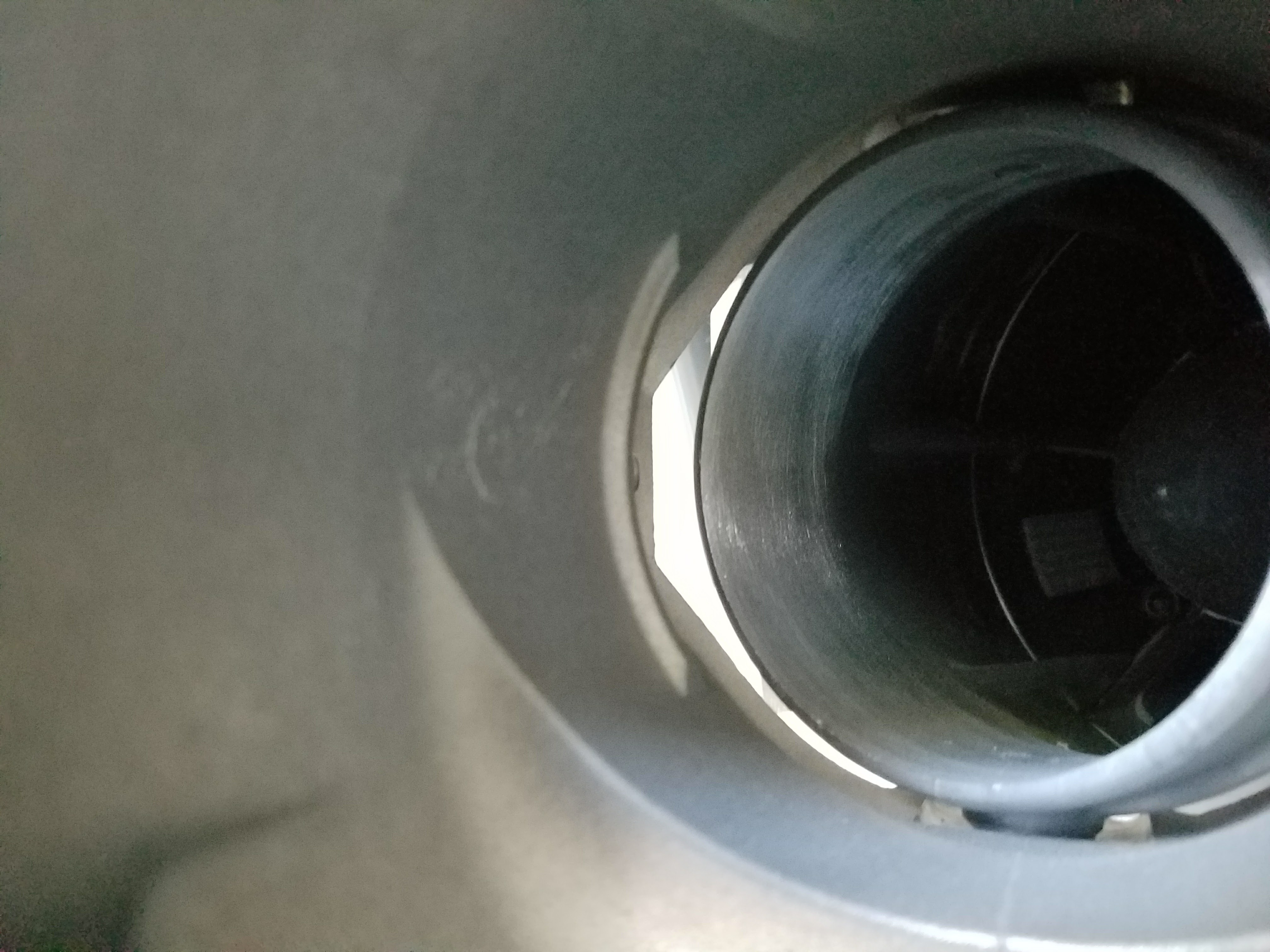

In this picture, the "bumps" I'm talking about are the parts that are brightly lit that look like ( ) on the side of the turning part just past the nozzle opening. I ground those off with a porting tool. You could use a round sanding drum like people have used to open the bore of the nozzles too.

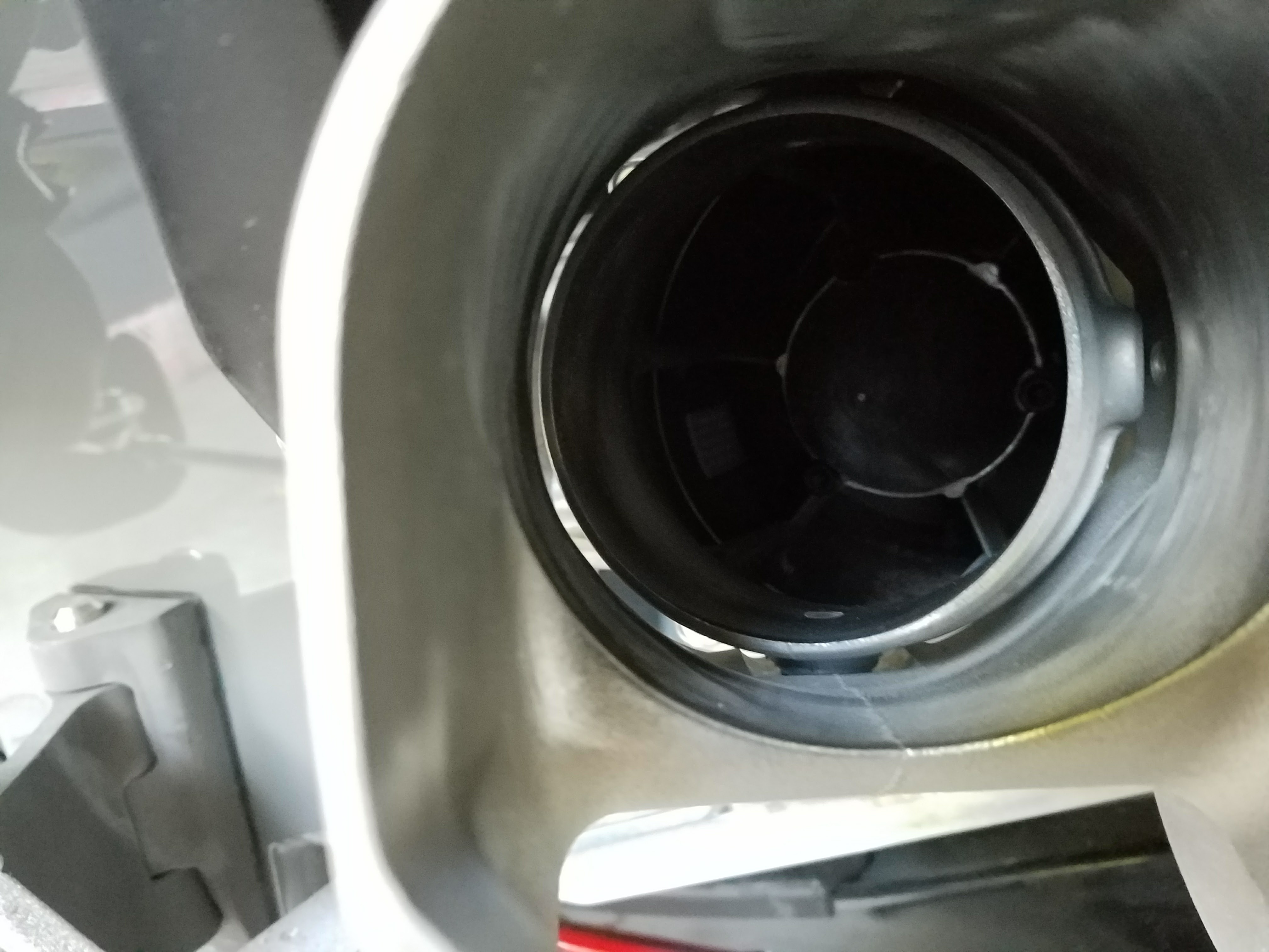

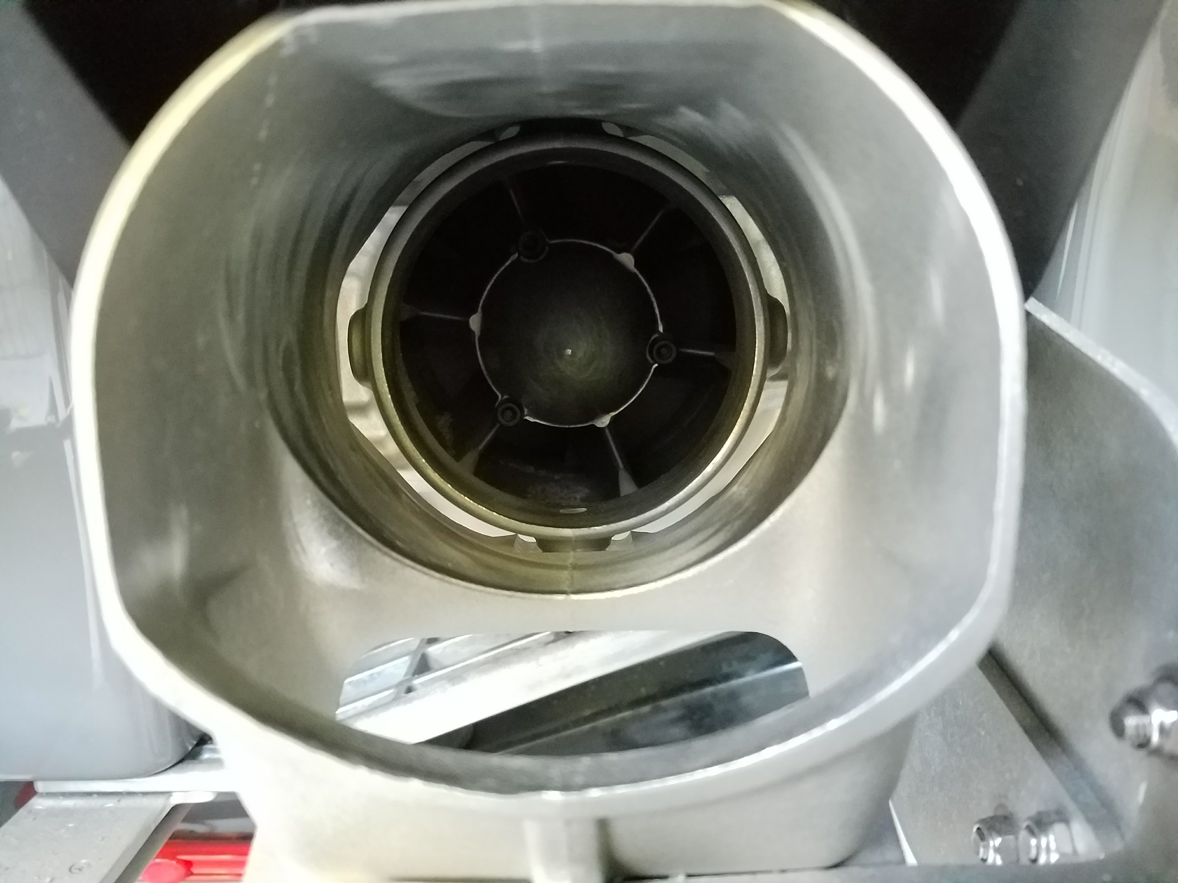

These pictures show after I ground the bumps off the sides...
I'm a complete engine tuning moron....can you help me understand how a spark plug can help with the performance of the engine? I would think that if it is sparking and detonating the gasoline, that is the only thing it needs to do. Wouldn't it be really noticeable if it wasn't detonating (fuel in exhaust)? I'm not being a jerk here...just trying to understand how a better/different spark helps.....

On the spark plug thing... It's not a jerk or a dumb question at all. You're right, for the most part if the plug is firing and the charge is igniting, it doesn't make a huge difference. That being said, you can effect the combustion with the spark though. In the "olden" days, "indexing" plugs was a common thing for hot rodders to do. It was simply rotating the plug in the head so that the ground electrode wasn't shielding the charge. It was good for a few hp's if you did it right. The iridium to the standard plugs are a similar situation. The standard V groove plugs have a really large ground electrode and positive electrode. They can block the proper ignition of the charge. The iridiums firing area is exposed as much as possible to avoid that. That's just one factor, the gap is another. Changing the plug gap can change the way the engine runs. Too small of a gap can cause a rough idle condition. Too large of a gap can misfire when the mixtures are very lean because the coils can't provide enough voltage to jump the gap. (The voltage needed to jump the gap is way higher when the mixtures get leaner.) A larger gap that the coils and combustion pressures can handle can produce more power because the higher spark voltage does a better job of quickly igniting the mixture. Remember this too, a single cylinder misfire at 8000rpm might not even be felt. A cylinder that just didn't get a "solid" spark to fire the mixture but it wasn't a full misfire won't be felt, but will result in loss of power. Make sense?

What intake grate mod are you refering to?
Are you opening the inside diameter of the actual steering nozzle? And how are you machining it?
The intake grate mod I did is in a thread I made with something about "taboo" in the title. I'm not opening the diameter of the steering nozzle at all, it's already really big, maybe even too big compared to the PWC parts. And I'm using porting tools, but you can use whatever you have to grind off the "bumps". A sanding drum on a drill would work.

What did you open to 86.5?
I see the removal of the "bumps"
But not your mod you first referenced
Here is the "bump". I must admit - I never noticed it.
I'm pretty sure @gmtech16450yz is boring the venturi nozzle to 86.5mm
That works very well, I've done it before while tuning the L13s. I'm currently running stock, but that is definitely a mod to try - for a killer hole shot.
I could be wrong, but I would think those ridges are meant to force "straightening" of the steering nozzles (after a turn) - basically if you where to release the steering wheel in the middle of a turn - the boat will straighten itself up - quicker with the ridges.
I like the idea of shaving those off!
