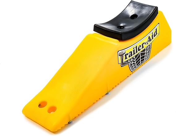

If you have an tandem axle trailer (that is what Yamaha's website describes), just carry a Trailer Aid Plus. It is cheap, sturdy and extremely safe (especially with the trailer connected to the tow vehicle). I have a Trailer Aid for my travel trailer. I have not used it to change a tire, but each year I use it to lube (Dexter EZ-Lube) my travel trailer's axles. Shop around for the best price.
  • Trailer Aid Plus Tandem Tire Changing Ramp - The Fast and Easy Way to Change a Trailer's Flat Tire - Holds up to 15,000 lbs- Features a 5.5-Inch Lift - Yellow (21002)

That's awesome! This is my first dual/tandem axle trailer and I've never heard of those. Definitely going to get one, thanks for the post.

That's pretty amazing, just saw a few videos. I will be ordering one of those for sure!

I always carry trailer bearing grease and grease Gun when towing as well as the other suggestions - as others mentioned a floor jack and I also keep it under a tonneau cover - that trailer aid looks interesting though - I bet it’s lighter than my steel floor jack!
