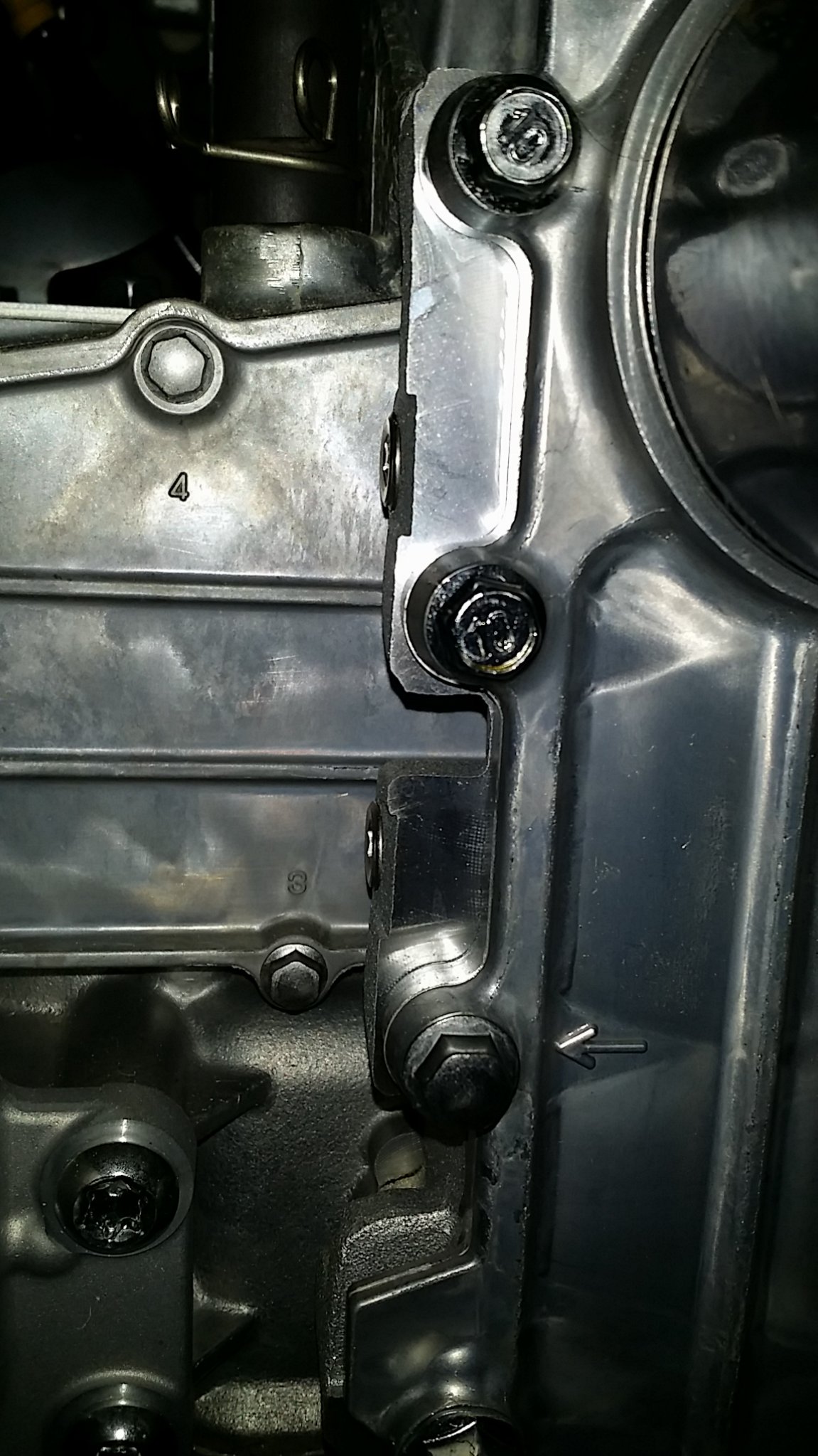

Just to revive a useful reference with a bit more info I've gathered this week. I went shopping over the weekend and looked at both a 2010 and a 2011 242LS. Checked out the 2011 first, and it had the updated coolers installed:
Notice the 3rd bolt down is slightly different and there is an arrow pointing towards it. This is the new style.

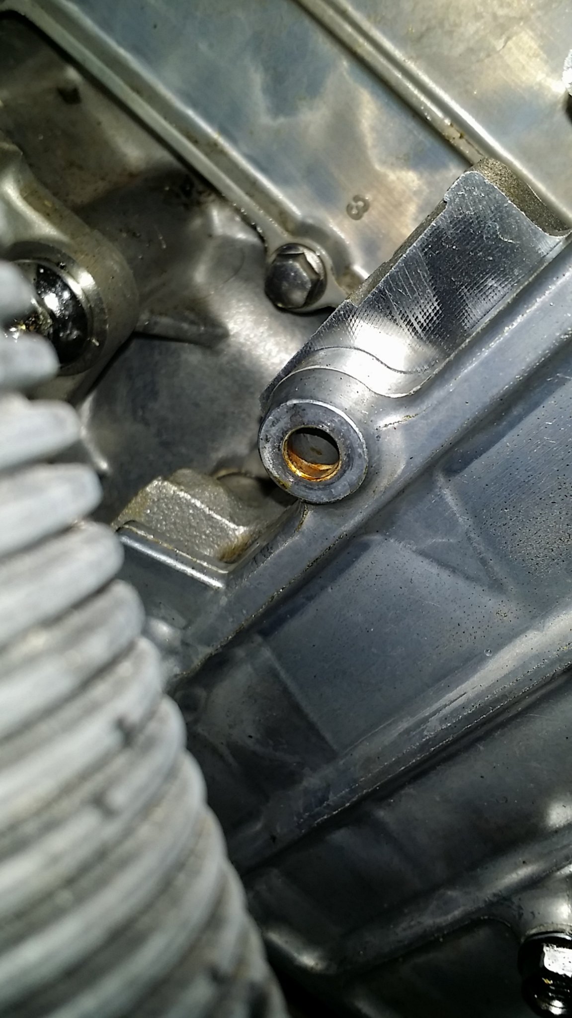

Then, looked at the 2010 and actually found it already had one of the bolts broken.
Notice no arrow, and bolt head gone.
Now, he called his local dealer today, and they claim that you don't have to update the coolers. All they do is extract the broken bolt, and replace with an upgraded bolt. He said they only get the updated coolers while under warranty. Claims they've never had an issue repairing it this way. I'm curious if other Yamaha dealers/technicians agree...
