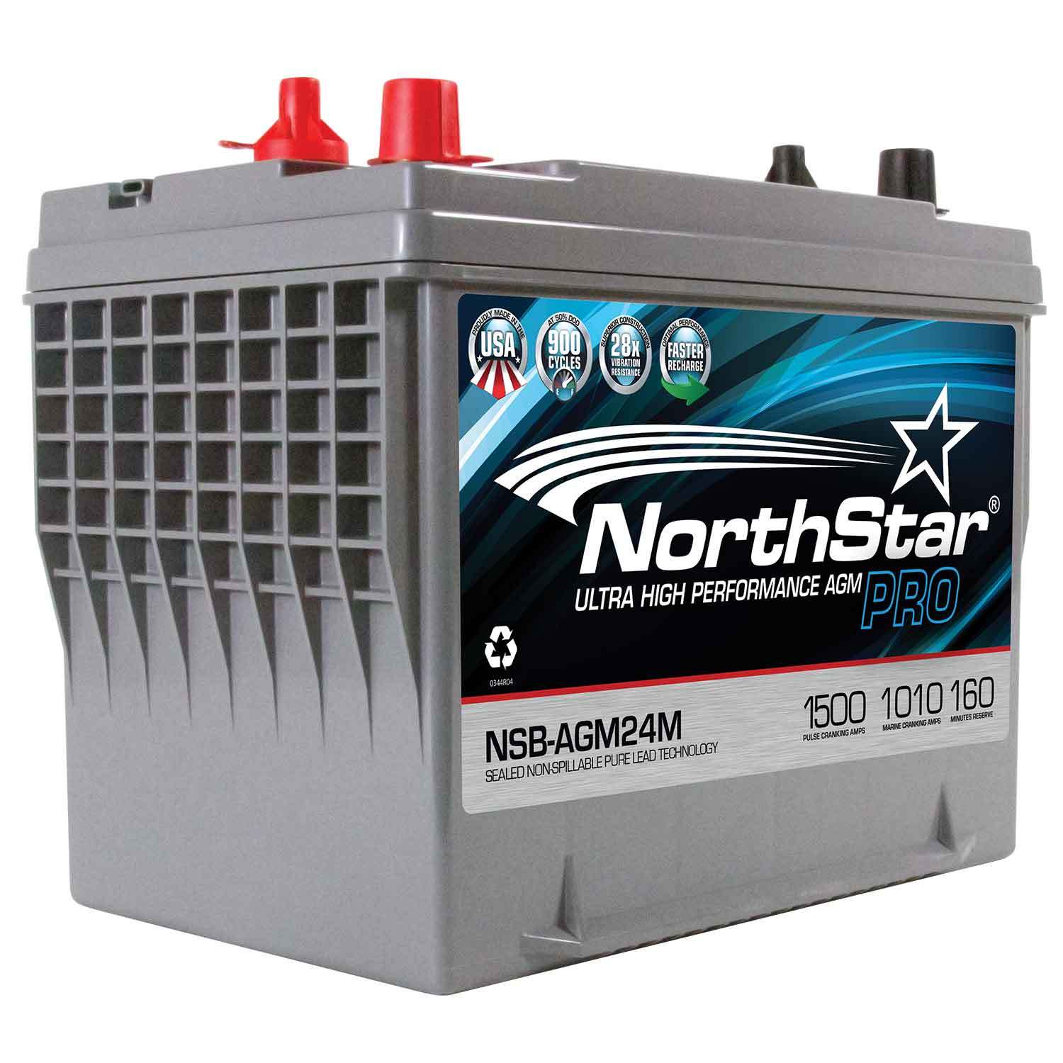

New to Jet Boating - and I just learned IMO something valuable. First- to set the stage: Most recently I came from express cruising. Big engines (high performance 502's). EC's big engines come with very powerful alternators to run electronics, ice-makers, refrigerators, radar, TVs etc. This is the land of series 31 AGMs and TPPLs. Long distance cruisers are yet another whole story. BUT - in short, regarding battery size, bigger and more powerful is better - in THAT world.
My 2020 Yamaha SX195 vcame with an Interstate 24M-XHD. Not a crap battery but IMO, entry level. IMO an AGM would be faaaar better with an AGM thin plate pure lead (TPPL) being the Holy Grail. My experience has shown me that both of these batteries are super fast to re-charge and super slow to discharge (I mentioned this on another thread). Biggest feature of TPPL, IMO, is that they LOVE a big charge and will accept ALL of what most chargers/alternators can throw at them.
So.....several buddies and I all decided to get new batteries. As these would be new batteries it provided an opportunity to assess charging rates. One friend and I purchased Series 27 TPPLs the other a Series 31 TPPL. We bought a case of beer and made some nachos. In suggested we get a new "smart" charger. Voted down. Started to charge the 31. I thought the charging was going waaay to slow. Called a buddy who said you guys should know better - AGMs should have a "smart" charger TPPLs have to have one to charge properly. I went out and bought a "smart" charger $140.00 on sale for $99.00.
SIDE BAR: "smart" charger? Guys have written books on this but basically - charging profile varies but must include the following charge phases: *Desulphation *Soft Start *BULK charging *Absorption charging*Analyse and charge *Maintain - charge to maximun at low amps.
Soooo..... we hooked the new "smart" charger up to the 31 and holy $hit. Charger displayed a battery % charge at 70%. Then the charging started at 2 amps...we went WHAT, 2 amps????? That's stupid???? Then BAM 25 amps, 2 amps, 25 amps. The charge immediately jumped to 80%. Next, the charge varied up and down around 8 amps. Then BAM a full 25 amps and the charge rose to 90%. Next the amps varied again while charge rose to 95%. Then for 15 minutes or so minutes the charge varied from 1 amp to 9 amps - up and down. Finally, it ran for about 15 minutes on 1-2 amps showed 15 volts and 100% charged. Called friend back who said - call me after you charge the series 27 and tell me what you make of that. did that - the Series 27 followed exactly the same profile but (as expected) faster - quite a bit. Called my friend back. He asked - so what do you now know about TPPLs regarding a jet boat?
AGM or (better yet) an AGM TPPL and Jet Boats:
  • AGMs charge faster and discharge slower than any other battery chemistry.
  • AGM TPPLs take the advantages of basic AGMs to a whole new level.
  • AGMs should be charged with a smart charger, TPPLs must be.
  • TPPLs with their thinner 99.99 pure non-recycled lead have much greater surface area and obviously weigh more than regular batteries. The series 24 (more about that later) TPPL I purchased weighed about 10 pounds more than the Interstate 24M-XHD (which is itself heavier than many G 24s)
  • TPPLs love big amps but will also accept all the power sent to them by an alternator or stator.....CRUCIAL for our type of boat chargers(Stators)
What does this mean to a Jet Boater?
  • I was able to get a tremendously powerful (slow to discharge) and quick to re-charge battery in a "small" Series 24. Yes, I returned my series 27 for a series 24 (reason later)
  • If I anchor at a sand bar and use the stereo this battery will not only last longer but re-charge waaay faster. If you have two 1000w amps then for your two battery set-up get an extra (house) 24 TPPL.
  • That this type of battery is quick to accept a charge and not self-limit the amperage accepts is CRUCIAL, because our stators do not throw a lot of amps out so - unless we want to take our boat for a long re-charging run or have to put it on a charger back at the dock or on land at home - this battery is a tremendous help.
Called my friend back and said I learned that in a Jet Boat a bigger series battery is not necessarily better. In fact - a smaller battery that accepts a charge waaay faster and discharges waaaay slower is far better given the "different" charging system of a jet boat. You don't have to get a huge battery to get performance - just a different type! The correct chemistry/type of battery is far more important in a jet boat. He said - well, you got it buddy!
Real world:
Installed my fully charged series 24 AGM-TPPL yesterday. While I was installing a modified fortress anchor in the bow anchor area the Admiral was listening to the stereo. I decided to try a test. Turned off all electronics. Read the volts. They were down. Started the engine - at idle only, tied to the dock and let it just idle away - the volts climbed faaast. In a few minutes, at idle, the full voltage was displayed. Turned off the engine, waited a few minutes, keyed ignition on, still full voltage.
My recommendation:
  • For single engine jet boats use a series 24 AGM TPPL (same size WAY more performance) for twins 2X 24 AGM TPPL
  • If you have a massive stereo get a "house" 24 - AGM TPPL.....the synergy of combining two TPPLs over two "regular" batteries is said to be about 4X as robust.
Final Key Point:
From my charging "experiment" and my real world charging experience - IMO - it is far better, when using a jet boat charging system, to have a smaller battery, that our charging system can charge fully - and - much faster, than a big battery that our systems can only charge to 80% - and - at a slower rate!
I believe that with this AGM-TPPL battery I will be able to leave my boat in its wet slip with - no shore power charging battery maintenance - for the summer. Time will tell if I'm right.
