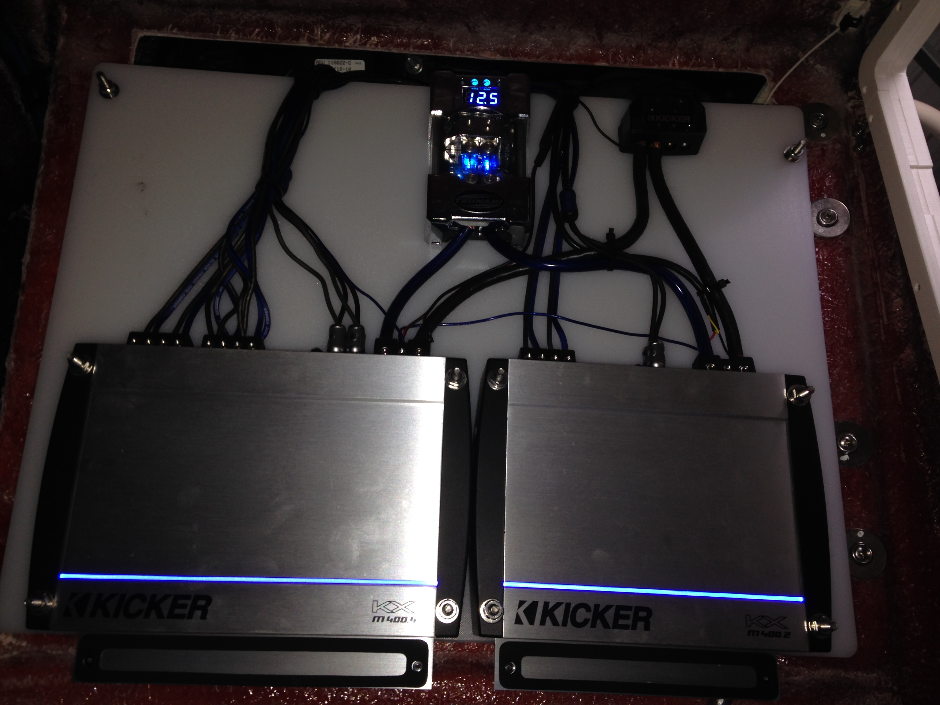

I had the same question with my AR240 when I added my amps. I went the 4 and I always had over heating problems - always!
Then with my new boat I went with 0 wire, it has made a Hugh difference. Amps are never running hot like with 4 - plus I think I get better sound too.
Don't focus only on the wire - also make sure your connections are good! I went with heavy duty connection stright onto the battery and direct to my distribution block.
There is no such thing as overkill when it comes to powering high end sounds on a boat!
