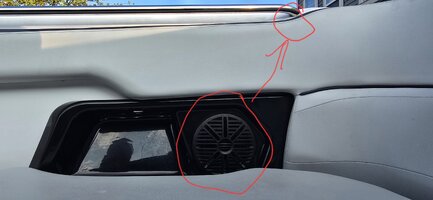

I'm currently trying to remove the starboard side speaker (stock, original speaker) in the bow to tighten the handrail above it, on my 2022 AR250.
There are no visible fasteners, and nothing behind the speaker besides the wiring and four screws sticking out, so I'm assuming this cover pops off or rotates off to expose the screw heads.
It doesn't seem to want to do either. Before I break something trying to force it, can anyone tell me if it should twist left, twist right, or if I just need to get something under it and pop it off?

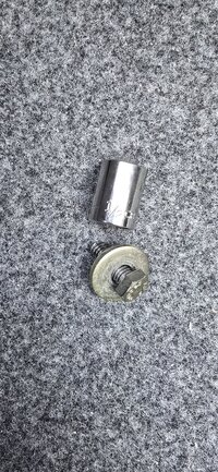

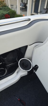

It did end up popping off. 1/2" socket worked. Used blue loctite to keep it in place.
