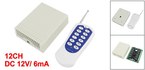

Other members have built high tech and functioning PLC and Bluetooth control systems for automated ballast control.
I am experimenting with another ballast control system route.
While researching for blue tooth relay boards on the internet.
I found some key-fob to relay board controllers ($300 range).
I then ran into this 12 channel remote with relay board on Amazon for $32.
I ordered one to experiment with.
I like the idea of not using my phone, just have a dedicated remote to control things.
Planning a 3 zone 6 pump system, 1-1/4" intake with 1200-gph aerator pumps.
Pump system will only need 6 relays and I will have 6 extra.
Can print label on back to identify which number does what.
Looks like it has 20-amp relays on the board.
Pumps only draw 3-5 amps so I would just wire directly to relay board.
Also thinking of putting some LED indicators somewhere to tell me when and if pump is on.
If it works, simple, functional, and easy wiring.
