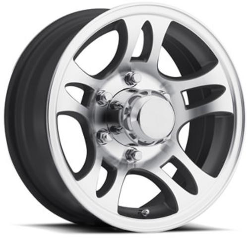

Got these at Discount tire.
T-03
$95.00 each. SENDEL T-03
and the have the 14" trailer tire that is 5.5 or 6 inches wide
You should not have to buy the center caps assuming that you are going to install bearing buddies or reuse the stock ones. I bought some sendel rims a few years ago. If you want to go with a D weight rated tire like the good year endurance 2 you have to install metal stems to get full weight capacity of the tire and make sure the rim has a matching weight rating.
