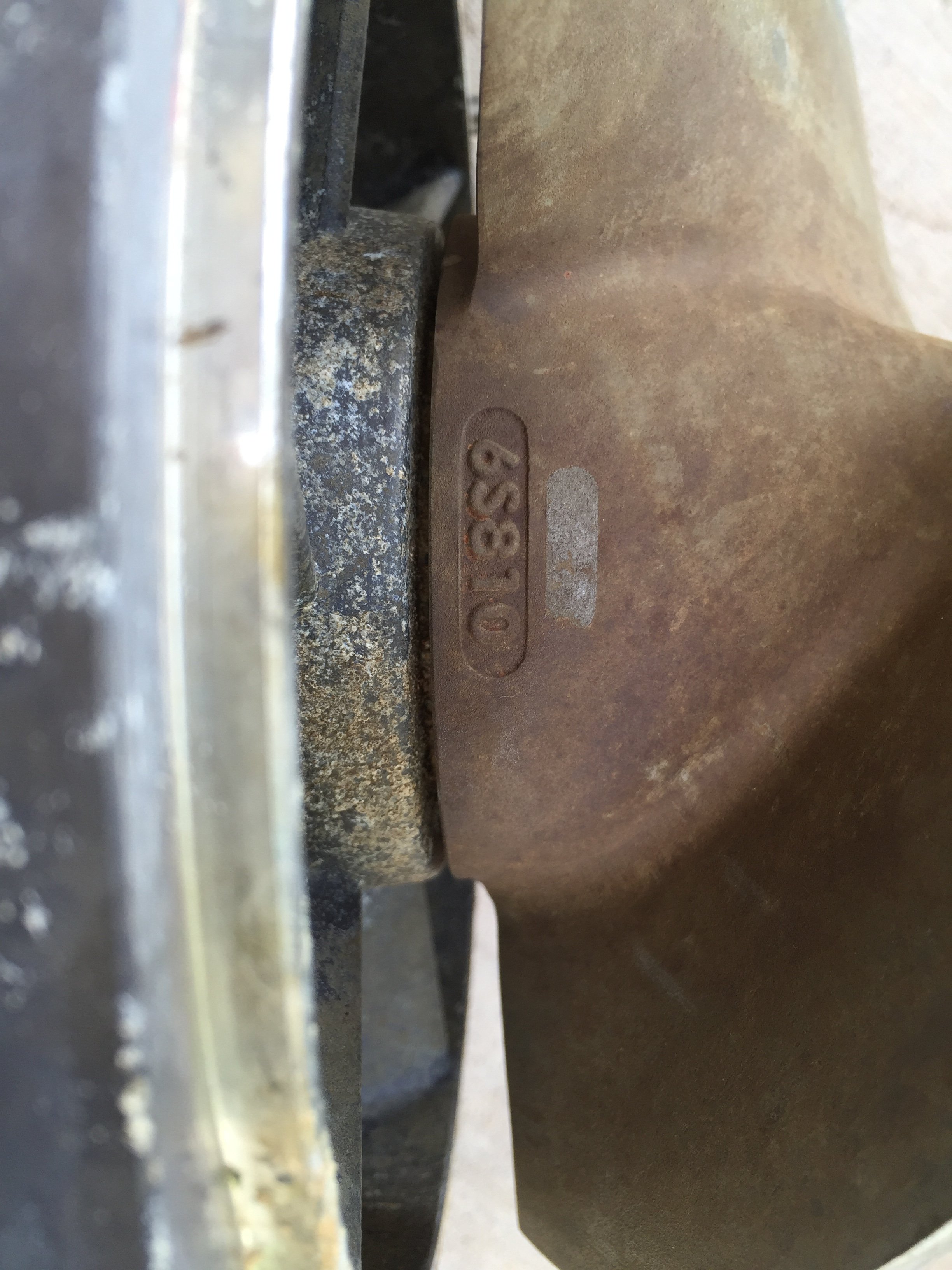

I've always had poor top end speed with my boat. Best ever was 40mph solo with 1/2tank and just a ripple on the water.
I pulled my pumps yesterday and noticed that both impellers have the same number stamped on them.
6S810. I'm inferring from the shop manual that these are both Stbd impellers.
Would that contribute to reduced top speed?

I would think it would have some effect. Did you buy your boat new ? If not, it's "possible" the previous owner had them reworked and changed the pitch on the port one.

if your manual says they should be different (my '07 manual clearly states it) I would think there would be some type of "issues" if they were the same.
I would show it to the dealer you bought it from and see if they will step up for you to make it right with Yamaha

If they are the same model and have not been repitched and/ or the throttles have not been recalibrated you should see a difference in rpms between the engines throughout the throttles ranges but especially at cruising speed and above. There are a few theories on why the stock impellers are pitched differently, I not an engineer but the ones that make the most sense to me are:
1. One side is more efficient at taking water into the pump than the other since both impellers spin in the same direction but the angles of the pump intakes are different on each side of the boat. This is supposed to be a large part of the reason the boat turns better to one side than the other.
2. The pitch of one of the impellers is varied a little (according to my shop manual for the 242 Ls one of the impellers has a .5 to 1.5 degree difference in pitch from the other) to compensate for the difference in performance from one pump to the other.
3. By varying this pitch of each impeller the rpms will better match throughout the throttles range and the boat will track straight(re) than it would have if it had matching impellers.
Is your boat's top speed impacted by your current impeller set up? It depends on which stock pitch they have (assuming neither has been repitched), since one is already optimally pitched per Yamaha's specs. A general way to tell is by looking at the rpms at WOT (wide open throttle), a properly pitched and un-damaged impeller should allow you to get to the stated maximum rpm smoothly (with little or no cavitation).
Altitude is another thing which impacts performance as does the condition of the implellers and engines driving them. Since I don't know how to measure impeller pitch if I was in your shoes I'd remove them and send them to Impros in California for an evaluation, recommendations, refurbishing and possible repitching. They can be tough to get s hold of on the phone but I've found its worth the effort and have done business with them several times over the past decade. Incidentally, I bought two Solas impellers from them for my 242 Ls. They are the same model Solas but one or both have been repitched (to what I don't know since this information is proprietary to impos) and they perform as I wanted (I.e., better acceleration / hole shot with little or no loss in top speed and the Rpms match throughout the throttles ranges). New implellers are around $400 each parts and labor but refurbing / repitching is only about $100 each. Plan on at least a month of down time if you don't have a spare set so the offseason is the best time to send them in. If you can't get them off the shaft by yourself consider bring the assemblies into a local pwc shop.

I think it is likely. As @Ronnie said the pitch is different, the port will be higher. If you are maxing out your RPMs by rev limiter, you could use higher pitch to still get to max RPM and gain speed.

If I read the shop manual correctly, the port impeller is supposed to have a more aggressive pitch.
For the same RPM that should push more water out the port pump and correct the pull to port.
It should also increase overall thrust and make more speed.
Now I'm excited to get the correct impeller.

Yamaha asked for pictures of each impeller showing the model number stamped into it. Sounds like I'm going to get a new port impeller.
