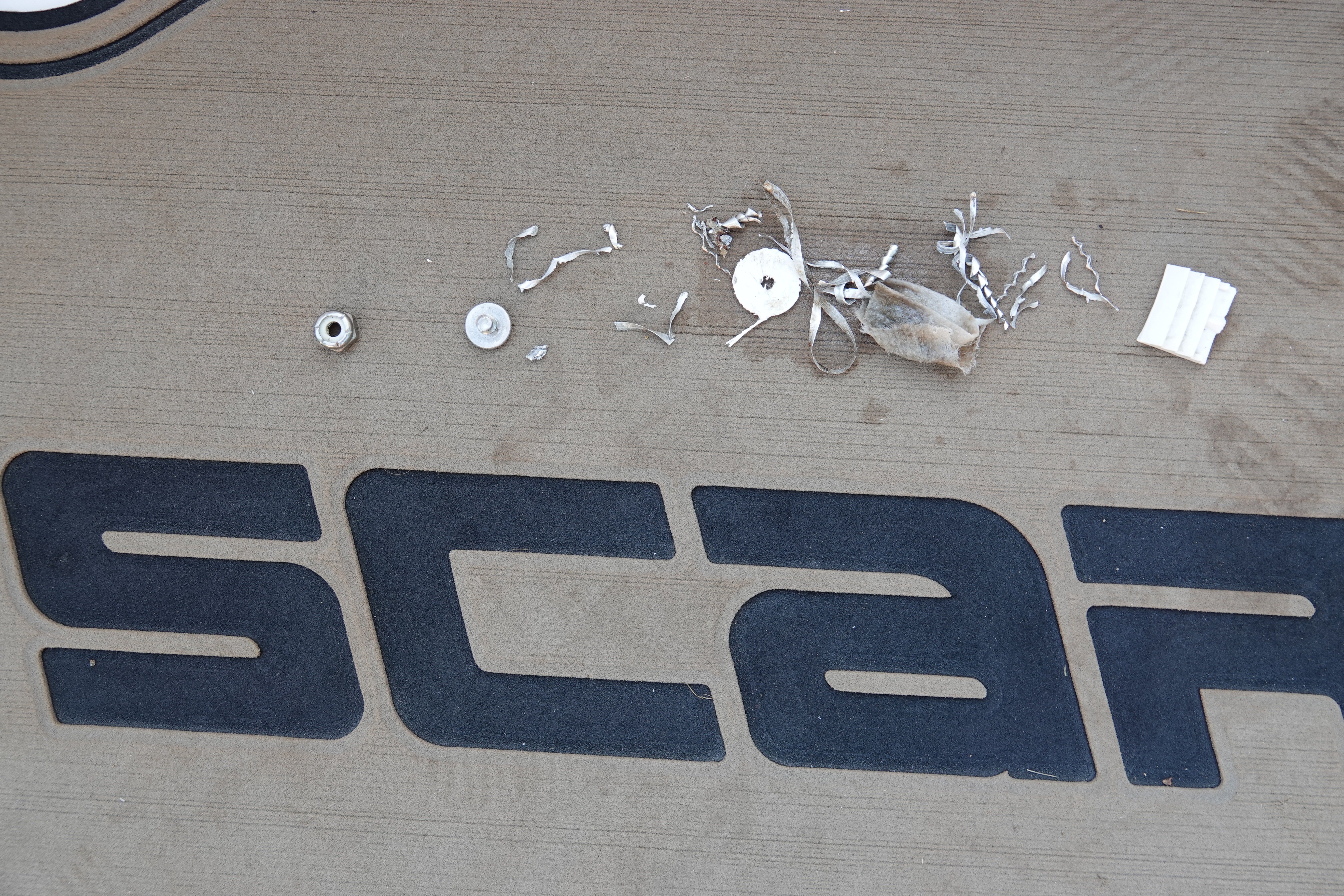

A few other things: The bilge would not drain - water always backs up into the ski locker. So for this winter’s clean up I put the hose in to flush out the drains and hoses this is what I got....a whole lot a builder junk blocking the drains and lines... I got about the same amount out of the bow drain area. Maybe someone at the plant needs to get a vacuum cleaner and use it!
It drains much better now.
