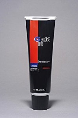

How much gear oil should I ad with the epnoc grease ? A capful ?
I spread grease on like peanut butter around and in spacer between bearings before pressing it it. Then packed housing and cone.
I thought of oil bath but once I was done it wasn't necessary.
This was my intermediate bearing housing.
This is what I ended up doing.
Mixed Yamaha epnoc with gear oil I had until it would just barely flow from the plastic knife.
Put the pumps outside in the sun and poured the mix on. I will leave it out for a bit to let the grease and housing warm up and gravity flow down to the front bearing. After I put the cone back they will probably sit this way until I reinstall before next season.CD5F91F9-735C-4A69-97FA-8A26EE11C89E.jpeg2281A279-5836-48B4-90F2-B7EC451AED5D.jpeg

I plan on mixing gear oil with a Yamaha grease in my cones this season, looking for the red line gear oil and all of them seem to say it's for a limited slip differential. Is this the same type of gear oil I should be using? Also where do I find the part number for the o-rings? did I search but couldn't find it or just plain missed it. Thanks.
93210-54010-00
I just used what I already had in the garage. Any gear oil is fine.
