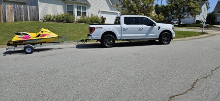

Blacktip is good cheap flooring. Actually good cheap stuff, period, for seadoo's. I have a blacktip seat cover on my 1996 and have had it for 10+ years. 20240826_121517.jpg
