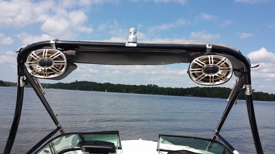

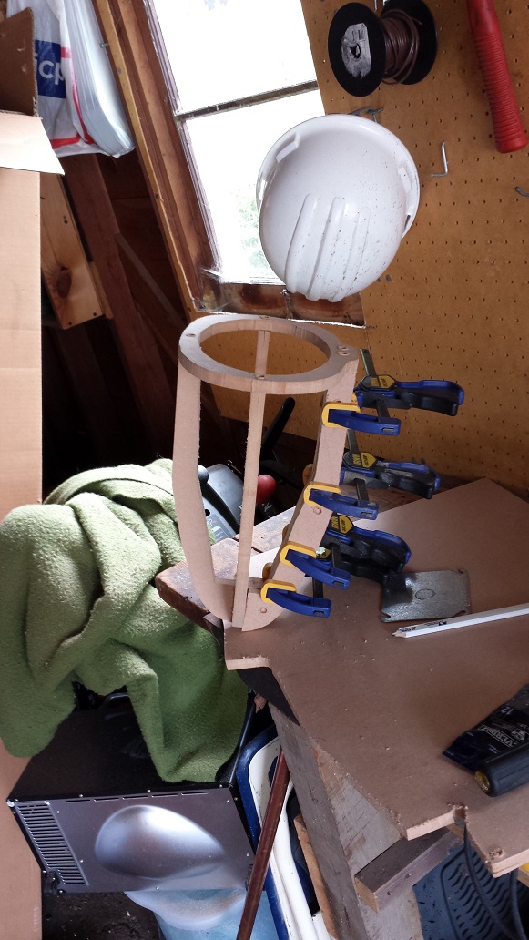

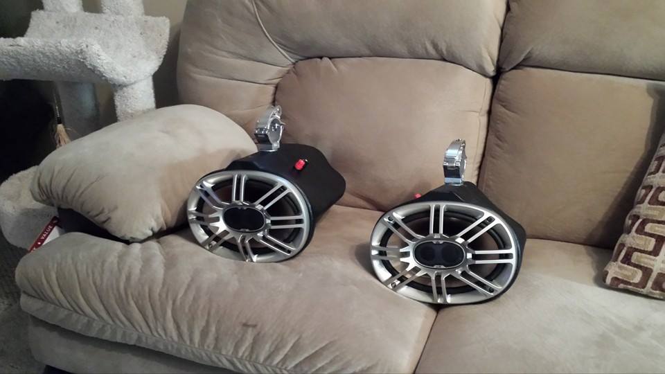

Here's my DIY tower speakers. The boxes don't have enough volume so they clip a little bit of the low end, but overall I am pretty happy with the sound quality and projection of sound. I didn't want to drill multiple hole (partially because I was lazy) so I sleeved the speaker wires in some black split-wrap and just zip tied it to the tower, ran it straight down the tower (by the removable pieces). I used Velcro straps on the removable tower supports and punched a hole underneath the side bolster. It's barely noticeable, but I wish I would have just ran in through the tower in hindsight.
