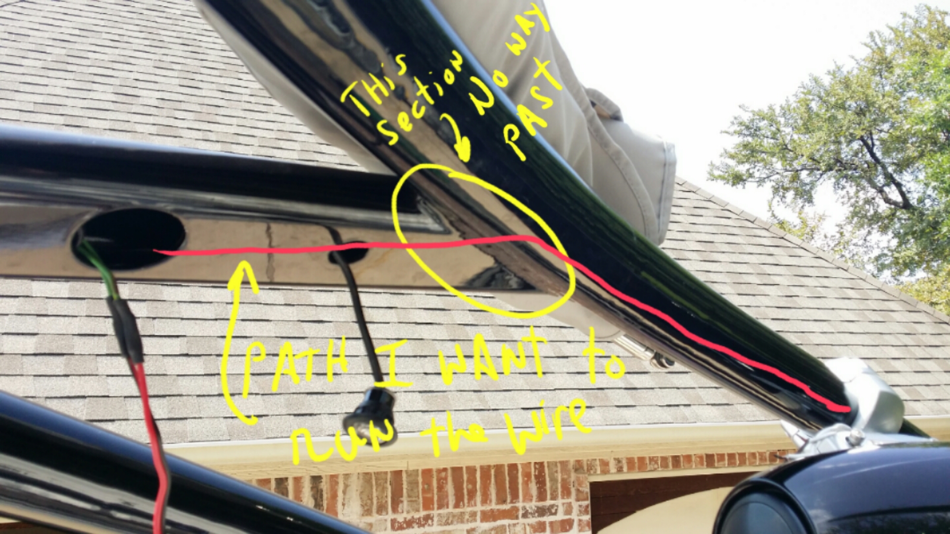

OK, i have figured out how I'm going to set up my amps/speakers but have run into another problem. Running the wires through the tower from the support cross member into the back tube (see photo). I cant find any opening into that tube and not sure how i can drill a hole using the opening from the tweeters.
Has anyone tried this or know how to run this wire/drill that hole?
Thanks
Through all my reading I have not noticed anyone going your route with the wires. If you are stuck on going that way I would think that the only way to do it would be to drill a blow in the cross member and the tower tube right where you have it circled and then thread the wires from inside to out to back to inside and down the tube. You can use rubber grommets where you drilled into the tower.
If you choose not to go this route, from where I see that you have the speakers mounted, it should not be that difficult to run wire from the amps to the base of the tower and then up the tube. This is the most typical way I have seen it done and is how my tower speakers are ran. Here is a picture of how the wires are ran around the joints. Kind of like what I mentioned above just in a different place.
To answer your original question... I am at a loss of how you could drill internally.
