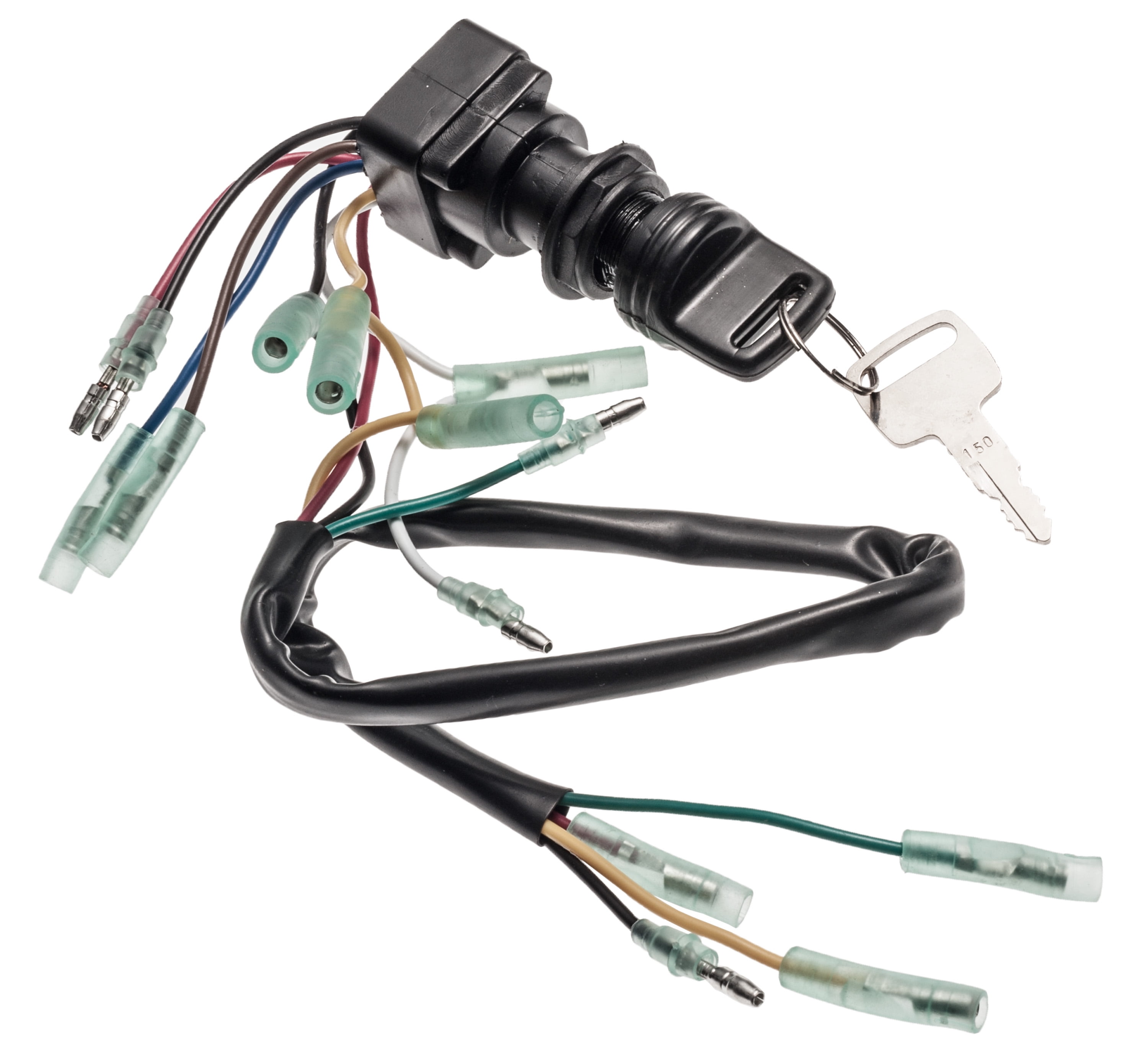

So, we can solve this a few ways. One is with an aftermarket key switch for Yamaha, and just splice the wires to the connector for the current switch,
Something like this is bound to work:
