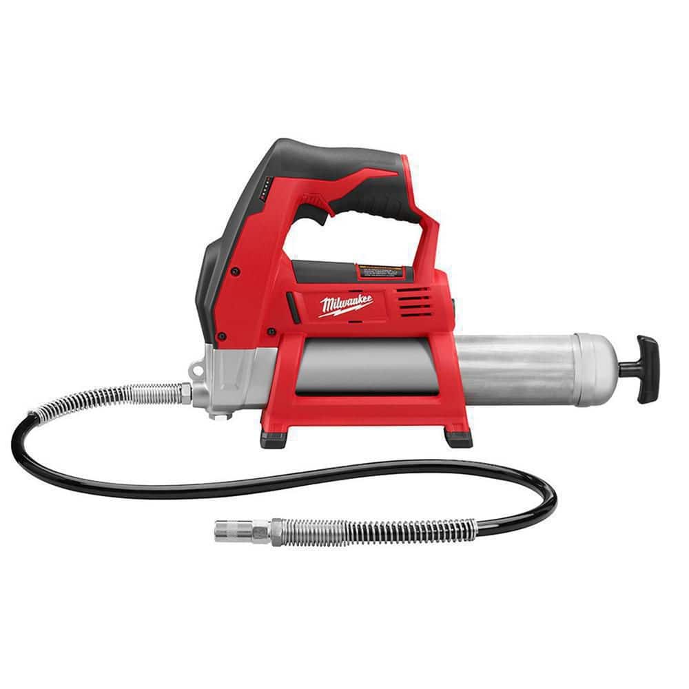

Don't forget the grease gun!

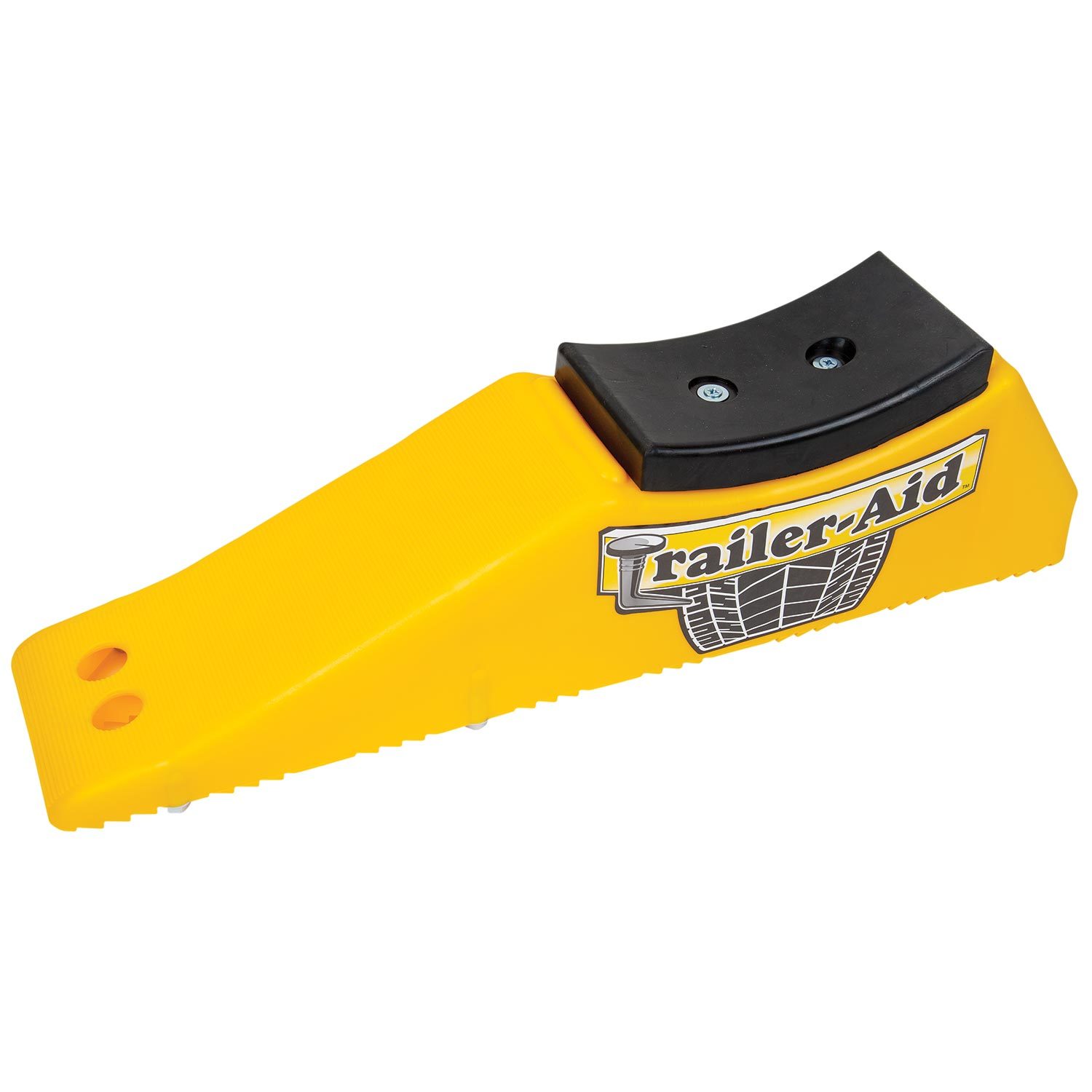

This trailer aid...beats having to jack. Went to my local west marine and found it for 26 bucks. Waaay cheaper than amazon or anywhere else that I've found.

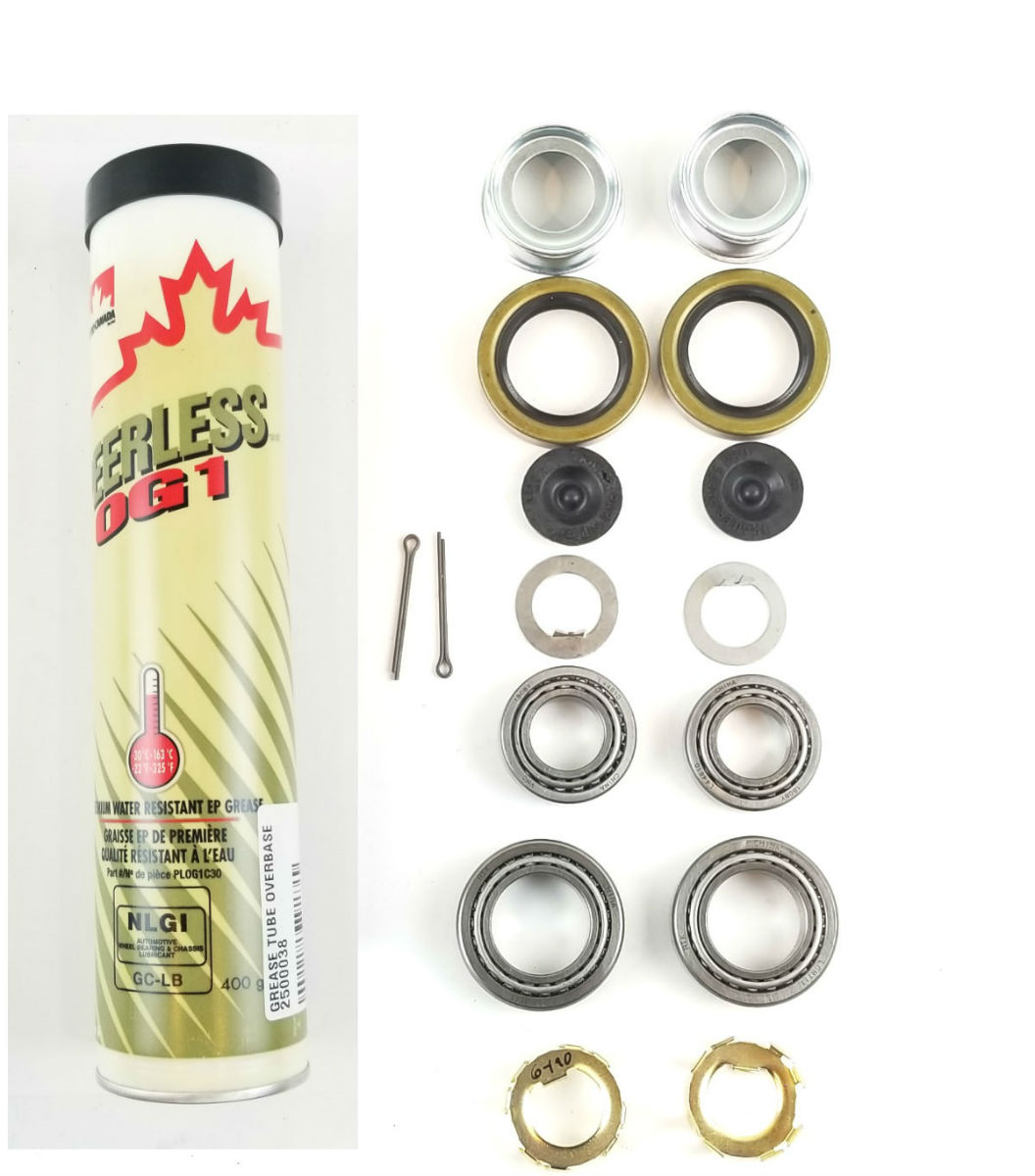

Bought a bearing kit for 1 axle from Hanna RV. Emailed them and they responded super quick and were really helpful. The kit includes bearings, seals, etc for 1 complete axles plus a tube grease. Under $70 total and I hope I never have to open the package!
I like their website, they have good Shorelandr support. I ordered a tube of wheel bearing grease (that you ordered) and it took over 2 months to get it. When I got the grease, the cap had fallen off and grease was everywhere. They gave me a refund based on the amount of grease I believed to be missing from the tube. Pretty cool.
