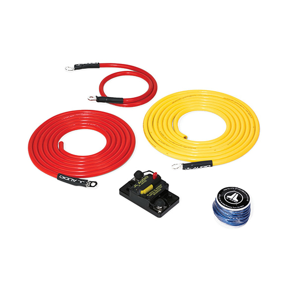

If your rear battery compartment is located on the port side, like it is on the 212's, then I don't think so. I'm not sure where it is on 2020 AR240's. Probably need closer to 20 feet (15 at least) to make it from the helm compartment to the aft port compartment.

6AWG is likely not large enough, 10ft is likely not long enough, 50amp is likely not enough...... lots of variables here and you're not giving us a whole lot to work with. I would start by searching here; lots of valuable info

2020 AR240. Ended up buying 4AWG and 6’ RCA’s. Now I just need to figure out how to get the speaker wire to the amp.
