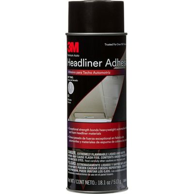

The headliners I have done the fabric was designed for headliners and had layer of foam attached to the fabric. Also, make sure you use good headliner glue, like 3M Headliner Adhesive.
