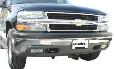

With each extension, linkage, you reduce your effective towing capacity and tongue weight. Not to mention the concerns with turning radius' and other pertinent clearances. I would not recommend the the double receiver hitch set up for those two KEY reasons. One thing to consider is a CURT Front mount receiver hitch. . . .http://www.carid.com/1988-chevy-ck-...1641881.html?gclid=CKfd0NC--L8CFc1i7Aod6mYAbQ
I have one on my 05' Expedition. . . . . which mounts in between the farm and the tow hooks. From a functionality perspective it would work for your application, but is also a GREAT way to park the boat in tight places.

have you looked into installing a receiver on the front of your truck? That's how I would do it when my son was younger and we went on camping trips with his cub scout pack. (I always got volunteered to tow the pack trailer).
http://www.etrailer.com/fmr-2009_Chevrolet_Suburban.htm
I forgot about the front hitch alternative. These are on my tow vehicles and cost between $150 and $200 each. Self install is the way to go. They also make backing the boat into a spot a lot easier.

We had a front mount hitch system that was great for bikes on our motorhome
