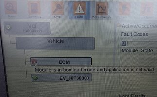

This is what I'm seeing in the FAULTS screen. That store message when hovering over ECM. Is the ECM supposed to show a green connection instead of red? Sorry for the grainy pic, it's sunny out even w the top over me. Popup when hovering over ECM is "module is in bootload mode and application is not valid".
Sorry, I've never used BUDS. It didn't exist when I bought Candoo. But somewhere in there there should be a way to reset fault codes.
