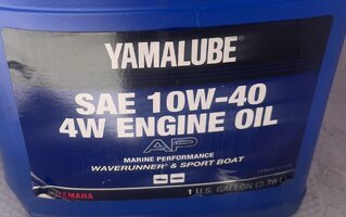

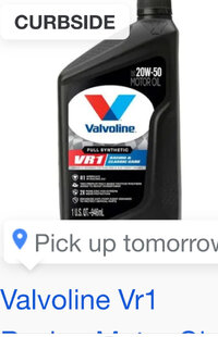

Using Yamalube now. What if I switch to a higher viscosity oil like the VR1 20-50? Just throwing it out there.
I’ve read online that in some cases higher viscosity oil leads to more consumption. So, go figure.
