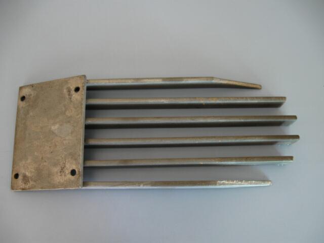

image-jpg.25961
Now, this is much different than sticks or debris, because with sticks or debris, the smaller the holes are, the more stuff can be deflected. Sea weed, however, won't get deflected, it'll simply wrap around the intake guard of whatever kind you make, and clog it up. So, if you used something like a grill grating, more sea weed will just get stuck on there instead of getting pushed through the pump at all. For sure you would want to have the "rungs" going in line with the boat so that it would have a possibility of sliding off. But I doubt it would work that way.
Many other pump manufacturers have finer intake grates.
Hamilton
Berkely
So you can see that the "big boys" of jets have a finer tooth comb in effect.
But again, I don't feel that will be effective for sea weed.
