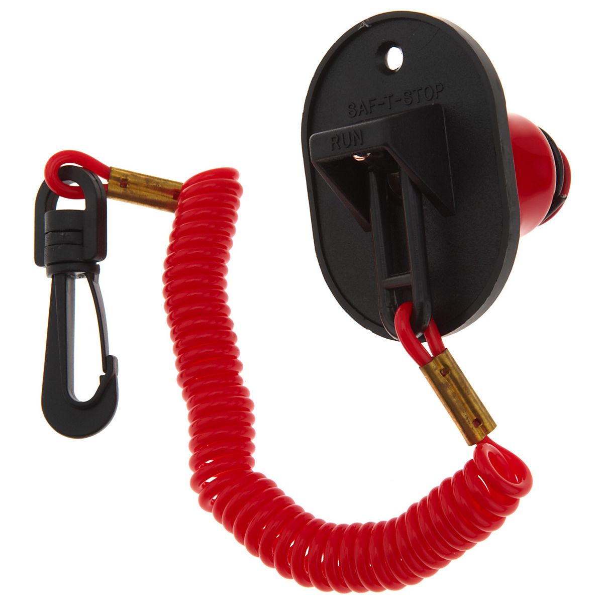

So, My kill switch failed for the second time. I was able to revive it last time it failed, but, alas, all things come to an end, and it was the end of the end.
I was highly intrigued by the FELL option, but the higher cost, larger hole required and a few bad reviews of reliability issues after some time (2-3 years of use) I decided to look at more low tech options. I purchased a Saf-T-Stop, like this one.
These things are very large and also require a very significant hole on the boat. It turns out I also bough the wrong model wired in reverse of what I needed, and I could not turn the switch around. So I 3d printed a replacement that allowed me to screw on the toggle switch from underneath, meaning no giant hole required, and I did not need to return the Saf-T-stop. It turns out the Saf-T-stop is just a 2 pole single throw switch with a fancy plastic shroud to trip it when you pull the lanyard.
It turns out this is a bit taller than I like, and I can rub against it when in full reverse...so I was toying with the idea of making my own replacement for the kill switch, in a similar design to the original. I think I have a decent prototype, will try to install over the weekend. I'll keep you posted.

It's been 3 weekends and so far so good. No complaints.
If you want to make your own version of this contraption, here are the files:
