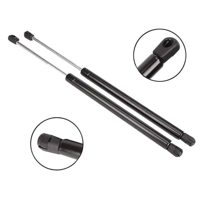

Anyone have a clue how to remove the old and rusty support/strut from the clean-out hatch?
I have purchased a replacement OEM part, but kind of baffled how to remove the old strut.
Thanks in advance.
Thanks in advance.
On the opposite side of the where the strut attaches to the pivot point there is a metal band that you need to stick a small screwdriver under, pry up, this will release the metal bands hold on the pivot point and now you can pull the strut off the pivot point. The bottom left picture in a circle show the side with the metal band and the top right picture in a circle shows the side that connects to the pivot point.
