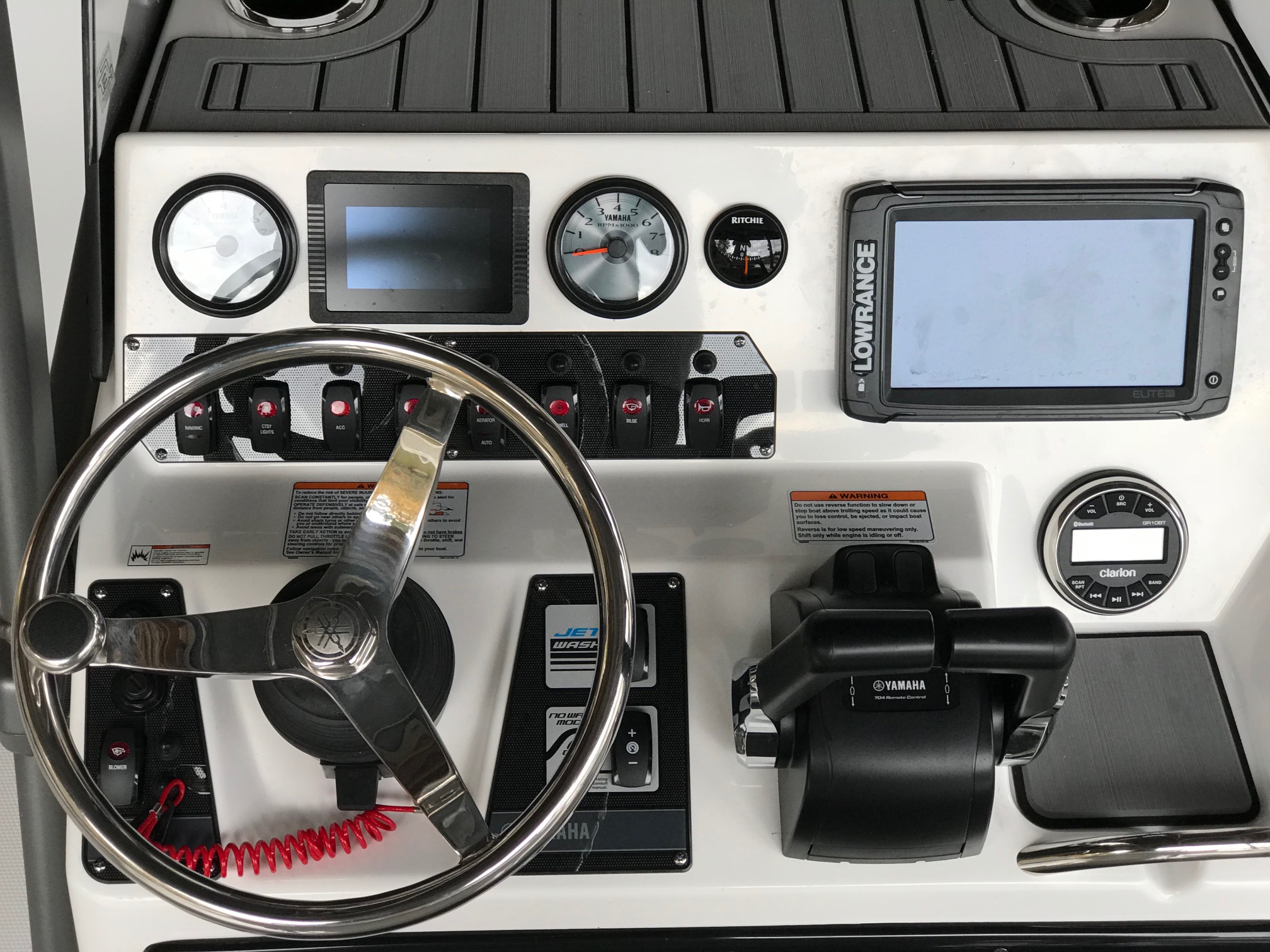

Has anyone put a GO9 orGO7 flush mount yet? is there room for a 12? FSH 21
Can somebody tell us? I was thinking of 12 inch garmin
I have a GO7 flush mounted, can grab a picture later if you'd like. I took the measurement to see if a 12 would fit and it would be really tight, if not possible. I wanted to go with a 9 but I had the GO7 on another boat so decided to just use that one.

That Lowrance looks great!
You're going to like that Go9. I can't imagine boating without one or a similar unit. And yeah, I considered the 12" for a couple seconds, then came to my senses and realized as amazing as they are, that's a cr@pload of money for a few more inches!

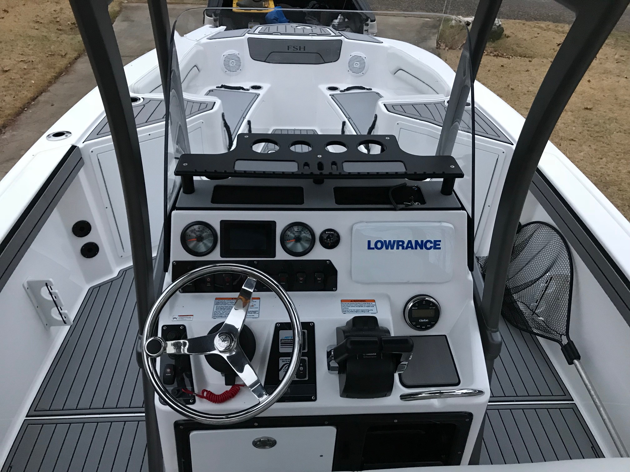

I think i will remove compass and replace it with clarion radio
Then i install vhf radio in same hole of clarion radio
I dont need compass

I saw a EVO2 for the same price new it just came down to $1,299 but no transducer. "International Marine" I thought long and hard about it. I ordered the GO9 complete package with the Totalscan and the 4G radar. I figured later on I could get a EVO2 or 3 and use that for sonar and just use the go9 for chart plotting and radar, and i would have a backup. Has anyone put a hard box up in the T-Top?
