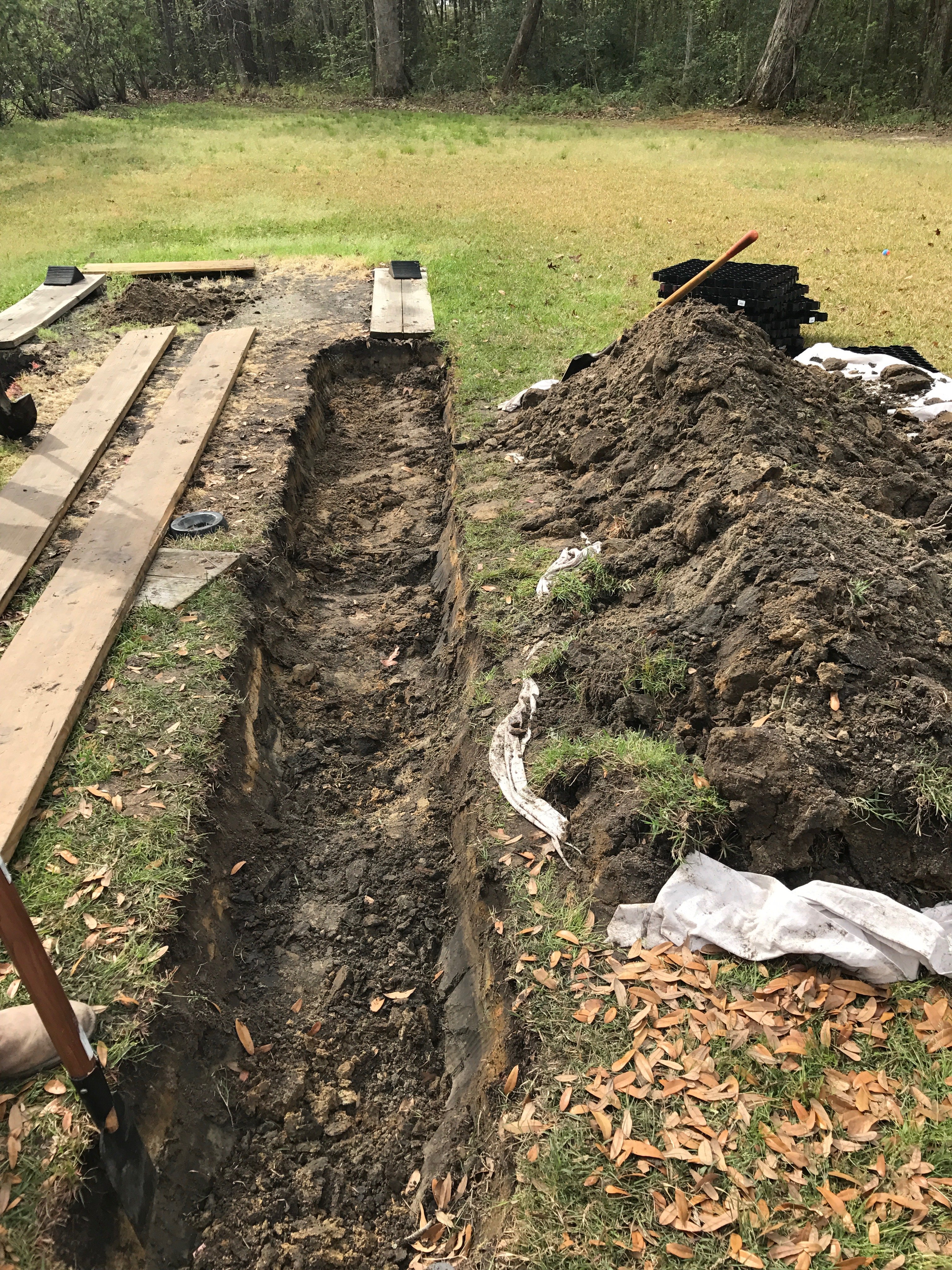

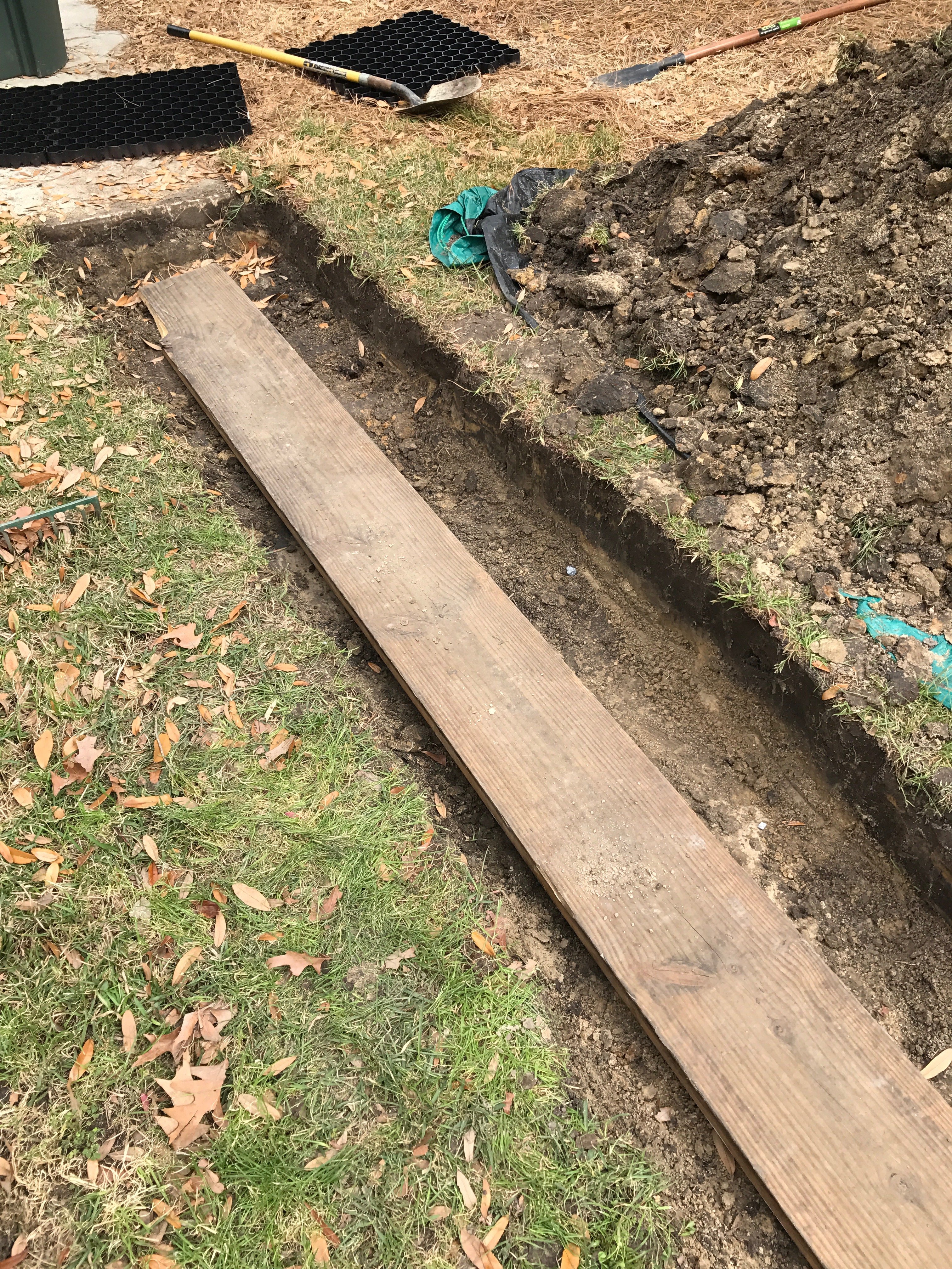

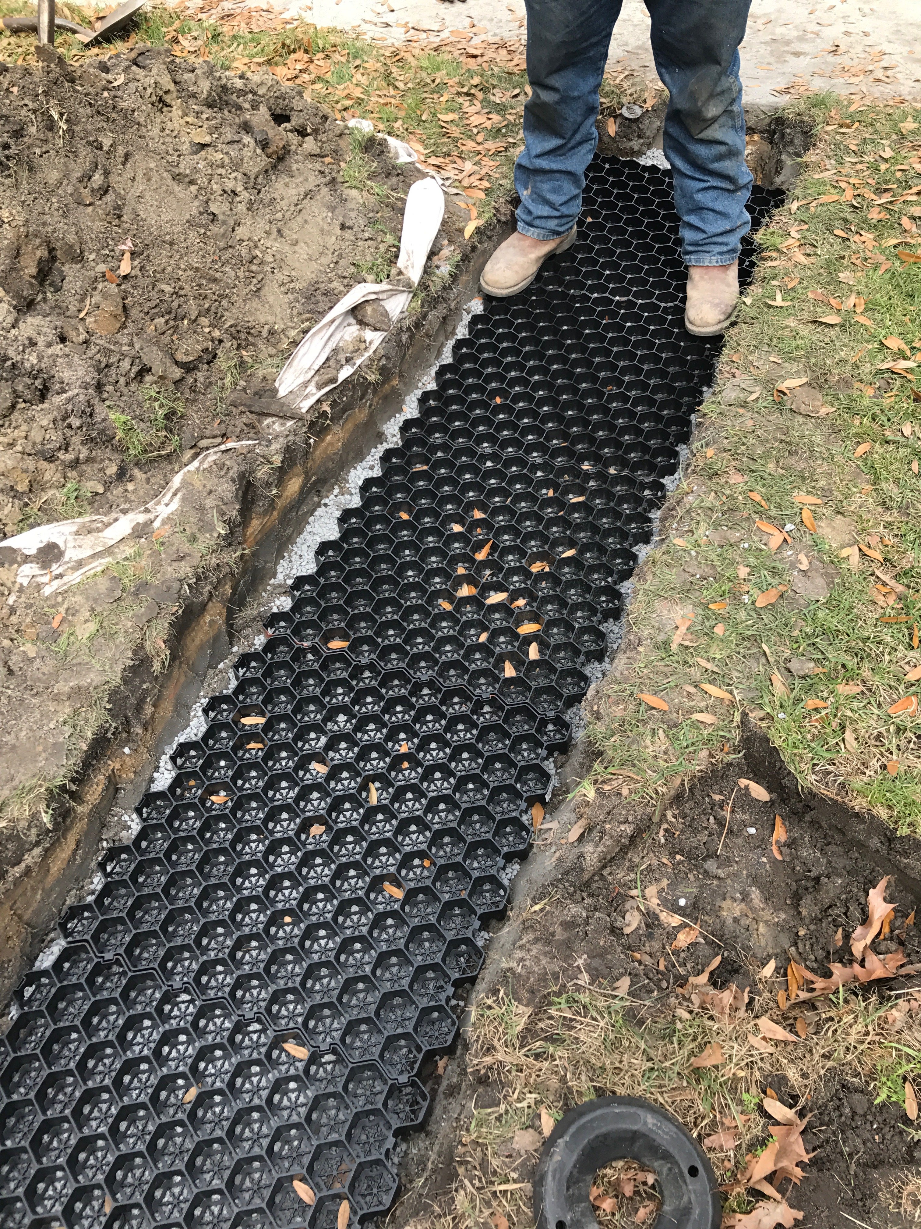

It took me a while to get around to getting these put in. Thankfully one of my guys at work has two strong high school students looking for money and willing to sling a shovel. It took 3.5 hours with my help. (I'm literally in the Jacuzzi at this very moment lamenting the decision to help.)
Once the sod roots and the grass comes back to life, I should be good to go for many years to come.
