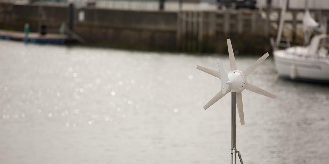

This solar power kit is amazing because it combines the power generation capabilities of a wind turbine with the sun-catching skills of a solar panel. With such a wide range of operations, this kit can offer the user with a virtually constant source of electricity. It's ideal for traveling to places that aren't as windy but receive a lot of sun, or vice versa.
