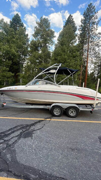

I picked this boat up this fall. Time to upgrade over our 1992 18’ I/O. Got it for $7500 as it sits in the photo. It was a rental boat on Lake Tahoe. Overall pretty good shape. Not major hull damage, a few cushions that need recovered, needs new teek floor cover but floats and runs. Got YDS to check it out.

Probably no wake shaper as a SX230 didn't come from the factory with a tower. Looks aftermarket.
No sure what a wake shaper has to do with a tower. I agree the SX230 did not come with a tower but this is a Yamaha stock tower. Not sure if the boat was miss identified as a SX230 and should be an AR230. I need to verify with VIN if someone knows how to verify.
You'll have to call Yamaha with your HIN number and find out the model. Most sites that use a HIN look up, like the one below only give you model year and date of build etc but not a model number.
