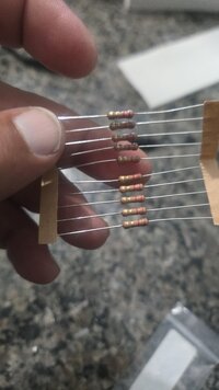

@mohammad Can you tell us where you got the replacement resistor from?
Terry Pittman
3
4
42
Thank you so much for your post. I had the same error code 76 and I used your post to fix it. It only cost me .07 cents. I had to order 100 of them so it really cost me $7. But I did remove the old heat shrink and cut the old resistor out and soldered and new one in and replaced the heat shrink. I took the boat out today and the error was cleared and the no wake and cruise worked great.
