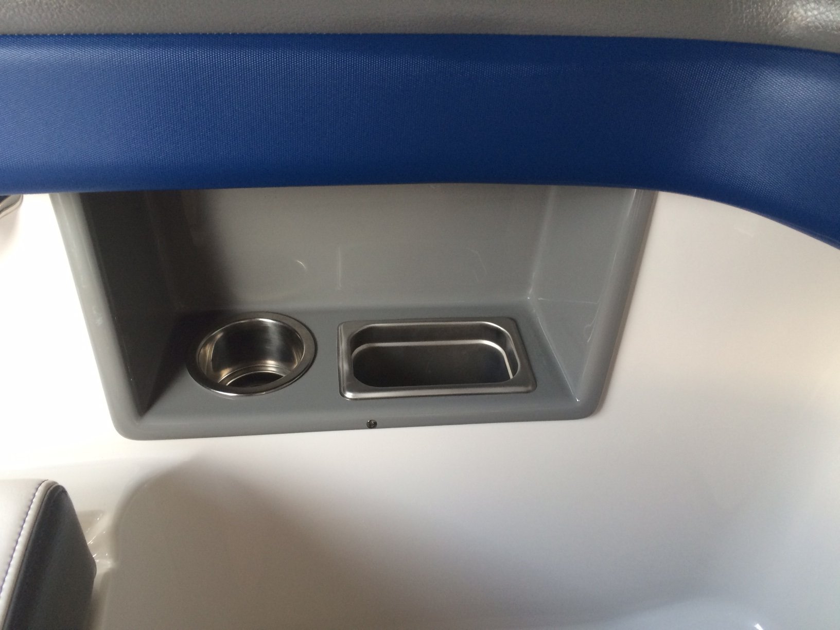

(1) For the useless space to the right of the cupholder on the port side. I cut in, and added a SS pan for the cell phone, car keys, sun-block, etc. It was just a food prep warming pan. The size is "1/9". E-bay $10-12.

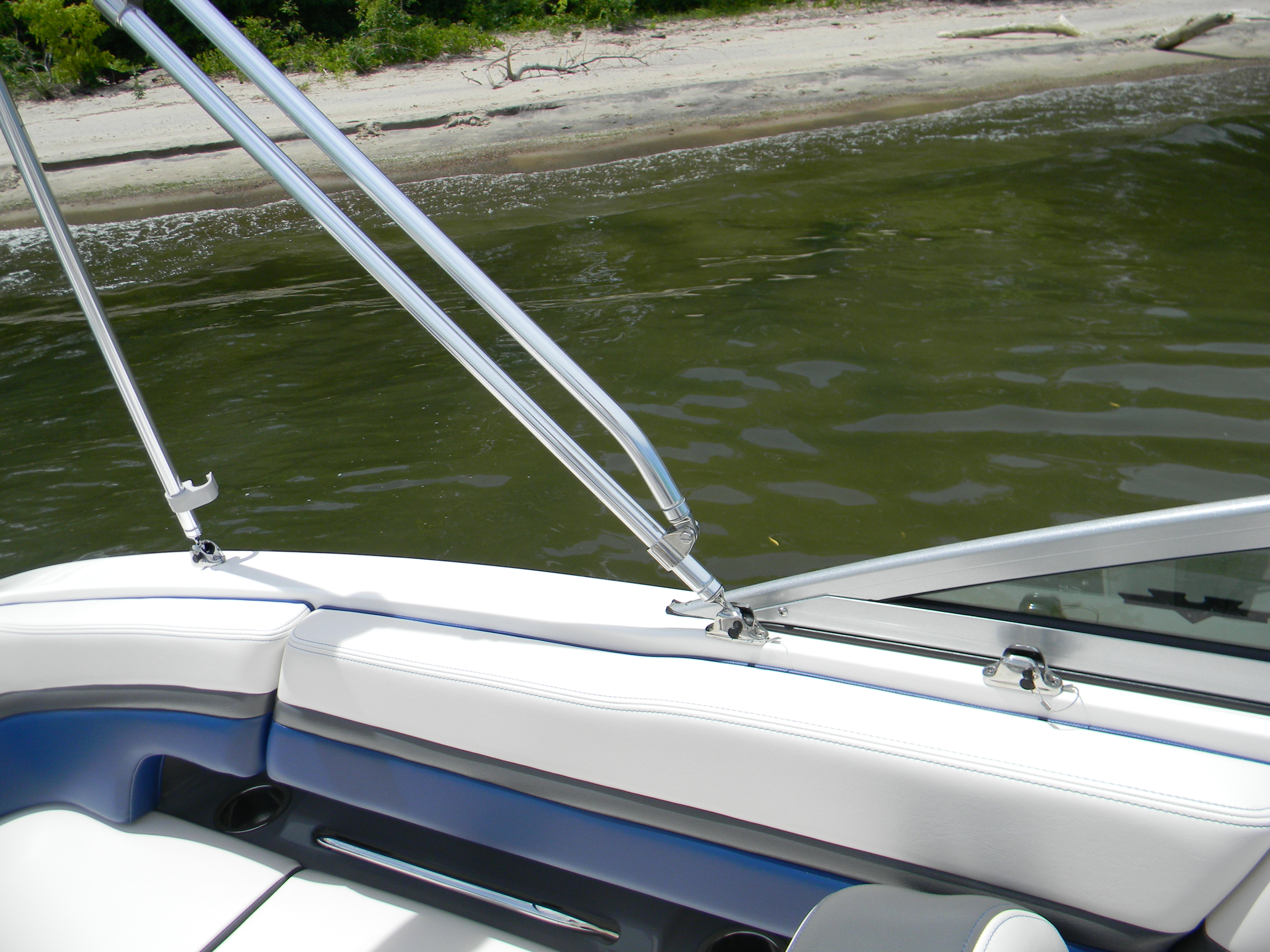

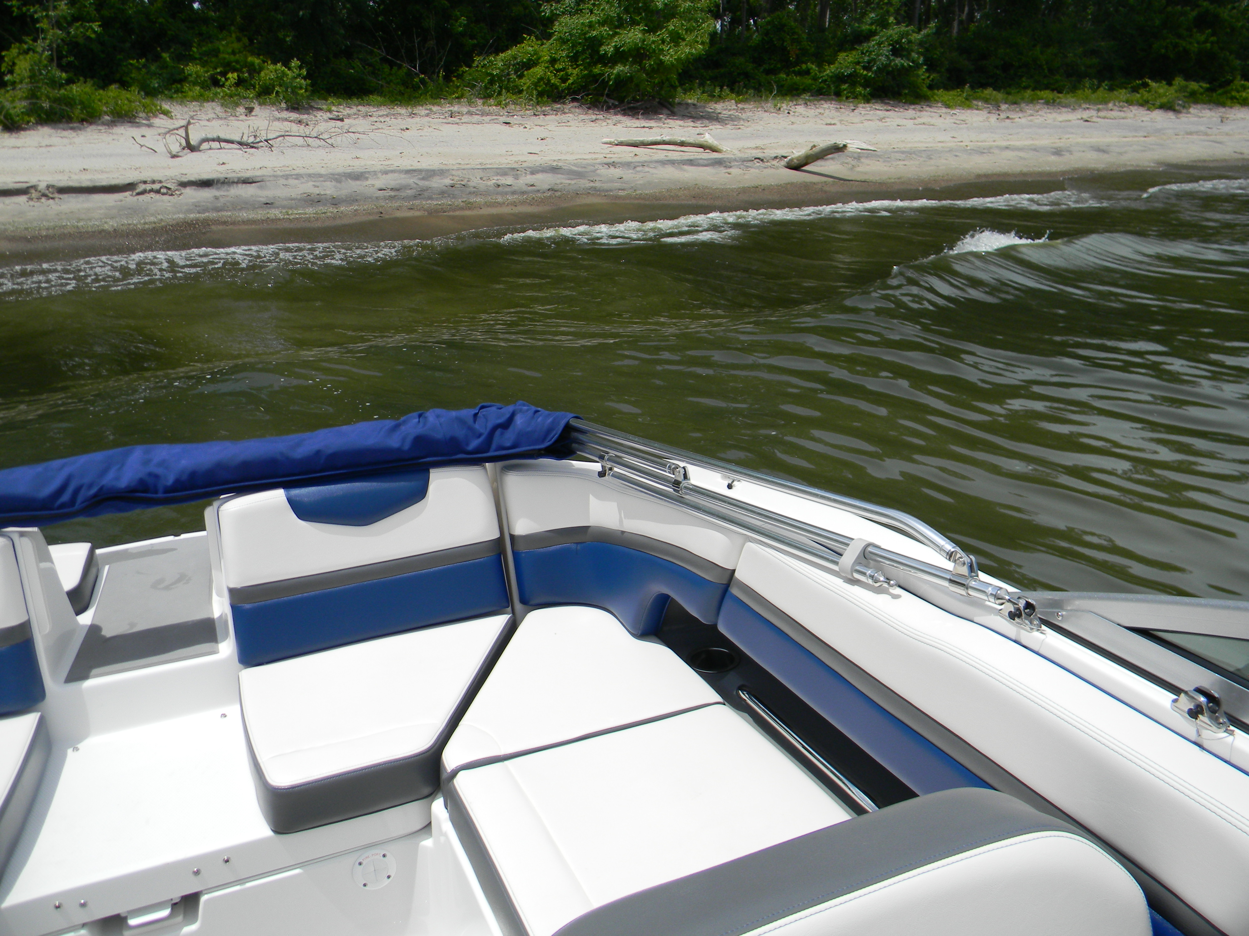

(2) I added a second set of bimini mounting brackets. Previously, the original location left the bimini top just floating and bouncing in front of the seats, which caused binding on the gelcoat and brackets. I didn't want to bother with patching the holes from the originals, so I just purchased another pair ($25-30) and added them about 5-6 inches back from the originals. This now allows the Bimini top (when down) to rest nicely on the area between the seats. Some days, we don't even put the bimini top up, which was impossible before. It also allows the Bimini to set on the windshield when I put on the mooring cover.

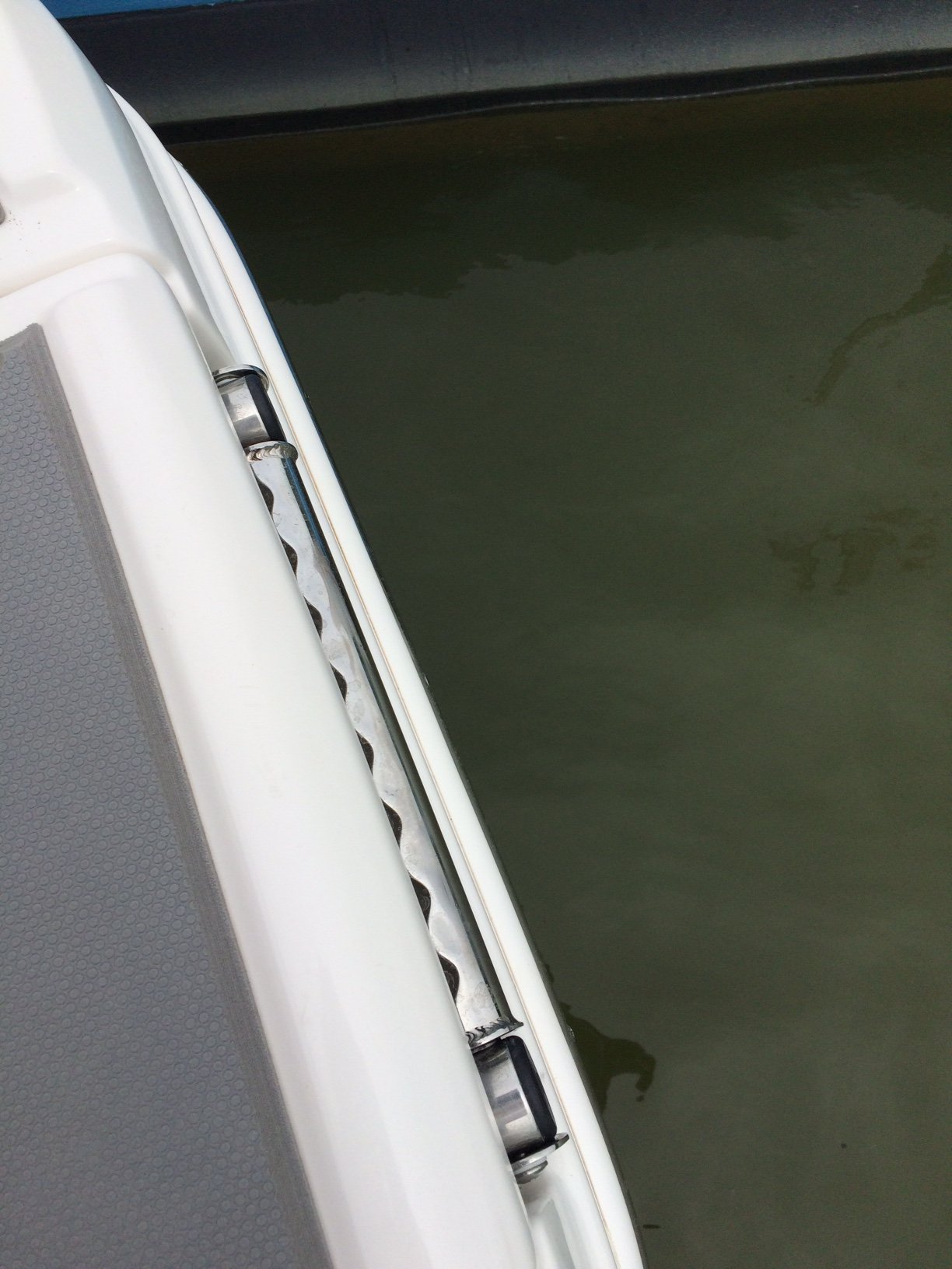

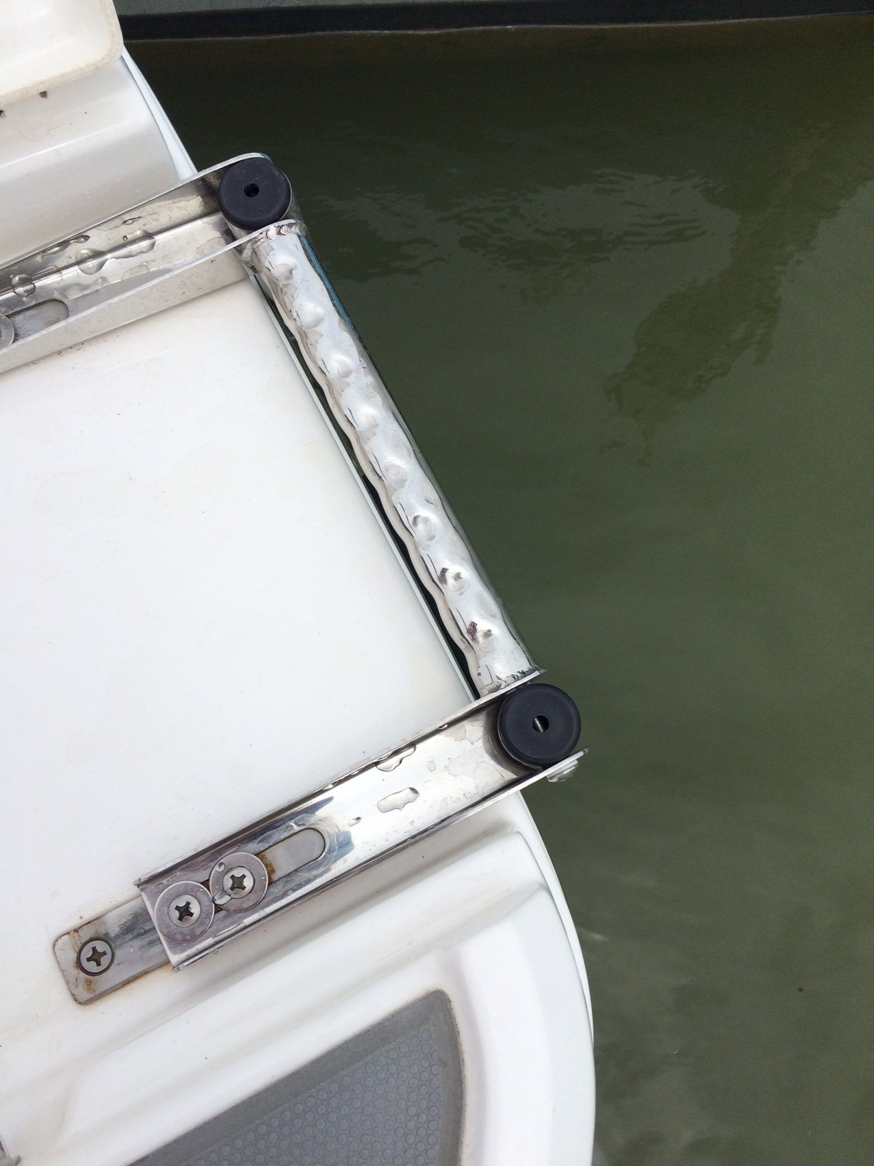

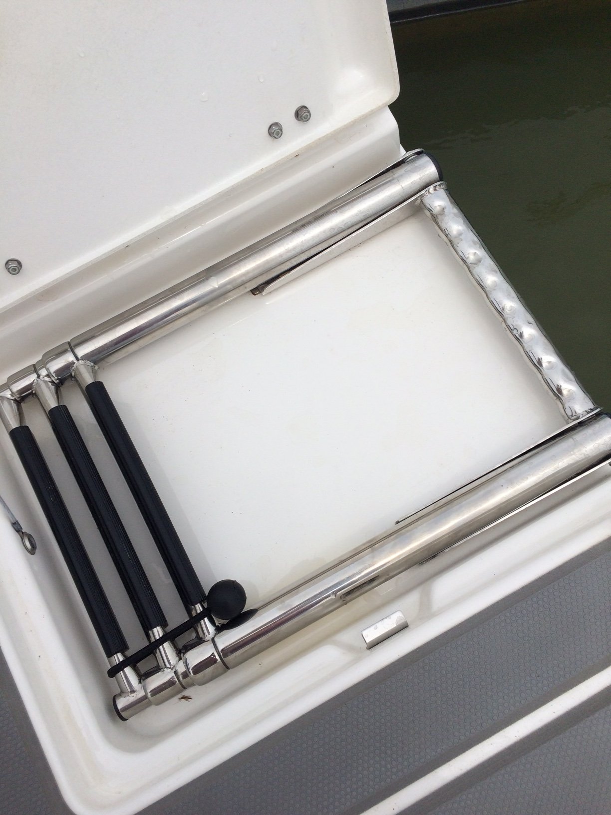

(3) Ladder modification. I was not a fan of the ladder protruding so far off the swim platform. We often hang out there with our feet in the water and it would likely get in the way. So when I ordered the boat, I specifically asked the dealer to provide the ladder "loose" and not mounted. I took it to a buddy of mine and had him machine some slots in place of the mounting holes. I used some nylon spacers and SS screws/washers to re-mount it. Now it slides flush when not in use, but extends perfectly when needed. The lid works just the same whether if in or out positions. I will admit, it was a challenge to install. I could have used a longer arm to reach all the way back into the recess to hold the nuts/washers when installing. About $25 labor & hardware.

Nice job. I really like #1. Question for you. Was there anything hidden in that area when you made the cut i.e. speaker wires, power cables to amp, etc...
Yes, there were some wires there, down below, but I didn't pay attention to what they were. They were in no way hindering adding the pan. I initially looked to just adding a second cup holder, so I removed the entire box (three screws), then figured a small pan would fit cell phones better.
To remove the grey box, you kind of have to raise up the existing cup holder and then bend the box a little to clear the padding on the top. It is ABS so pretty flexible.
I cut the hole in the box at the workbench, reinstalled, then siliconed in the stainless pan after re-installing.
