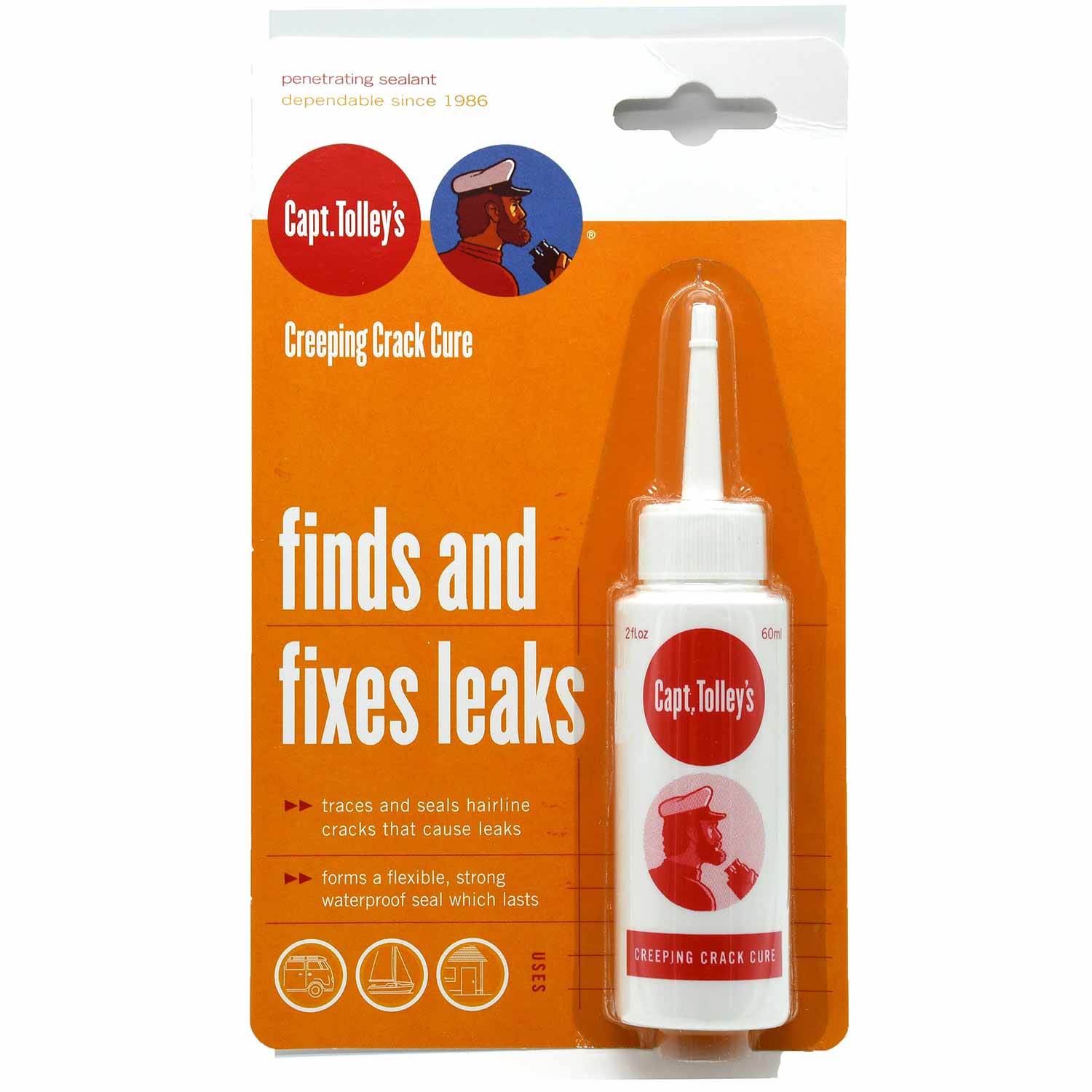

I would clean it up first and then re-evaluate. Those cracks look pretty bad. I think I would be inclined to seal it with something before laying down the SeaDeck. The SeaDeck is closed foam, but the problem is that you are installing it on a textured surface. Water can migrate from the edge under and to lots of spots under there. As it will be covered, I would not worry about needing to make the sealant very pretty. There are lots of cheap, non-color-matched 'gelcoat repair' products in tubes available...
