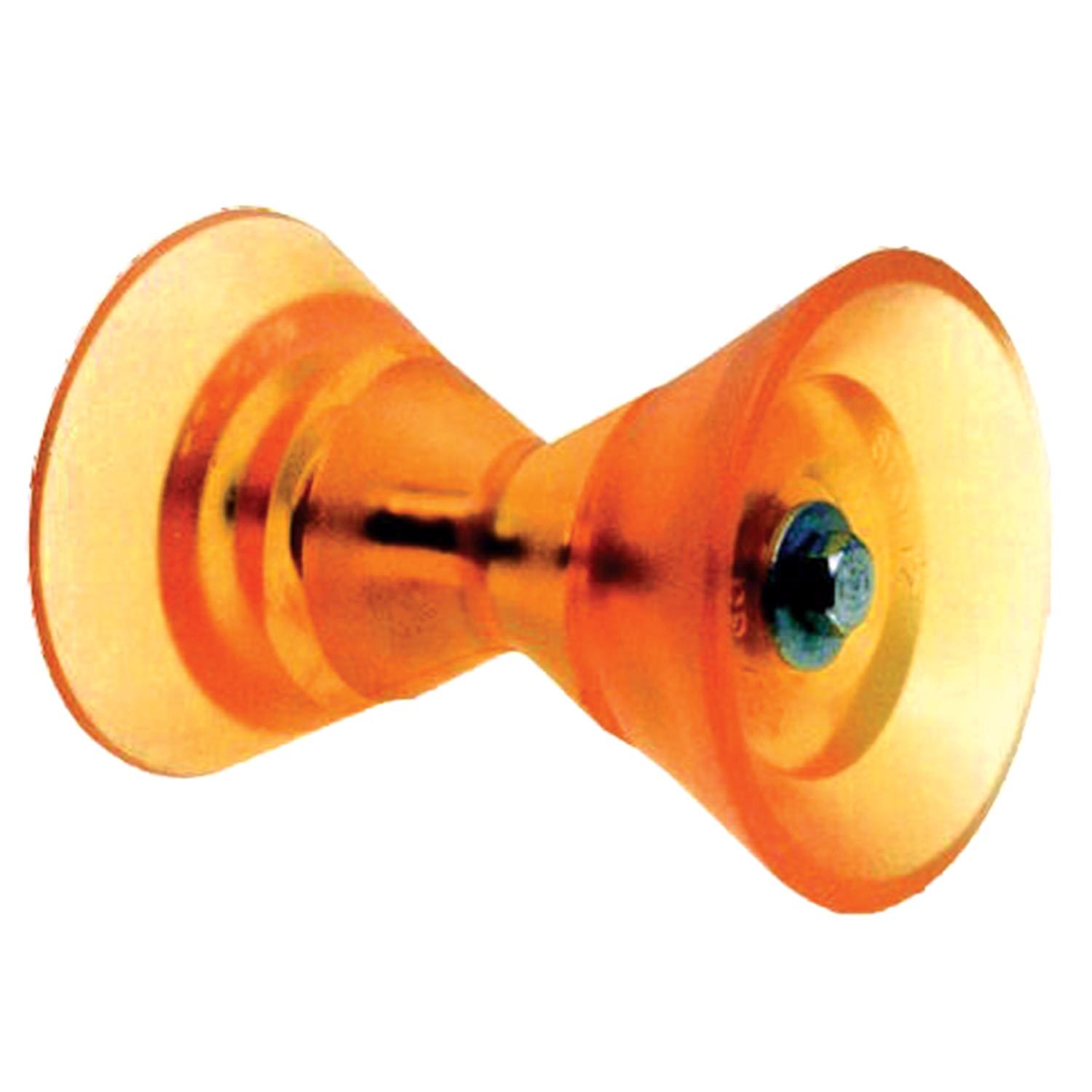

Any idea what size is needed for this trailer?

Is this the same as the bottom one? I can get it locally:

I measured the inside roller and it is 3 5/8", is it the same for you?

Yes, that's the same one.
The ULT-4 inside roller is more like 3-3/4" but it fits in there nice and snug--helps prevent the metal arms from poking past the roller and touching the bow.

does it still spin?

Mine does not spin freely on its own but I can make it spin if I twist it by hand and it does spin under the weight of the bow coming up on it when I load. I think the metal arms could also be pulled apart a little bit to give it more space, but I've never bothered trying. I erred on the side of a wider inner roller rather than a thinner inner roller (e.g. 3.5") because with thinner inner rollers I've seen where the metal arms can still come through and touch the bow.
