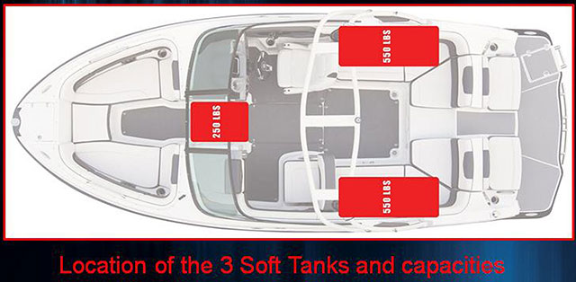

@blackhawkpilot Is this the ballast design in your boat?
I would be interested in buying or "borrowing" those bags off of you along with any plumbing, if you were thinking of getting rid of them.
I have about 2,000lbs capacity right now but will need way more for testing.

@swatski that looks right. The one that is midship takes up a big portion of the ski locker and I can't fit my son's wakeboard in it. I'll have to take a look at the system to see how to remove it.
