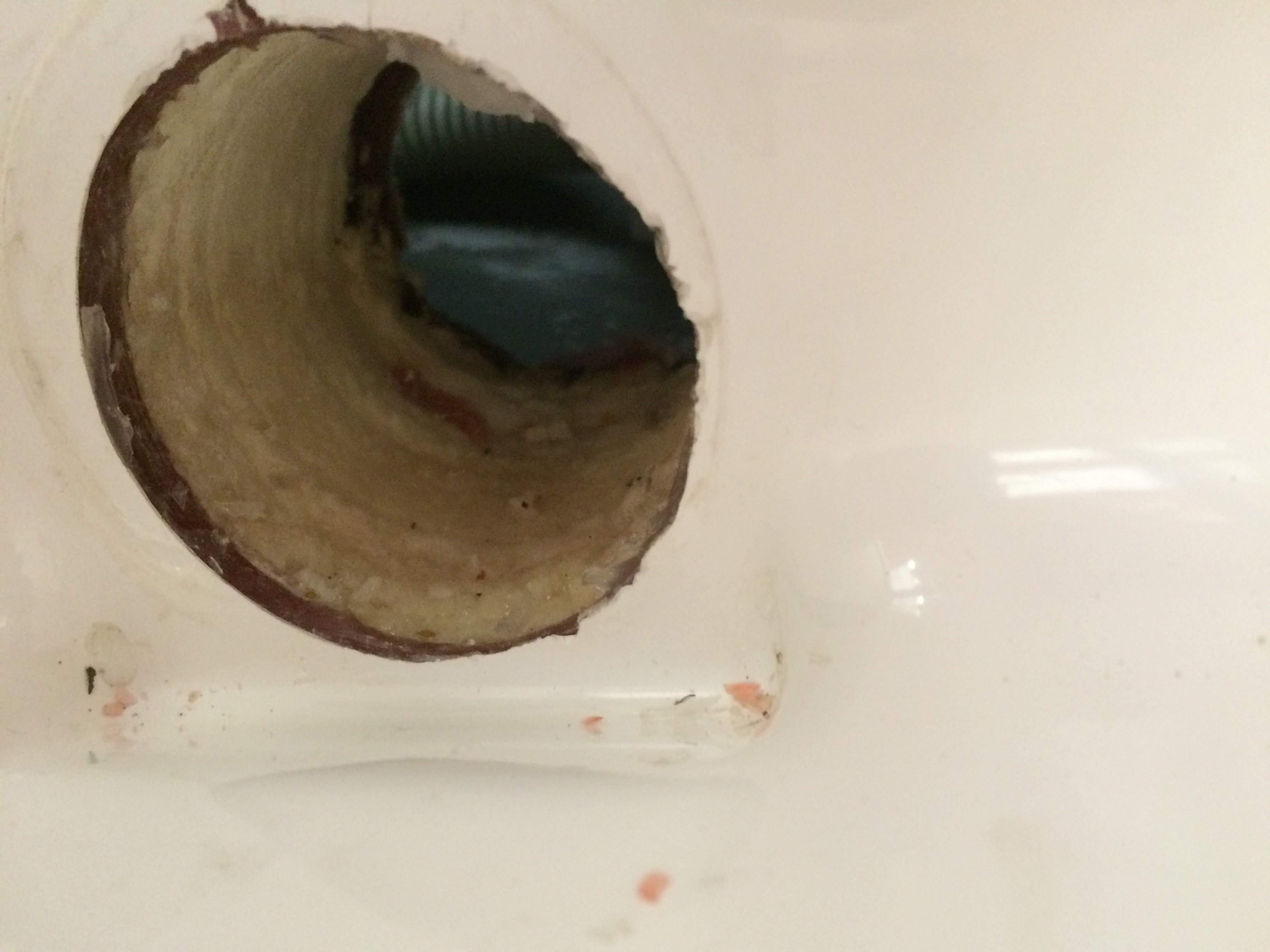

I've been lurking here and reading about the boat since I bought mine last month. The amount of water in the boat has been annoying to me. I could "almost" understand water in the bottom of the boat or head, but the amount of water under the port passenger seat storage compartment and battery box has really bugged me. Was in the water two days ago and left my shoes in that compartment....soaked. I didn't spend a lot of time cleaning the boat that day since I planned on going out yesterday, but when I came home I was scrubbing it to put it away in the garage. After I clean it and put it away, I spend 15 minutes with a sponge pulling to left over water out of all the compartments. I had washed the fish locker with water and bleach and the water I was pulling out smelled like bleach so I took a look at the fish box... Found a hole under the drain that I can't believe Yamaha left. Pulled the thru hull fitting and found no sealant of any kind to even try and stop the water. Going to the dealership tomorrow to ask for a fix... Hope the pix work

An unrelated problem I have with this fitting as I was looking at it was, what keeps a standard size ice cube from leaving the box down the hose? When I get a fix its going to include a screen of some sort that will limit the discharge to only water... Sad that this leak soaks the boat with bloody fish water.

Have you used the fish locker in the front with ice? Can you put a picture of how your drain looks at the bottom of the locker? I was at the dealership today and they don't have any boats on the lot that I was able to look at. They are going to find a replacement that fits the hole completely. I will say that the boat is normally dry in the hull and I have yet to see the bilge pump come on. This leak is for sure the cause of the water in the compartment under the port passenger seat. I'm hopeful that it will also be the source of the water in the head.

That would be great I'd like to hear what your dealer is going to do. I dropped off the fitting and the pictures I took on Monday and still haven't received any information on how they intend to repair the hole. I also took Corey's advice and pulled the two drains from the deck in the head/changing room. I did find some silicon on the fittings, but not enough to stop water OR hold them in place after the two screws were removed. Seemed like inferior silicon to me, I tried to pull my shower door that had been installed 15 years, in my house bathroom, and had a harder time getting the silicon off. Going out tomorrow....without the fish locker and I put a plug in the hose to the overboard drain...just in case the one way valve....ain't so one way

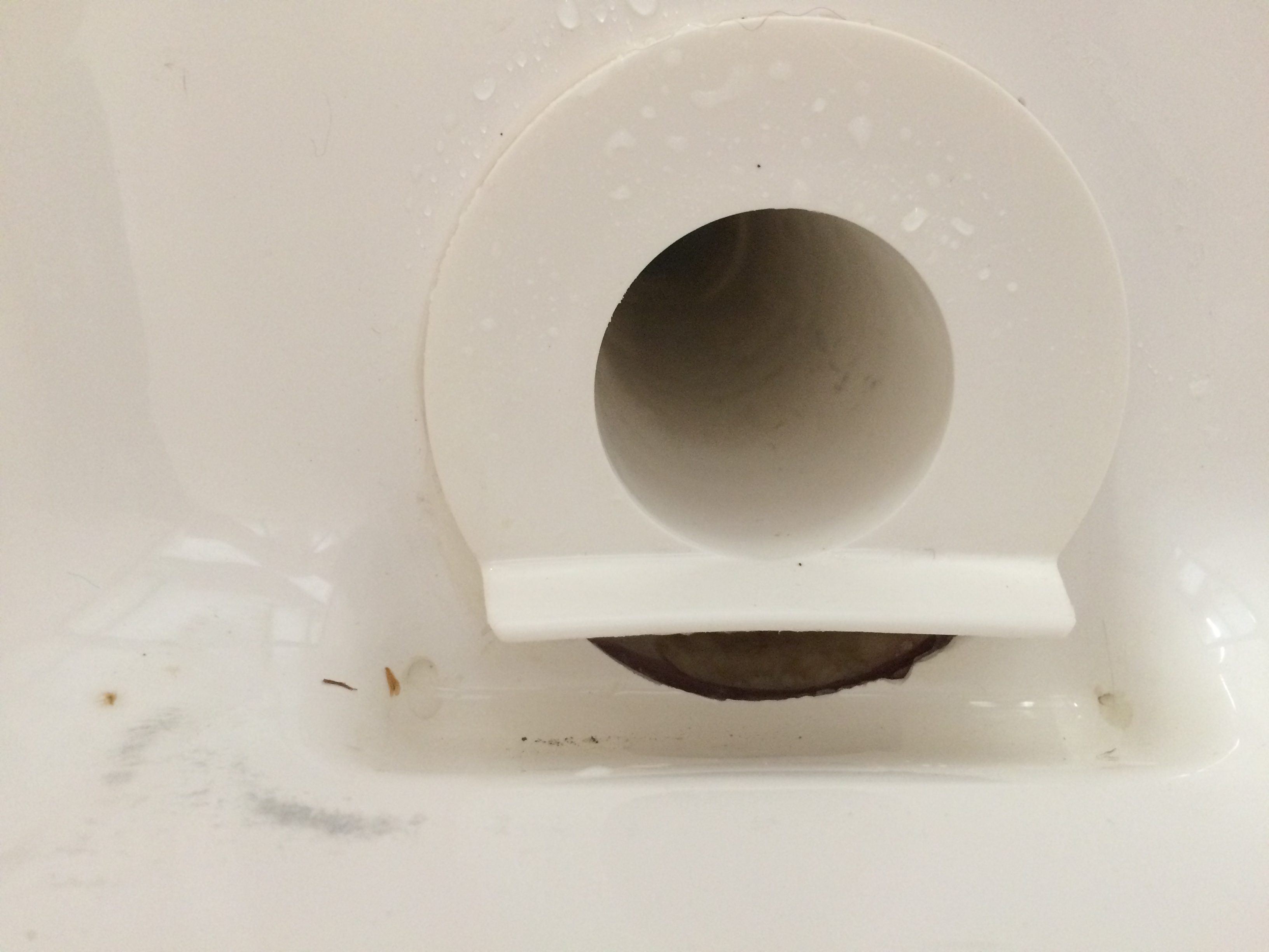

This is the other side of the fish box drain. When I put water in the fish box to see if any went to the port storage I didn't really get any back there. The front of my drain looks just like the others, half ass silicone job.20160720_183238.jpg

I think the anchor locker drain is leaking also, maybe in between the anchor locker and the hull. This is the finish to my anchor locker drain. The anchor locker can get quite a bit of water in it at slow speed with a couple people up front since the drain is under water.20160720_190850.jpg
