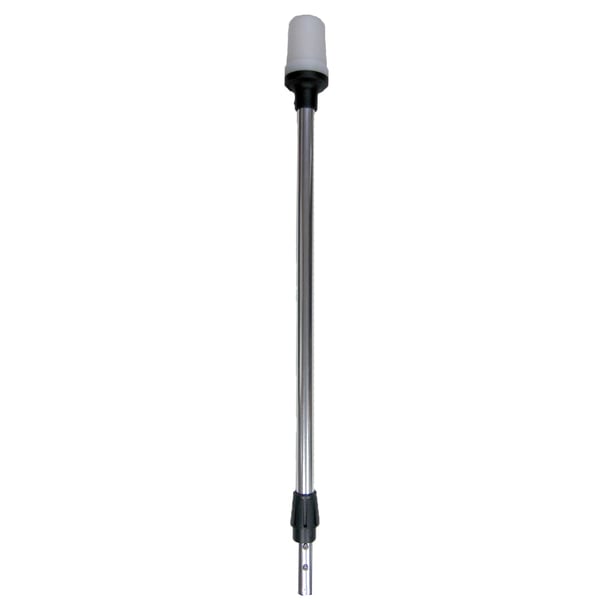

The 2005 had rubber mounts that held the stern light inside one of the rear storage areas. Its possible the light pole is still clamped in there. I had to replace mine a couple times and it was a standard pole stern light like the one below. 3' to 4' is all ya need.
Light pole bases if you needed....
I looked and did not find my original in my garage. I upgraded to a telescoping LED light pole long ago.
Bruce makes a good point in upgrading to an LED. Incandescent bulbs are prone to their filament breaking when knocked around. Thats 100% of what was wrong with mine a lot. As long as the pole base looks like the one we have posted, you are good to go.

The Partzilla pics looks like it is foldable. If so, this appears to be similar if not the same for 1/2 price:
Amazon - Attwood Folding 54" Anchor Light
Anyone confirm this looks familiar?
Not that it makes a huge difference but the tip of that light pole looks to be intended for an angled installation while I believe yours is vertical.
I would give this $30 option consideration. If it fits the socket great. If not it is two screws and two wires to install the included base.

Update - I found a folding anchor light on amazing and it appears to be long enough and works fine. It was an attwood brand light.
