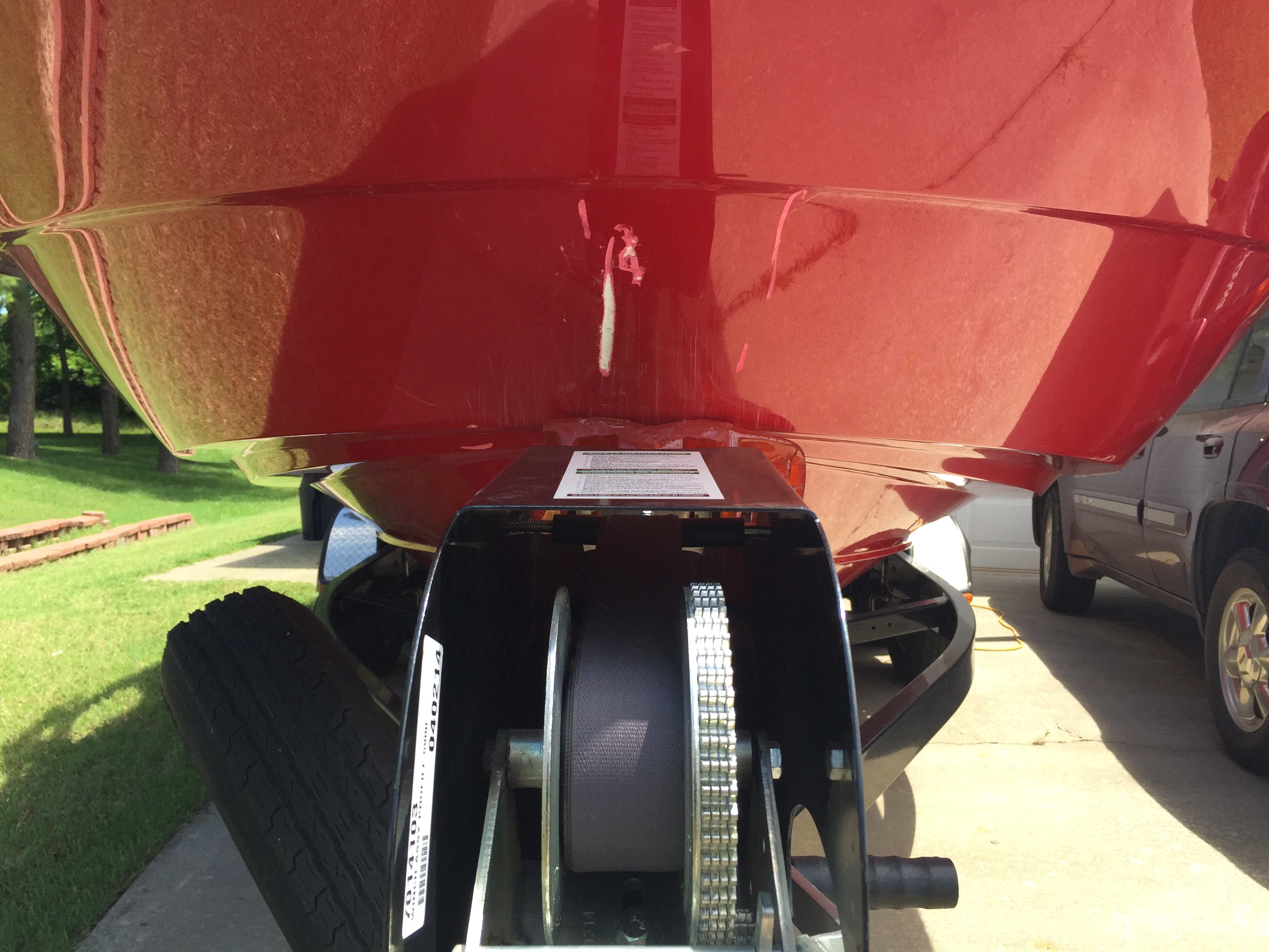

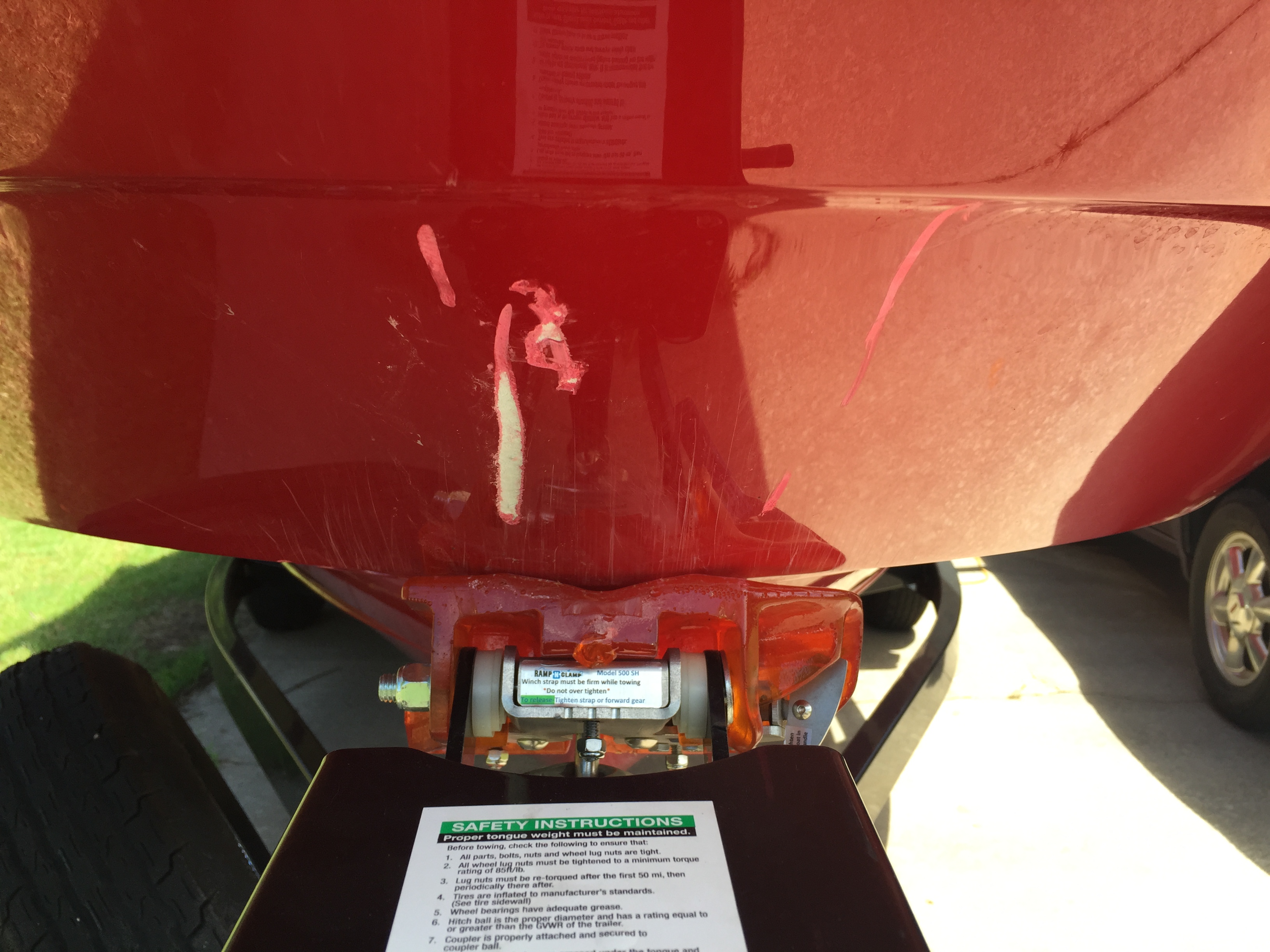

well, guess Ill put up some photos of a repair.... I GOUGED the shit out of my gelcoat this weekend. Ramp and Clamp flipped straight down, got my bow horribly.
I want to state up front, I am not slamming Ramp n Clamp in the slightest. I think its more of an issue with bow shape and trailer than Ramp n Clamp design. I am posting this so others with the same bow boat don't learn the hard way!
2014 242 LS boats have a "step" on the bow that I thought might be an issue because the top of the Ramp n Clamp sat a bit odd when the bow eye was engaged. When I installed and tested, the trailer was sitting almost level because the lake level was so high and it worked fine. I make 4 or 5 load and unloads because I was concerned, went fine. This weekend on a normal ramp, with more trailer angle, I eased up, felt boat touch on ramp n clamp, barely hit the throttles, and heard/felt something that definitely didn't sound right! went up front, clamp was straight down, and upper arm got the boat big time!

I want to state very clearly, I am not condemning Ramp N Clamp!
I do think, just like anything else, if you do it right, it will work right, ie. Shallow trailer depth loading so the bunks force the boat to be centered, then back trailer with light thrust from boat so it mates up. As far as the pin size, I have to work in a field with a lot of sheer force being calculated, it doesn't concern me too much because the rating on the Clamp is FAR in excess what it will have to cope with just holding the boat on the trailer pulling out.... you only need to hold a few hundred pounds of force unless you try to drag race up the ramp lol.
That being said, there is a VERY clear, and VERY real issue with the exact bow shape on 242 boats! Look at my pics, everything is lined up perfectly, but part of the Ramp N Clamp is on the bow "shelf" and part on the dead rise. There is NO way this is correct or as intended. I blame myself to be brutally honest. I saw this. I fully ignored it. I knew in the back of my mind there could be a problem. I paid the price. its that simple.
I haven't contacted Ramp N Clamp demanding anything, and I wont. I DO think its a DAMN good product when used properly and with a proper fit on the bow. Hell, after it gouged my boat, I pulled it back up into position, used the winch, is snapped on the bow eye perfectly and solidly. I did have to hold it at the proper angle because the bow shelf hit it again and knocked it down. No it wasn't loose and flopping, no it wasn't stiff as hell, took some effort to hold it. Its a shape of bow vs design of Ramp N Clamp issue.

Greg M
101
63
147
Oklahoma
My device IS aligned as properly as the design allows it to be. And I don't slam up onto my trailer either. The issue in my case is the bow shape isn't linear on 13-14 242 LS boats. Note the pictures. If that's what you mean, ok, wrong boat shape, wont work, fine I'll agree. If you mean I just didn't install it right and/or didn't trailer right, then I disagree strongly.

look at the pics. adjusted the clamp with boat about 4 inches back, out of the water to set the height. again, look at the shelf on the bow line.
When the boat is coming in, the shelf hits the clamp, you would think if anything it would try to level it off, but it doesn't, the lower part of the clamp touches the boat first, pushing the clamp down, then the shelf touches and bonk, down it goes, clamp is vertical.
defend it all you want, I know what happened, I know the contact area and have the pics to prove it. Also look closely at the pics... see the smaller bolts (vertical) with lock nuts on them hanging down? Yeah, when the boat backed up it pulled them thru the poly.
I don't blame Ramp N Clamp. I stated that clearly and repeatedly. It is an issue with bow shape. Show me one 242 owner that has a Ramp N Clamp and no issues. until then, I'll hold my oppinion
