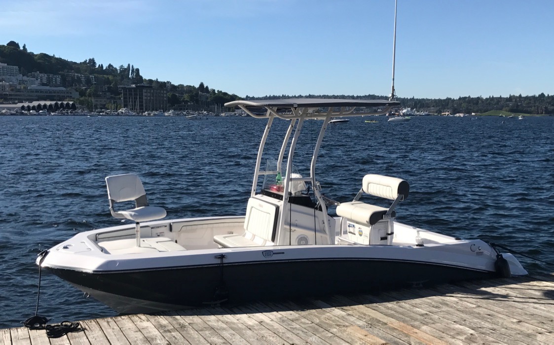

    Bow fishing chair installed

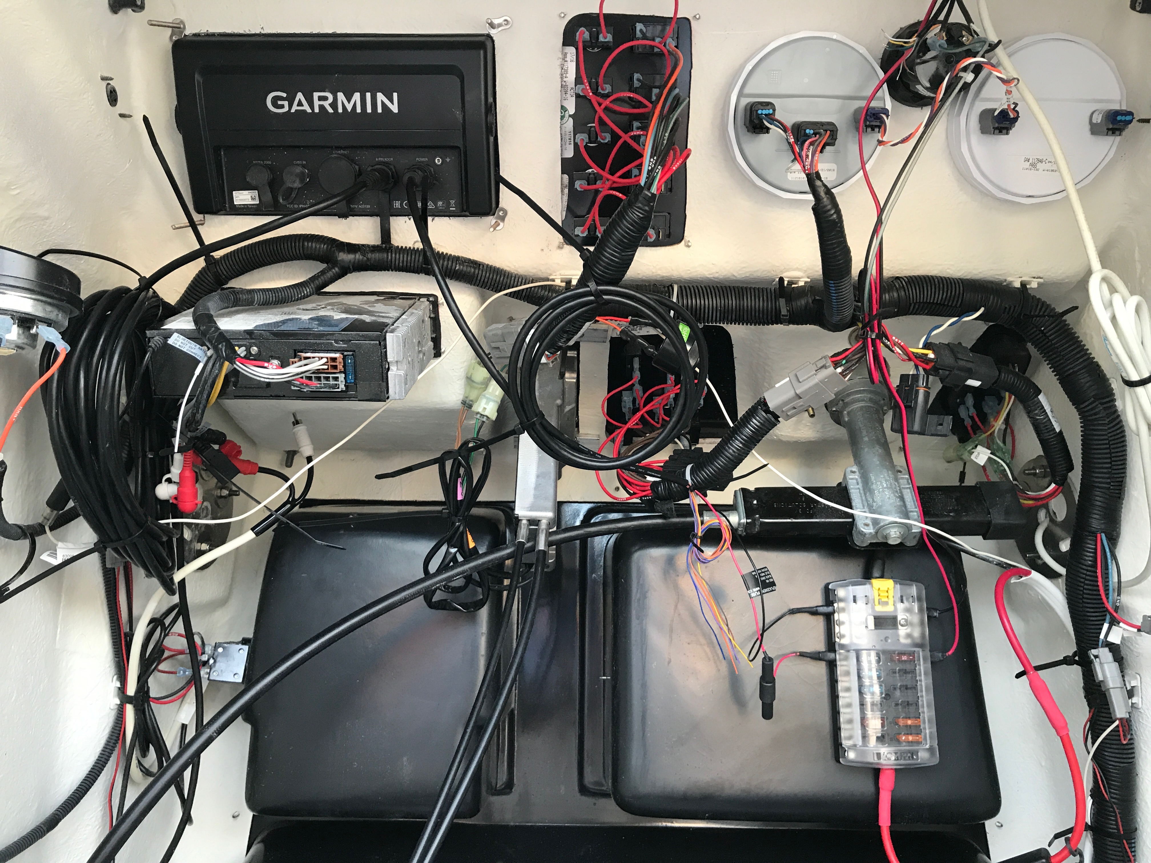

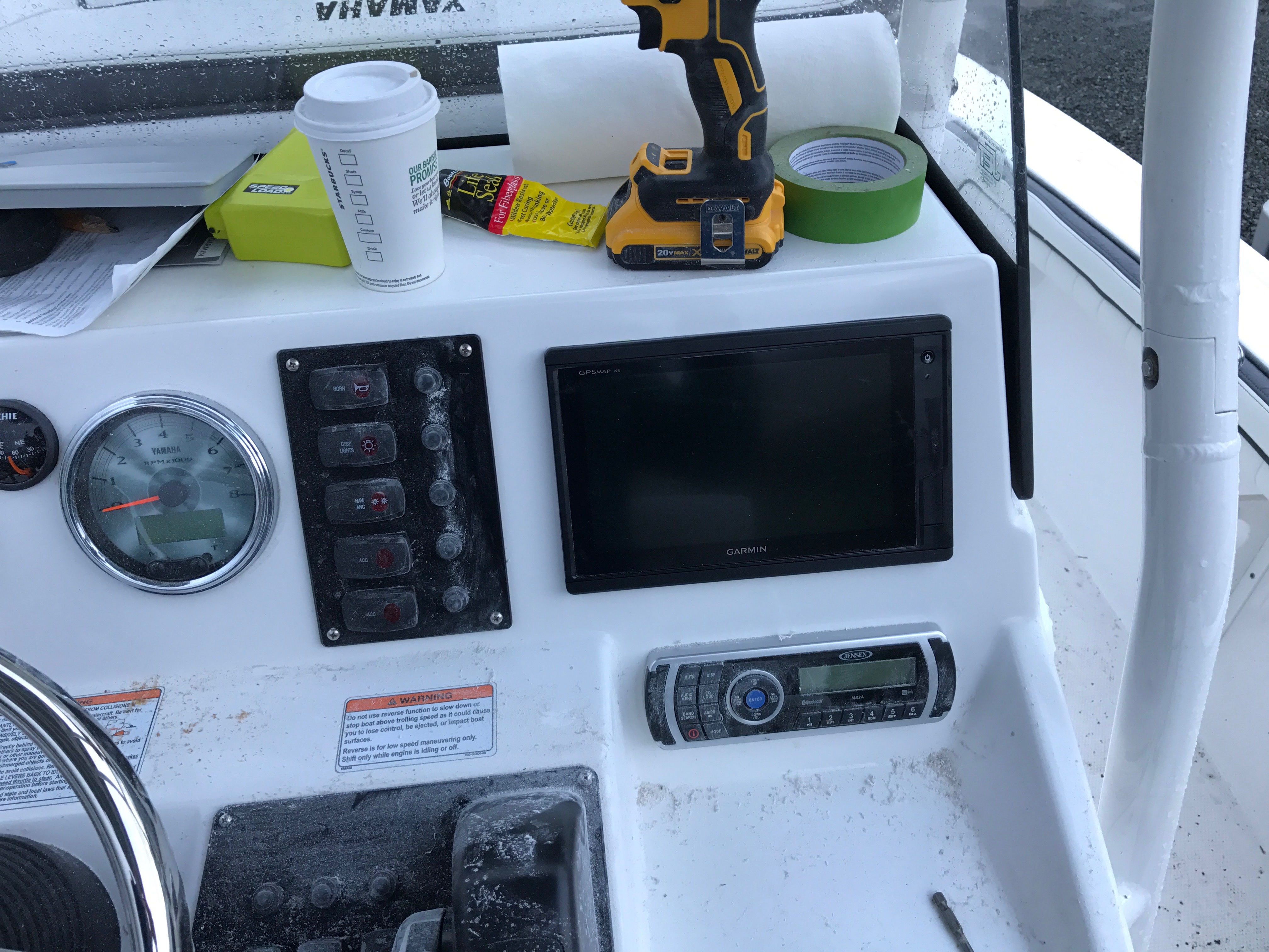

    Installed Garmin using rotary tool to cut the fiberglass ran wire to transducer below and power fuse block

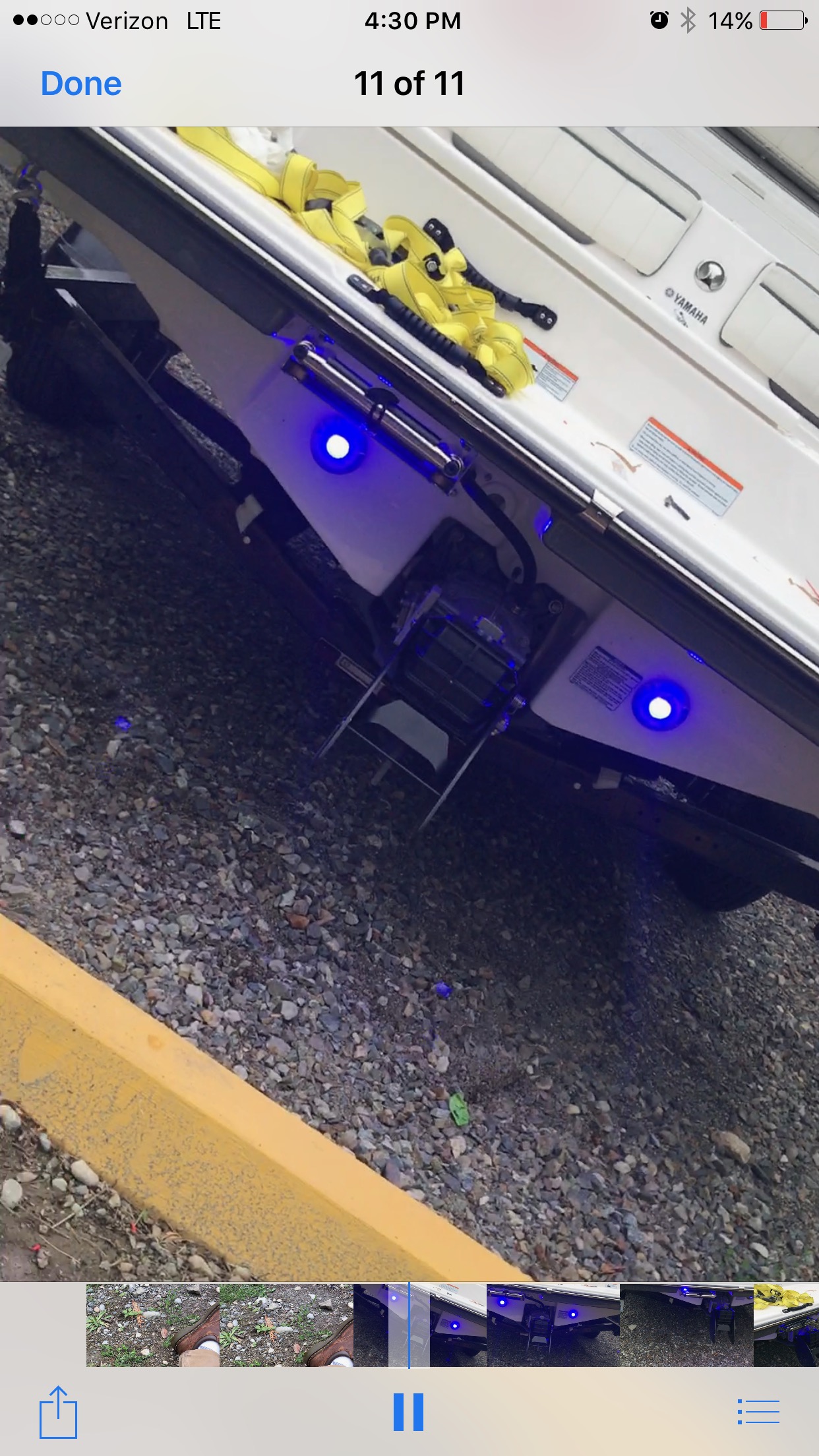

    Installed lights ran power to accessory switch
    Installed them too high and they come out of the water, need to reinstall next summer lower and this time make them level lol
    Installed head and toilet paper holder

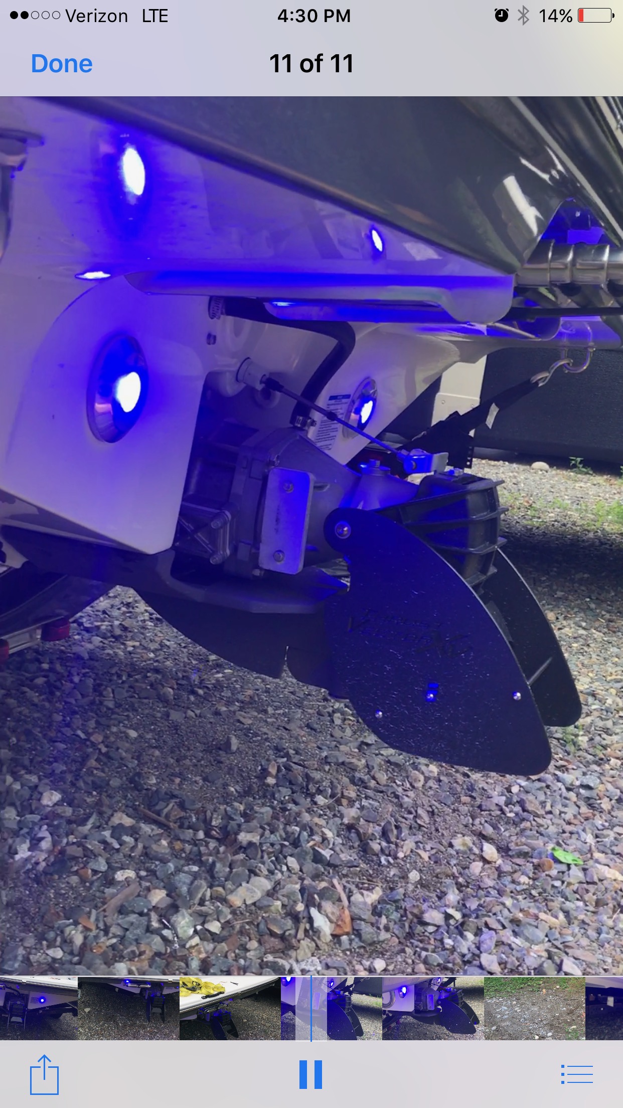

    Installed Thrust Vector to help with low speed steering

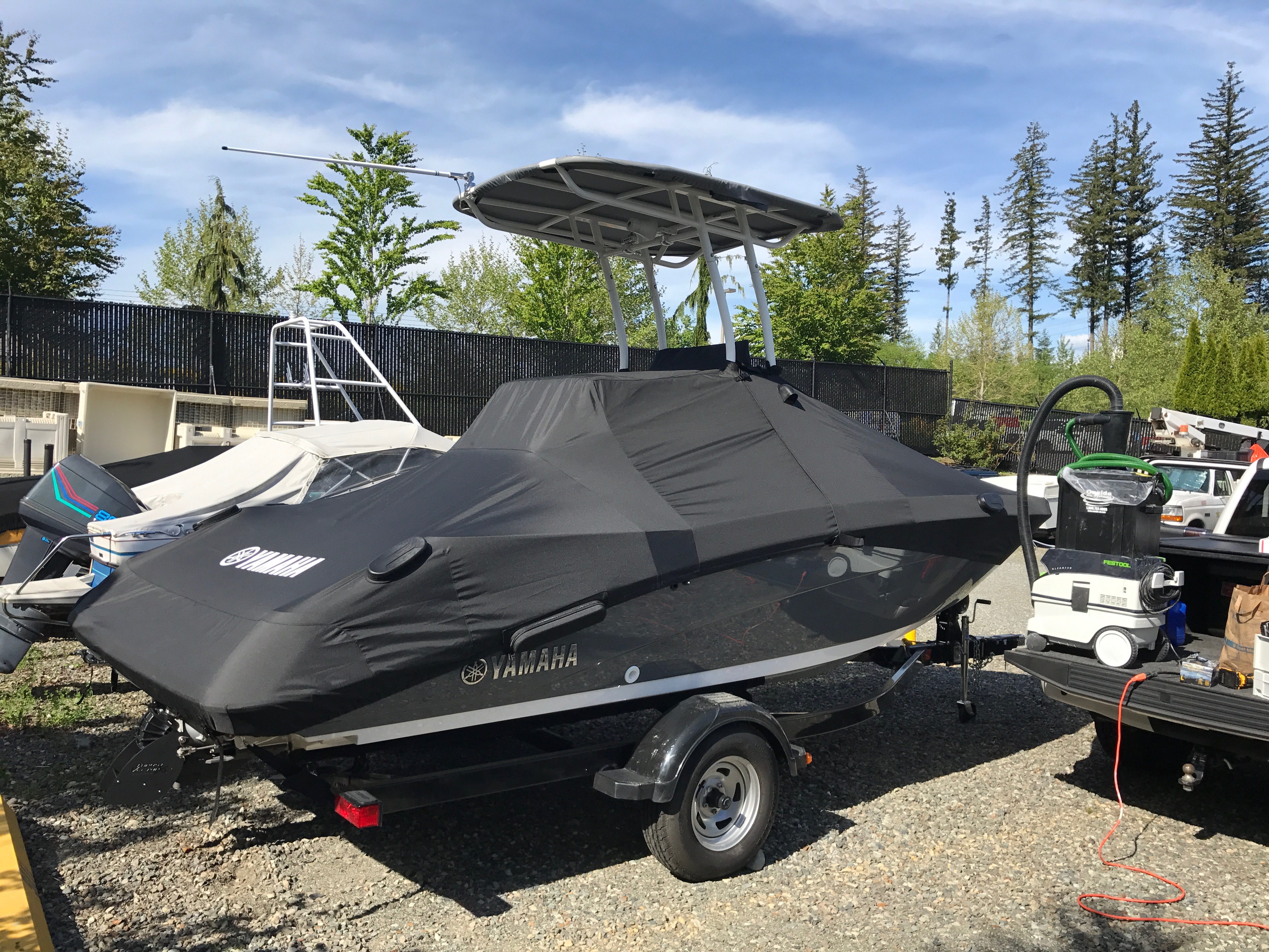

    Bought cover for FSH sport, very nice cover, very impressed

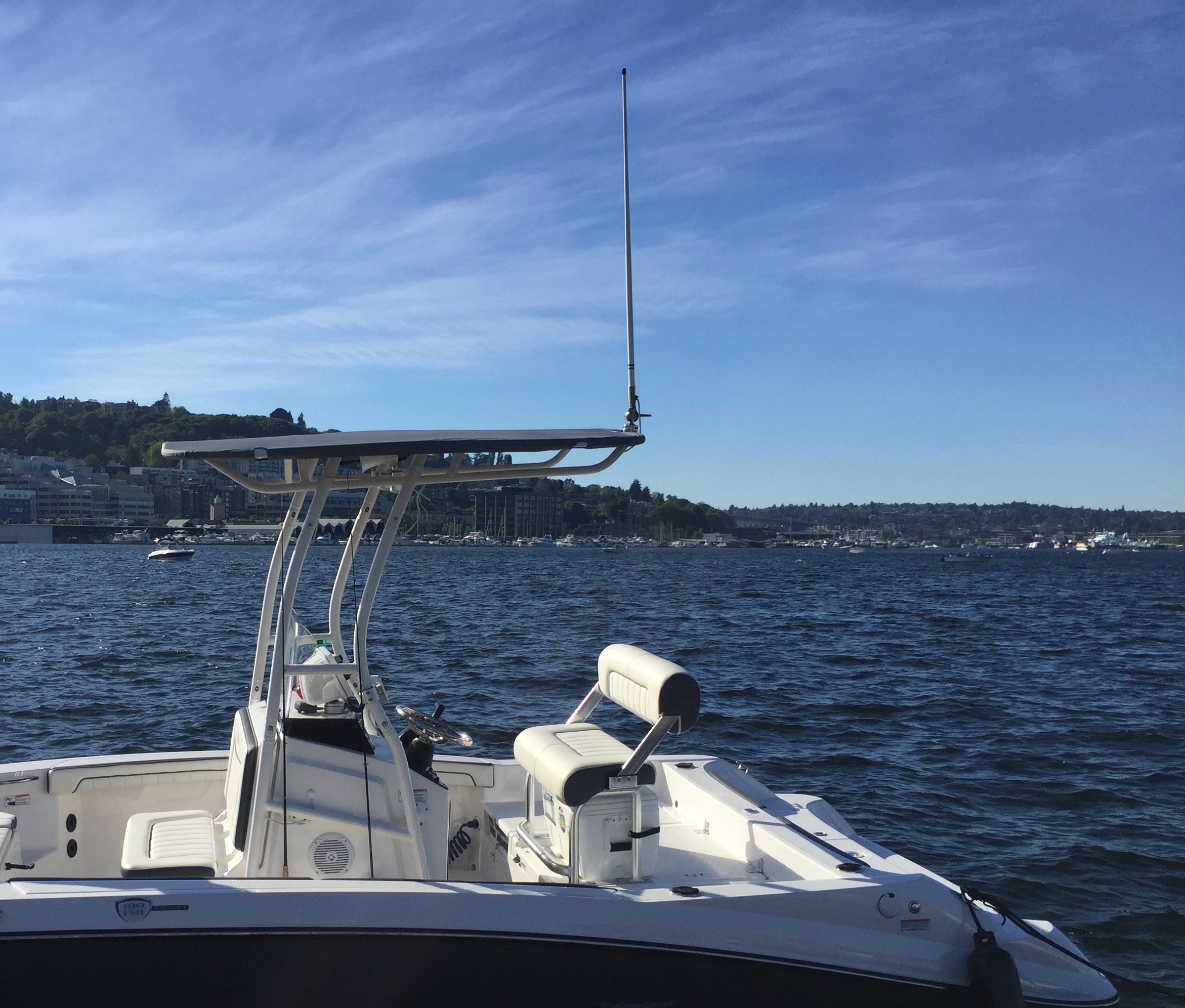

    Installed antenna on t-tops ran wire through tubing
    Anyone have experience with installing autopilot on this type of steering?

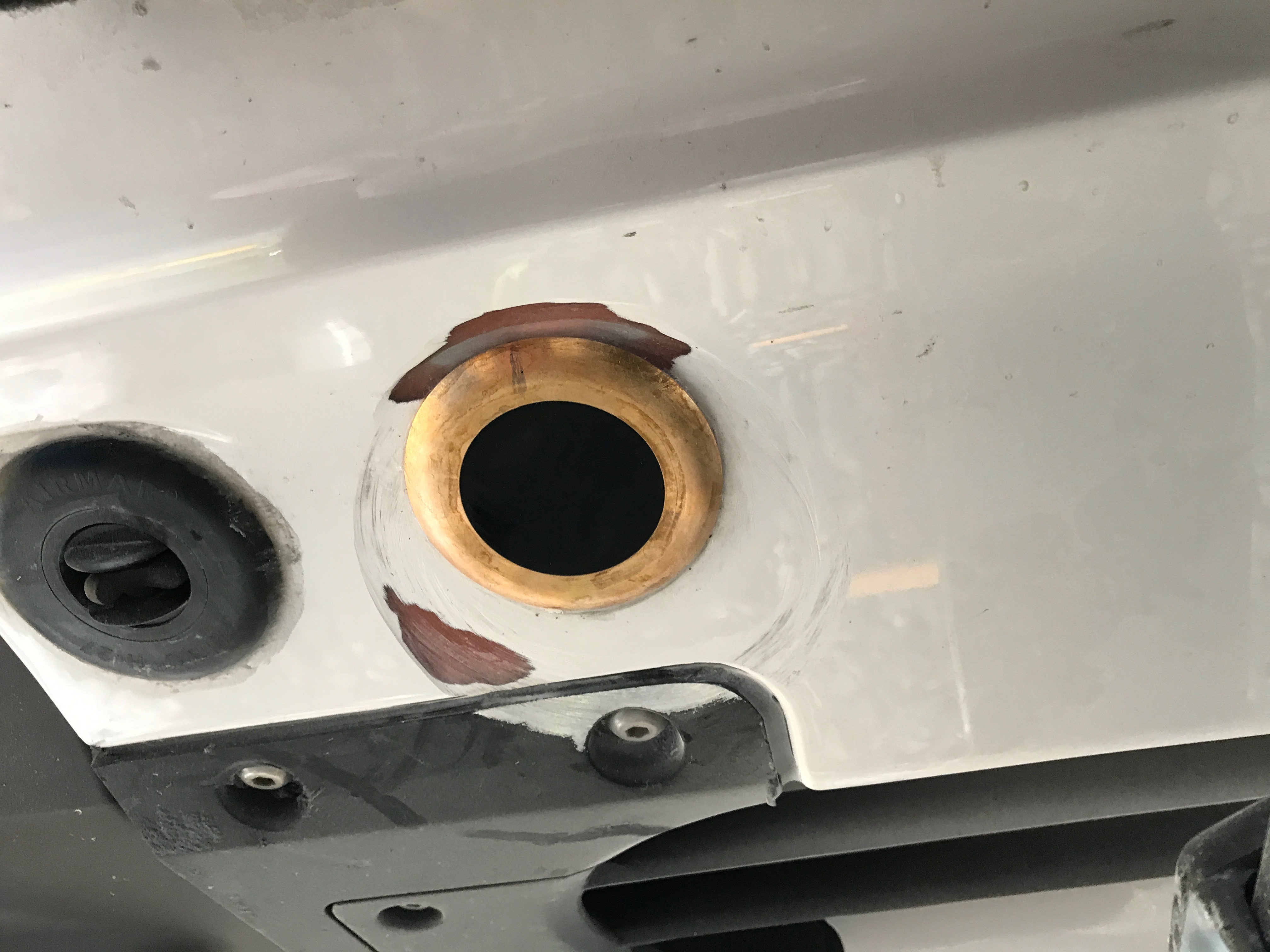

    For running wire through the t-top frame I drilled a hole at the entry point and at every transition. For example the structure of the frame between the green arrows below is solid so you cannot run wife through these sections, but you can exit and re-enter the frame after this section by drilling more holes. I just drilled the holes where most people will not see them and I used fish tape to pull the wire like you do at home when installing cable through walls.
    A note on drilling, I recommend you plug your drain holes on your deck before you do any drilling and thoroughly vacuum the metal shavings after drilling, I let some shavings get in the drain tubes and it is not good at all.

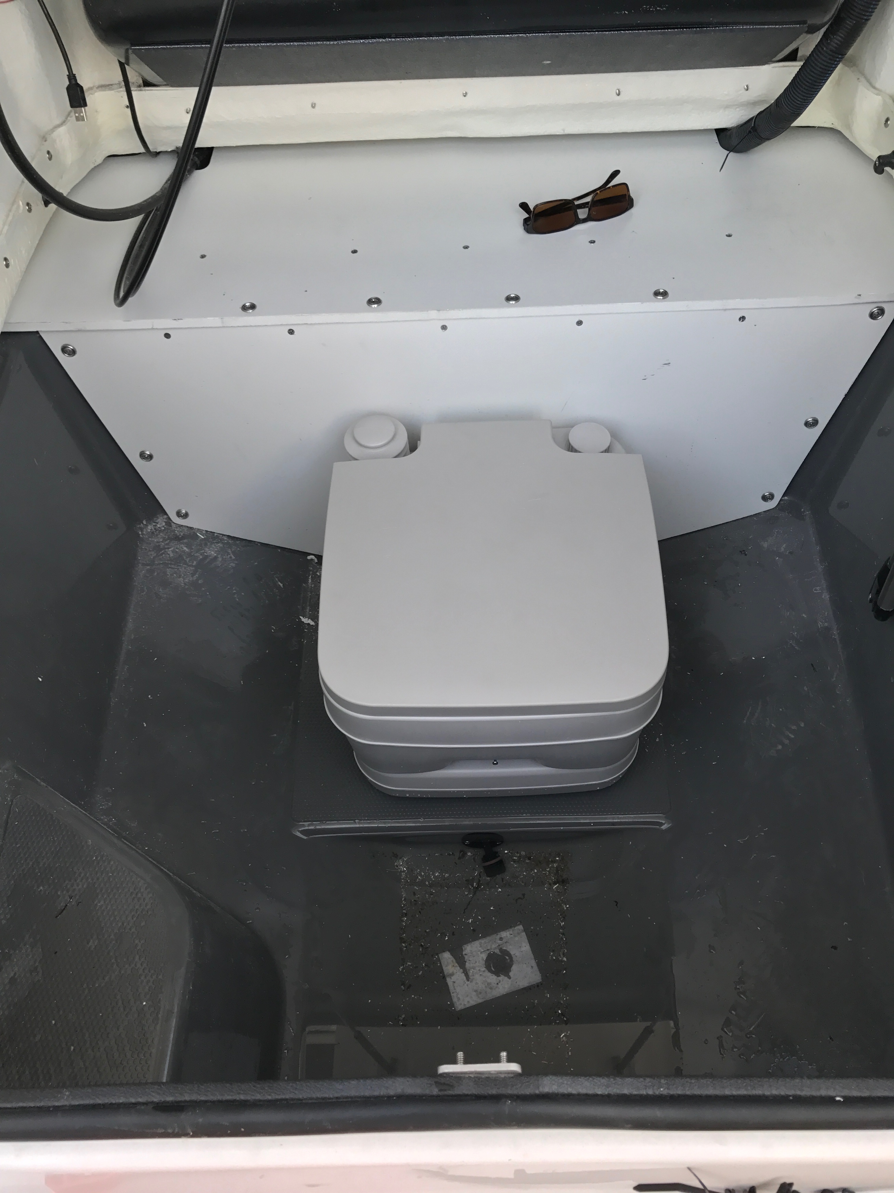

    The seat is easy. It comes with a big metal plate that fits perfectly under the deck that the stand sits in. You just drill the holes and tighten the bolts and you are done. Super easy I used the life seal you see in the picture below on every bolt and screw on the boat. You will see when you order the part.
    The head comes with brackets you screw into the floor and then snap the head into the brackets. Again, very easy once you see the parts in the box.
